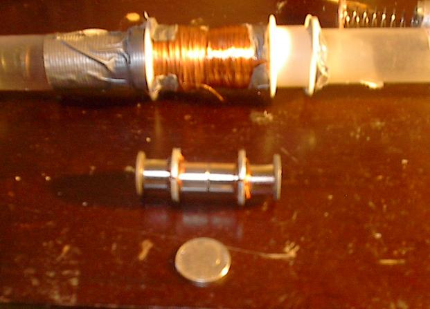

Here, i have built a generator stick, of sorts..a plastic tube with magnet wire wraped around the outside..and four of my 1/2'' dia. x 1/2'' magnets bouncing back and forth on the inside..
this one is something anyone could build..and experiment with
the first pic is the " rotor " above the 5 cent piece..above that is the middle of the shaker tube generator..
i got to thinking one day , that if i could increase the magnetic field that cuts the wire i could improve the output of the generator..so this is what i did..
From left to right , the poles on the magnets of the rotor are North south south north south north north south.. the two larger steel washers in the middle seperate the north north and the south south poles..and , because like poles repel i needed something to stick them to..not sure wether you can see but i have also cut four small slits in the two center washers which i wrapped wire around to keep the magnets centered because even though i filled the center of the washers with steel the little bit that gets out tends to push the magnets off center..

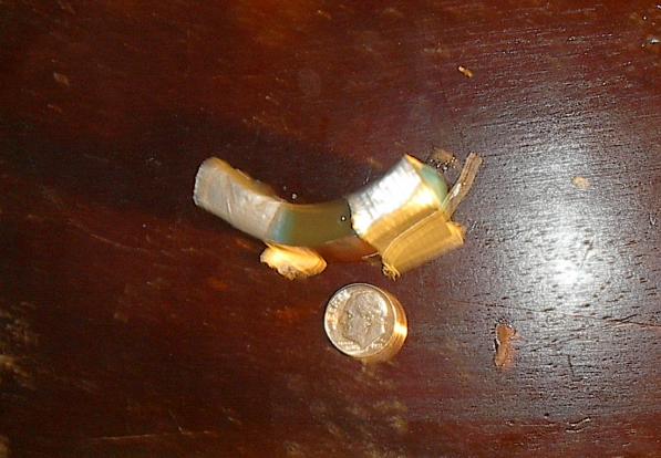

pic two is my new armature fixture for the generator i gave up on .. :roll:
between the duct tape and the play dough is resin curing to the exact shape i need to get it to work..
i took two pieces of copper sheet and bent the one around the inside of the old motor, the other i bent around the rotor from a little ways back..
i have 0.350 '' clearence , so i made the fixture 0.300 thick...

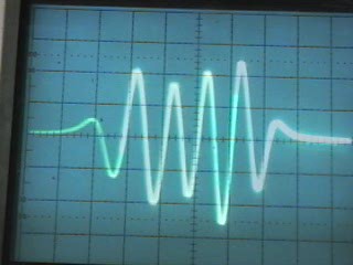

My shaker generator is doing real well.. it gets a very impressive 25 Volts p-p , per pass ..

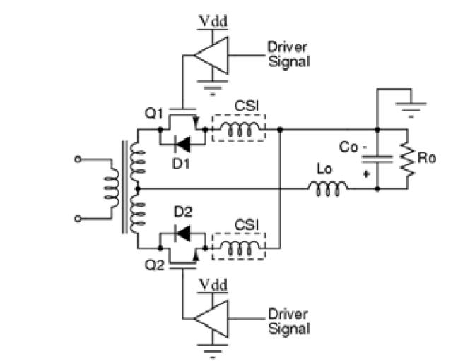

:?: anyway, i have a question???the circuit diagram below is from https://www.electro-tech-online.com/custompdfs/2005/04/syncrecapec2005-1.pdf
the irf website..even though it looks backwards ( the diode direction) i realize that they are FETs.. but i tried it the way it is ( with just diodes ) and it works..so my question is (why or how) could you use FETs in this sync rectifier??what i mean is the waveform looked well NICE!! and there didnt seem to be any way it could be improved by using FETs ..??? i mean there were no dead spots in the wave?? :?:

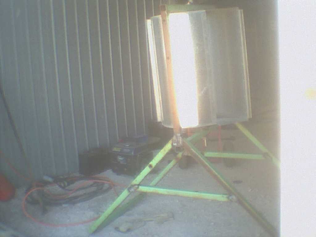

Now for something compleatly different , sort of..
From the cameras point of view in pic one it looks like the nose cone is covering a lot more than it really is..there is about three inches of
airflow around the perimeter..
This wind turbine is made from a bicycle wheel which drives the generator at the bottom ..
The torque this turbine produces is pretty awesome..unlike the propellers it doesnt slow down considerably when under load , of 1.0 ohms..
it only slowed down 20 RPM from an unloaded speed of 150 RPM..
parts required ::
1 )one 16'' bicycle rim (from the back ) with sprocket..
some bicycle chain ..
2) for fins you can use slats from a horizontal window shade ( i did)..
3) a second sprocket ( to drive the generator) of similiar size of a little larger ..
4) two parallel poles ( for mounting the wheel)
5) some cardboard for the shroud and nose cone..
thats all..!! except for a generator of your choice..
let me know if anyone out there tries this ..
lol Pic two makes me laugh.. because it looks , well, so cool..
