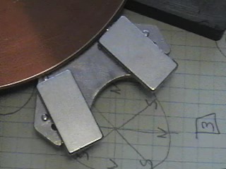

ok after i put just two magnets on a strip of steel..
and passed them over "just one" of the thinner wire armatures ..
i got 2V peak to peak !!!!
that is amazing !!
imagine how much voltage i could get with a magnet on either side of the coil.. like the double rotors of earlier discussion..
that is , an armature set , sandwiched between two rotors with magnets attracting each other..

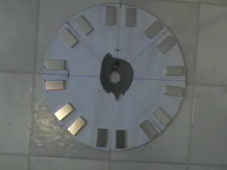

this is my current test fixture..
i need a lathe damnit! lol
the smaller silvery magnets are much more powerful than the larger magnets..
With the eight home depot magnets still in place and the eight new Neodymium magnets i just got 10V p-p :D

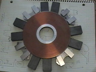

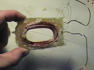

i am pondering the idea of putting some iron core/ laminates in the center each winding , anyone have any thoughts . would it be a good or bad idea ? and why ?
would it be a waste of time or could i get more voltage out of it if i used laminates or would they just interfere with the simplicity of the generator ?

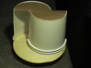

i'm at the point in the design stage where i need more info..
i need to know how much torque the savonios wind generator can produce ..
i am thinking of one the size of a 5 gal bucket..
i need to know if a 3 to 2 gear ratio is to much or if a 1 to 1 is best..
i found a source for sprockets and chains..

i found a 8 inch plywood saw blade at home depot to use for the rotor ( just gotta grind off the teeth..) $6.95
and i found a 2 gal bucket for the savonius part at the dollar store..
another update on the output of the Permenant Magnet Generator project ::
i am now getting 15 V p-p with 7 armatures and 16 mannets spaced as above .. the plan is to use 8 armatures .. Each armature has a resistance of about 0.9 to 1.0 ohms..
the sine wave is sweet , BTW .. the faster it goes the more voltage you get from it..
This is all spinning the rotor by hand , somewhere around 150 RPMs ..

the first pic is the new rotor built on an 8 inch saw blade.. with the https://www.windstuffnow.com/ magnets mounted sort of where they will end up..

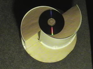

the second pic is the savonius wind generator part with a cd on top for size reference..it is built with a 2 gal bucket
i have another disk like the base to put on top courtesy of home depot , it came from a used spool from the electrical wire section ..

Oh well :( the plywood disks arent cutting it.. too heavy
too much mass to react fast enough to a gust of wind..
i'm thinking 1/8" plexyglass would work much better..
EDIT : just the savonius part turns with the wind from the pc fans i havnt hooked the generator to it yet
i think that i will put the generater underneath after all..

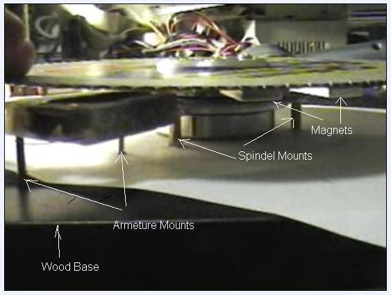

another update ::
I just mounted ONE armature , and when i spin it fast , I get 4 Volts p-p !! .. from one armature !!
that works out to 32 V single phase p-p ..Eight armatures at 4 V each.. i wonder if it will turn out that way..
i have the spindle mounted on a very flat board of mahagany and the armature mounted to the board .. the spacing between the magnets and the armatures is less than 0.010 of an inch , which i believe is critical to get maximum voltage ..
that white paper between the base and everything else is a layout of where to put the armatures..
as you can see i am only using two pieces of threaded rod to mount the armatures that seems for now to be enough..

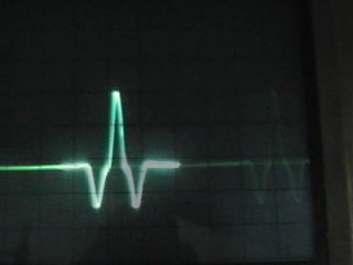

neat waveform huh ?
this is from one armature and two magnets , and a light spin . and 1 V/ Div
its amazing how This turns into a sinusoidal wave with evenly spaced magnets and armatures..
the first negetive going pulse is when the armature encounters the first magnet..
the positive spike is when the armature encounters both magnets ..
the second negetive going pulse is when the second magnet leaves the armature..
when you spin it the other way the waveform is inverted.
