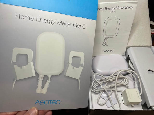

I recently got this - it could be of interest for energy monitoring & saving??
I've not installed it yet as I'm just updating my homeseer setup; the machine it runs on at present is an old desktop type PC, which itself uses more power than needed - I got a dedicated fanless mini PC in the Homeseer black friday sale, it's just arrived in the UK after a month with USPS! On sale, it's hardly more than the PC maker sells the machine alone for, though list price is a bit on the high side...
Aeotec are very helpful, I wanted the 100A 230V single phase version which no one stocks - they sent it to me direct, cheaper than most places sell the standard 60 for!
It's Z-Wave and fully compatible.

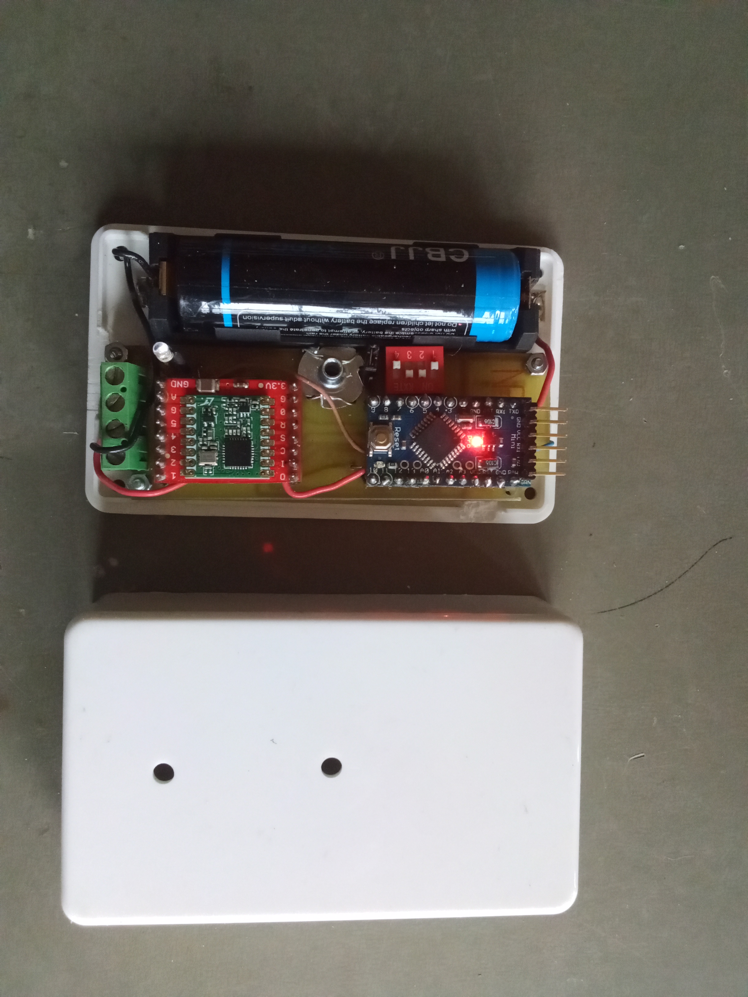

How is the battery life of their wireless remote sensors? So far, on the Ardunio ones I built I can only get about 6-8 weeks using one 18650 rechargeable.
Dump the Arduino - it's a development system, and is useless for low power applications, as there's too much stuff on-board wasting current. By using a PIC, suitable hardware, suitable software, and sleep mode you can drastically reduce power consumption - to years for an 18650.
If you like the Arduino system, then try the Arduino Pro Mini, which is essentially an Arduino compatible Atmel328 on a tiny board - and while it's not as low power as a PIC, it can still be used down to MUCH lower powers than the full Arduino boards.
But whatever processor you use, shut EVERYTHING down entirely (use the processor to switch the power off to everything), and just use the processor in sleep mode, waking periodically to read sensors. Generally I use a 32KHz crystal on TMR1 which runs in sleep, and is incredibly low power, and wakes the PIC up once a second to update an RTCC - use the RTCC routines to check if it's time to do something, once it is, then do it and go back to sleep.
I am using an Arduino pro mini set to sleep all the time and wake only if a change in sensor state is detected. I did not disconnect the onboard LED. Going to try that next.
I do like the pics and have pic stuff but they are kind of expensive to work with unless you are a pro which I am definitely not. I need things mostly already designed and I can make minor changes.
Disconnecting the LED is something you MUST do - as it uses massively more than the processor in sleep. However, you should also use transistors, or FET's to switch all sensors etc. completely off when not in use.
I am using a magnetic sensor that is normally open. When the magnetic field is applied, it is closed grounding the Arduino pin.
Exactly what are you trying to do?, to get decent battery life you need to power up sensors occasionally, take a reading, and then shut it back down. If it's something that needs continuous monitoring, then you can't do that, and you'll struggle getting good battery life.
For example, ESP modules can be put in sleep, and a slight mod (piece of wire) done for it to wake up periodically - but the current consumption is still really much too high, presumably due to the extra components on the module?. My solution is to have a PIC controlling it, by switching the power ON and OFF, and sleeping in between actions.
As a 'rule of thumb' it's usually considered that the average current needs to be less than 100uA, and as far below that as possible.
