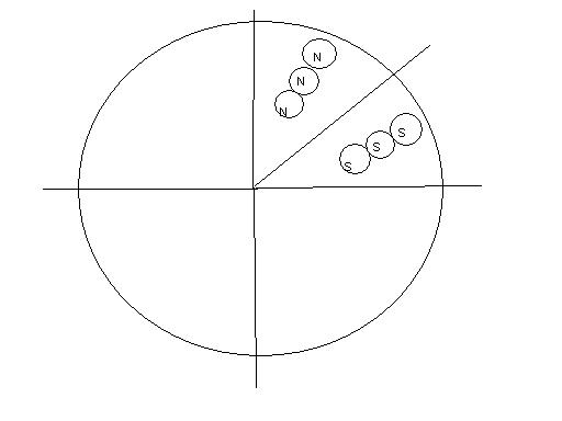

Bryan1 , if you put them like this it would probably work very well..
Hugh Piggots site says to alternate the poles of the magnets like in the picture. the otherpower Site says also to alternate the winding direction...
CCW to CW to CCW..ect... But Hugh Piggot says during testing ... if the winding isnt working properly to just switch the connections on the coil...
