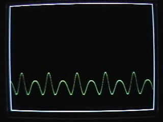

i finally combined my data collection program with the output screen you see here..can you say PC storage scope.!!
the output you see here is from my generator connected through a diode bridge , through a 1 ohm resistor to a light bulb .. so essentially it is a current wave, whose magnitude is proportional to the current through the light bulb..
i havnt scaled it yet , i am thinking of putting all the data on another screen, have not decided yet..anyway it looks cool , i think ..
parts list :
MCP3004 A/D converter w/ SPI serial interface.
my PC I/O board , schematic available here
Pascal programming language
priliminary specs:
60 uSec / conversion
20 uSec calculations
80 uSec total convertion time , thats 12,500 convertions / sec.. lol its an old machine running dos and pascal :roll:
the 3004 is capable of 200,000 convertions/sec

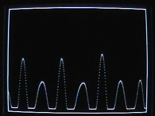

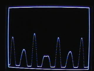

well i have done some experimenting with the generator again..mostly playing around with the PC storage scope .. anyway this is why i made it , because i needed a way to see which armature wasnt as good as the rest, and to find out why..
the first pic shows that the main peaks alternate every two ,thats when two magnets are over one armature at the same time..
That peak in the center of the first pic , has a little dip in it..i should be able to fix that..but i have'nt identified which armature it is yet
The blank spot in the second pic is where i shorted out one armature.. whats interresting about that pic is the peak that is supposed to be to the left of the blank spot , isnt much of a peak, i know which armature that is, its the only one of eight that was wound with thicker wire , ie less turns per same cross section area..and given that my wind generator may never see the speed that the propeller wind generators see , i may have to replace that one ..
needless to say i got the program and the ADC working satisfactorally although if anyone knows Pascal and is familiar with graphics viewports i could use some help with that ..
oh the wind speed indicator is doing well , it has been very windy tonight and it is spinning like .. well ..really fast..
i forgot to mention that , the way i was able to see each individual armature was , i took all the magnets off of the rotor except two..
otherwise all the peaks would all be similiar..

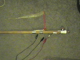

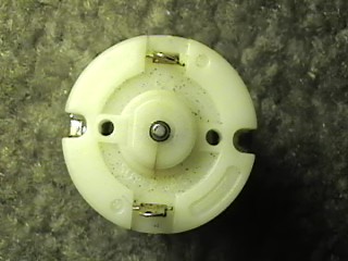

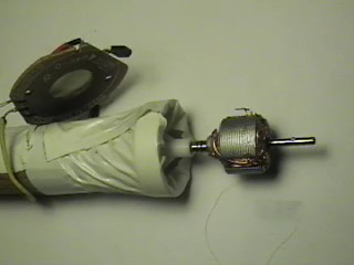

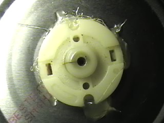

ok ..the first step in making a good wsd (wind speed detector) is the bearing. I started with a cheapo radio shack motor pic3..and attached the armature to a 3/4" dia stick.. then i attached the nylon bearing (pic1) to the can..

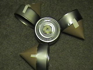

pic3 is the bearing hot glued to the center of the can..

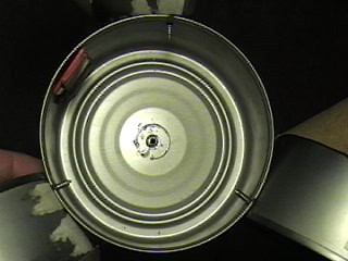

then i attached three tuna cans to the center can with small sheet metal screws as in pic2..
in pic1 i attached a cone to the back of each can..
pic2 also shows the center hole inside the can..and three HDD magnets for balance and to trip the hall effect sensor..

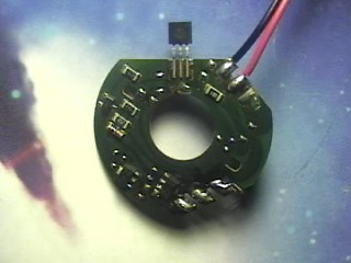

Pic1 is the hall effect switch which i got from a PC power supply fan..
thats it at the top, with the three prongs comming out of it ..
the three solder connections at the bottom right of pic1 , are where the fan windings connect to the circuit board..this is the output of the circuit..The middle one has a normally high output and goes low when a magnet passes close enough to it..
If you connect the red wire to 5V , the black wire to ground ,the output is 0 to 5 V ..

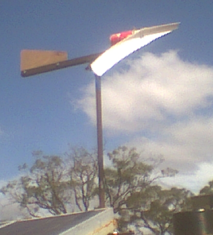

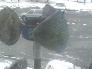

instead of a tuna can anemometer i have made a tuna head anemometer .. taking the shape from the very hydrodynamic tuna ..
it works very well.. it even has ball bearings so the slightest whisper of a breeze starts it moving..
Next i have to figure how to count the JUST the tranitions of the hall effect switch..as it is now i am able to count the number of times it is IN transition.. i am sure it is just an if then statement

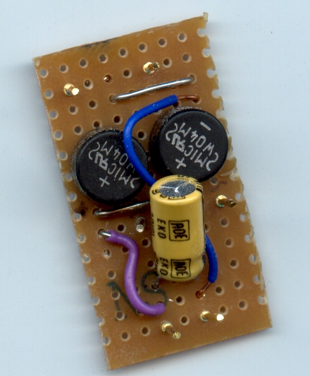

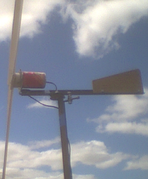

Well I finally got round to making a wind genny, my saviounis version needs a total rethink to the design but the one pictured looks promising. I used a bipolar stepper motor rated @ 5 volts and draws 1amp. Well the initial tests show a voltage of 12.6 volts with a current of about 250 milliamps using a 5watt 1 ohm resistor as the load. Now thats when the prop is doing approx 50 rpm. Murphy's law states when you make a wind genny you wont get any decent wind. Good ol' murphy woz right again :oops:
Anyway the last pic is of the retifying circuit using 2 wo4 bridges and a 47uf cap, I shrunk some heatshrink over the board once it was wired up and shoved the lot in the back of the soupcan which is sealed using silastic. The prop was made from some scrap water pipe and I need to take it off and balance it.
Cheers Bryan1 :D

nice !!
i was thinking about the Fisher/Paykil site .. He used the same magnets that came with the machine ? ..i suppose that if he had used some of the new Neodium (sp) magnets , he could get more power out of it..
50 RPMs is plenty to work with , with some more work on the prop i bet you could get it to 200 RPMs !!
