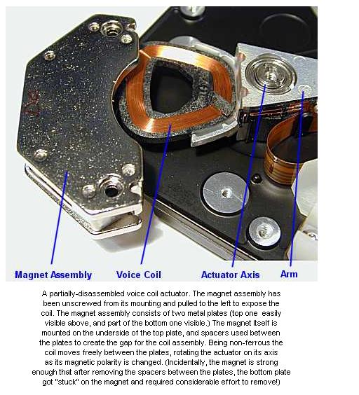

this 5- 1/4 drive has lots of neat parts inside
its got
a mechanical actuator which when power is off it applies a Brake to the plattens..
also cylindrical , a platten speed indicator..
a linear mechanical slide with a little over 1 inch of travel ..
and like Foxy said it has a 400 steps/rev stepper moror driving the mechanical slide..
but alas no magnets.. :(
oh it also has a platten drive motor which could be used as a mounting mechinism for our Permenent Magnet Generator..
Yes, old drives can yield some good mechanics. I've a collection of spindle motors and linear rails from them, most make good, light-use bearings for other things, some (especially older motors) have too much cogging. A shame they are generally tricky to drive, not having sense outputs. Also, they don't give a useful output as a generator unless spun at silly speeds!
Some of the spindle motors have the spinning centre exposed at both sides, with the physical mounting points on a fixed outer edge. These would be good for smaller PM generator-type uses, allowing the magnet/coil assembly to be on one side and allowing easy machanical coupling to the driving mechanism on the other side.

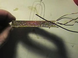

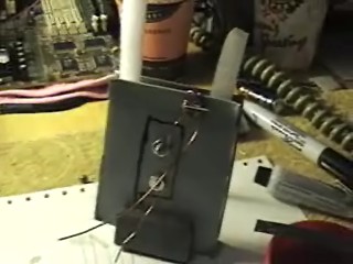

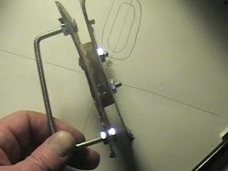

I decided to make a fixture for the Armatures. This will keep them the same thickness. I plan to pour Resin around them , so when they are done i can move them around individually till i like where they are , then i can fasten them properly..

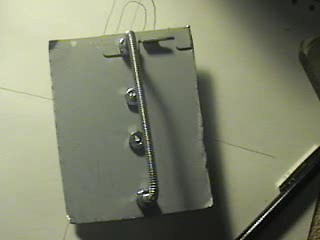

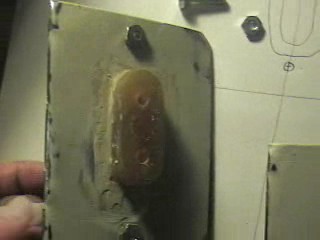

i started with plaster around the shape of my magnet. took out the magnet , poured resin into the hole where the magnet was and what i got was picture 3 , after some sanding and fileing .. i tapered the fixture so it would come off when it was done..
I started with two squares of heavy sheet metal ( from an old computer case ).. cut it with a pair of sheers.. filed and bent the edges away from the inside.. then i bent some 10-24 threaded rod for the handle ..
so now the armatures will all come out the same thickness..
Picture 3 shows the molded resin which i'm going to wrap the wire around.. i had two tapered screws all set to use on the inside to attach the handle to but then i got the idea to use the threaded rod , so now i am hoping that the nuts dont interfere with winding ..

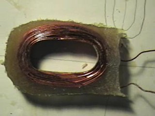

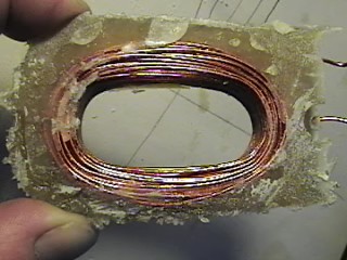

this is a bad picture , but I wound the first armature and poured the resin in .. it will be done in the morning..
i have 80 turns of 20 gague wire on there
the first pic is the face of the armature
in the second pic , Arm4 , is the side shot , as you can see , it worked !!

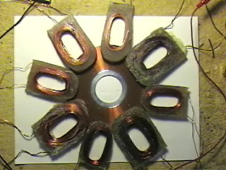

after some initial testing i seem to be getting 2 V peak to peak sine wave from four coils and eight magnets..
it is a real nice looking sine wave :lol:

i repositioned the magnets , and now i am getting 4V peak to peak from eight coils and eight magnets..

also if i could place the magnets closer to the coils i would get more voltage out of the generator..
as it is now , i spin the magnets and place them over the coils

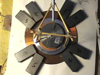

i used a 5 1/4 hard drive bearings to hold the magnets in place , i hot glued them to one platten..
i also hot glued the coils to the other platten..
works quite well for testing..
before reading this site i had the magnets evenly spaced around the platten.

ok preliminary results are..
depending on which meter i use for current i am getting anywhere from 50 to 100 mA short circuit current @ 1.2 V by just spinning the works by hand..
i am using those glass diodes because of their lower forward voltage requirements.. in a bridge rectifier set up..with a 220uF cap across the output..
i also took apart two old western digital Hard Drives 170 MB , they each had four elbow shaped "sort of" Neodymium magnets so i connected them to the previous picture..
does it seem right that with 6V peak to peak pre rectified volts..
that i am only getting about 3.3V no load rectified volts ??
