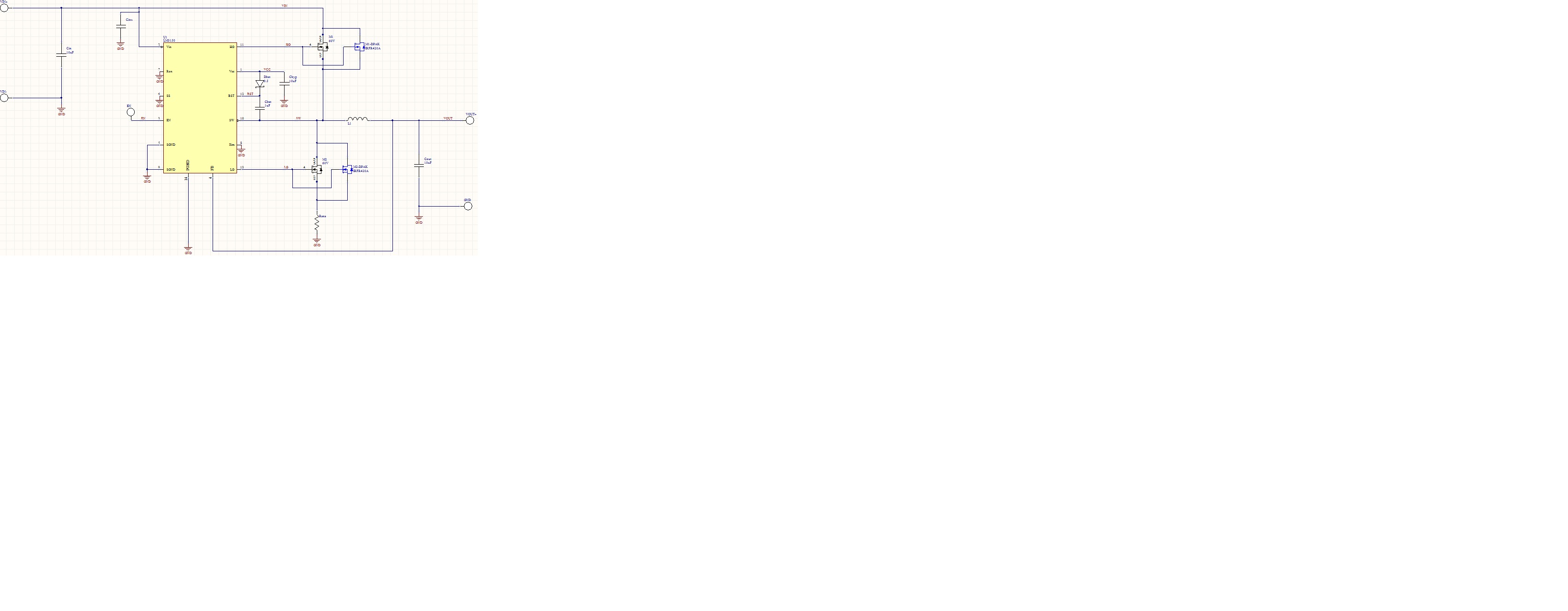

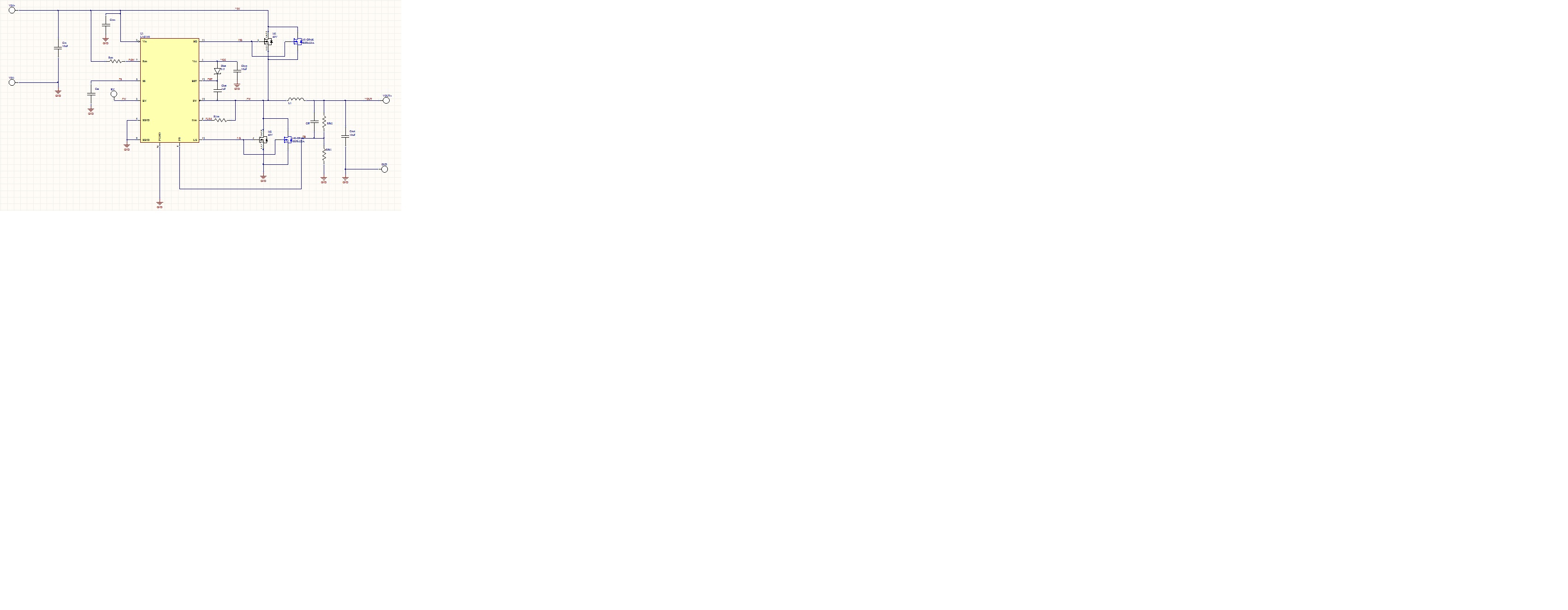

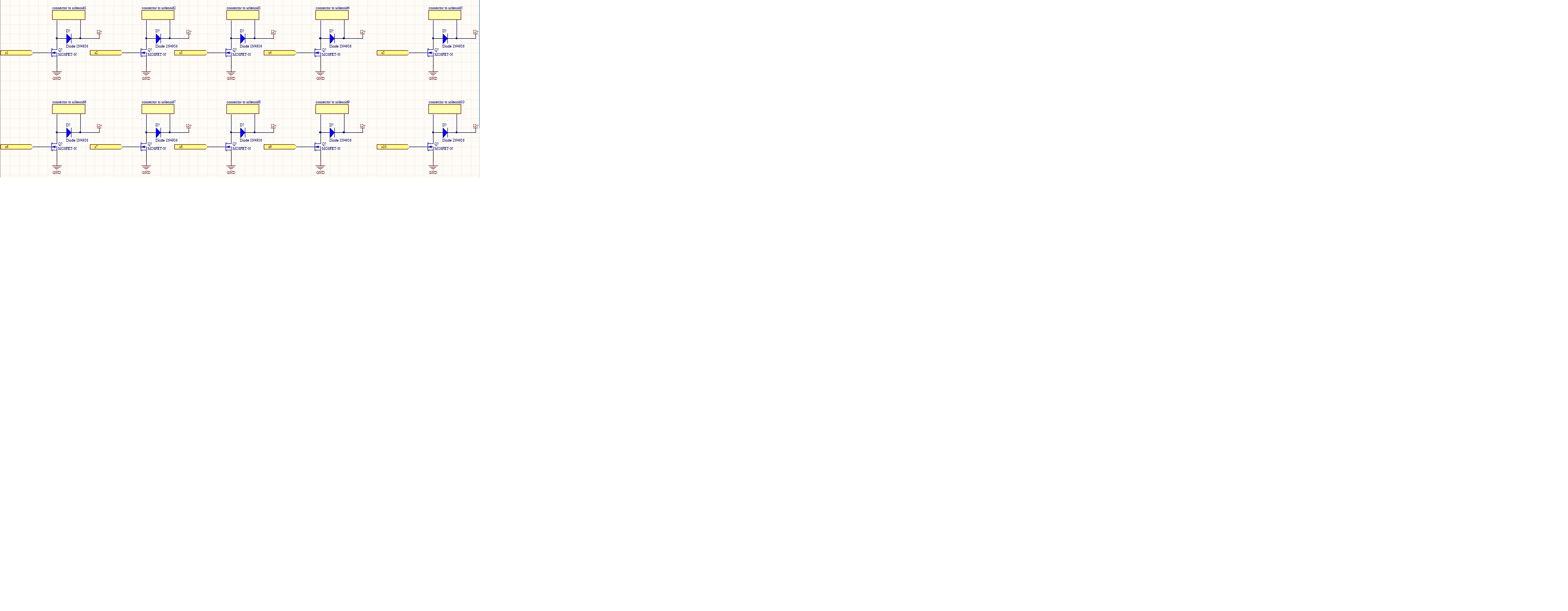

can someone check if im on the right track thanks. one is named 33v but its 3.3v. i'll be using a 12volt 8amp power supply and 12 volt 350mAmp solenoid valve
Your schematics are very difficult to read... blurred details.
To what are you referring?
Ken
