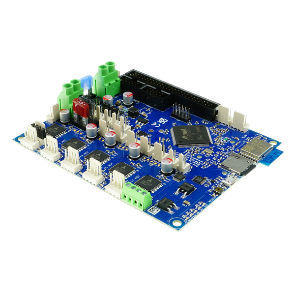

I want to replace the 8 bit controller of a 3d printer to 32 bit controller .I need suggestions which is the best controller for 3d printer(32bit) and how to configure a new one .
I also heard that 32 bit controller increases the printing speed ?Is that true.AS i am not myself used any 3d printer.

I wouldn't have thought it increases printing speed?, as it's limited by the physics of the printing process, not the speed of the processor. I would have thought the biggest increase would be in the display updating speed - but that really makes very little difference.
As for which 32 bit processor is best?, one that has suitable software and hardware already available for it.
As Nigel says, a 32 bit controller will not in itself improve the printer function in any way.
The actual processing requirements for 3D printing are minimal.
eg. A CNC machine tool controller we designed in the early 1980s that ran on a 4MHz CPU worked to orders of magnitude higher precision and speed than a current 3D printer needs. It's internal precision was better than a tenth of a micron.
More CPU power may be needed for such as a built-in graphics touchscreen and other gimmicks which are really better off in a separate device - the printers job is to print!
Your priorities should be:
Compatibility with whatever physical requirement the printer mechanics - eg. linear slides, delta mechanics or whatever, and the total number of motor drivers needed and supported - if you may want to go to such as colour-blending extruders you need lots of motor outputs, that not many boards have!
Then, the controller out of those that has the best firmware and software support. Some types have rather buggy or closed firmware while others are really excellent.
Repetier, Marlin and Reprap are all reputedly good.
Of the 32 but setups available, the Duet 2 looks to be one of the best options. That supports Reprap firmware, and many motor drivers.
Also the Smoothieboard, but only five motor drivers.
This not a 32 bit one, but with lots of outputs and interconnectivity, plus multi-firmware compatibility:

Thanks for such informative reply .Now i am getting the idea thanks.So at the end you means that we would get no advantage if we replace the old aurdino(Mega) and Ramps setup with the new 32 bit controller.And there would be no effect on printing in terms of quality and speed.I was just wondering how to get speed but maintaing the quality of printing.
Almost any processor will be faster than the hardware. Stick with what you have unless there is a very good reason to change.
OK Thanks for replies so there is no method to decrease the long hours of printing.How could i decrease the printing hours for example 6 hours to 3 or 4 hours?
A higher powered, faster extruder and faster, more precise mechanics.
