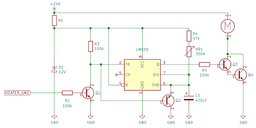

I've got a 3D printer, specifically a Wanhao i3+. One thing that's always annoyed me about it is that it has a cooling fan on the hotend that is always on when the machine is powered up, regardless of whether it is actively printing. I want to turn the fan off when the heater is not switched on, but keep the fan on for a minute or two after the heater switches off. The fan output is not hooked to any software controllable output, so I can't do it with code. Instead I've resorted to an old school method of using a 555 as a retriggerable monostable:
The printer runs off 24V which obviously a 555 won't like, so I've used a zener to get me a 12V rail. The heater I'm using as the input trigger is held at 24V when off, and grounded when on. Q1 is used to pull the 12V input trigger to ground when the heater is grounded. Q2 is to retrigger the 555. R4/VR1/C1 are the RC circuit obviously. Q3/Q4 are to actually switch the fan motor. I should maybe be using a MOSFET here(?), but I currently don't have any to hand that aren't physically massive.
So, I was hoping some of you who actually know what you're doing could take a quick look and point out any dumb things I'm doing, or suggest improvements/simplifications? I've built it on breadboard and it all seems to behave as I expect, for what it's worth.
Thanks in advance!

Add a catching diode across the motor to protect the output transistors.
Is Heater_Gnd a +ve-going pulse from a source which can pull Q1 base low afterwards?
Thanks! Diode across the motor is a good point. The heater ground goes from 24V to ground when the heater switches on. It's not a pulse, it's the current path for the heater itself, which is just a bit of a wire in a can I guess (it's 15 Ohms). In other words, when the printer is idle the heater ground sits at 24V and when it switches on (and I want the fan to switch on), the heater ground goes to ground.
With the present setup, if Heater_gnd is normally at 24V then Q1 is normally switched on, clamping the 555 Tr pin low. Pin 3 of the 555 will thus be kept high, so the motor will be on. The opposite of what you want.
Q2 seems redundant.
You have that opposite.
Q1 will pull the 12V to ground when the heater is at 24V.

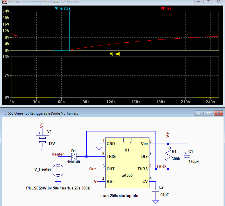

Below is a simplification of the circuit (no transistors needed, just a diode) that I think does what you want.
It turns the fan on when the heater voltage goes low, and keeps it on for the 555 time-out period after the heater voltage goes back high.

You are of course both right. I had my scope on the wrong pin and clearly hadn't thought through what was going on, inadvertently inverting my logic. Q1 should be in an emitter-follower configuration.
I hadn't even considered using a diode here. However does that not mean that at power on (when the heater is off), pin 2 will be low until the capacitor charges, causing the fan to turn on once until it times out? Is your simulation assuming the capacitor is charged at t=0? Am I missing something?
Q2 seems redundant.
The point of Q2 was to provide a binary input to the trigger, rather than the threshold voltage directly. I tried taking it out of my circuit, instead wiring pin 6 directly to pin 2, but it doesn't seem to work that way. The fan just goes on and off with the heater input. But like I said before, all this analog stuff is a bit alien to me; perhaps I'm not understanding why I should expect that to work?
Yes, the capacitor (THRS voltage, blue trace) is charged from the previous turn-on, turn-off cycle.
When the capacitor voltage is high, the output is low.
The means the circuit will give a two minute fan operation when the 555 power is first applied, the same as your circuit would.
I assume that's not a problem(?).
If it is, then the circuit can be modified for that, but will required some added circuitry.

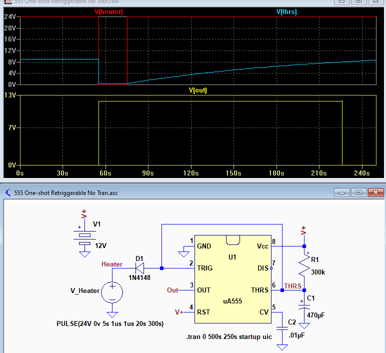

Edit: After some thought, here's a simple modification so that the 555 doesn't generate a pulse at power on.
Connecting C1 to the +12V instead of ground means the THRS capacitor voltage goes high and the 555 output is low at power up.
Perfect! That does just what I want. And such a simple modification. Thanks again.
