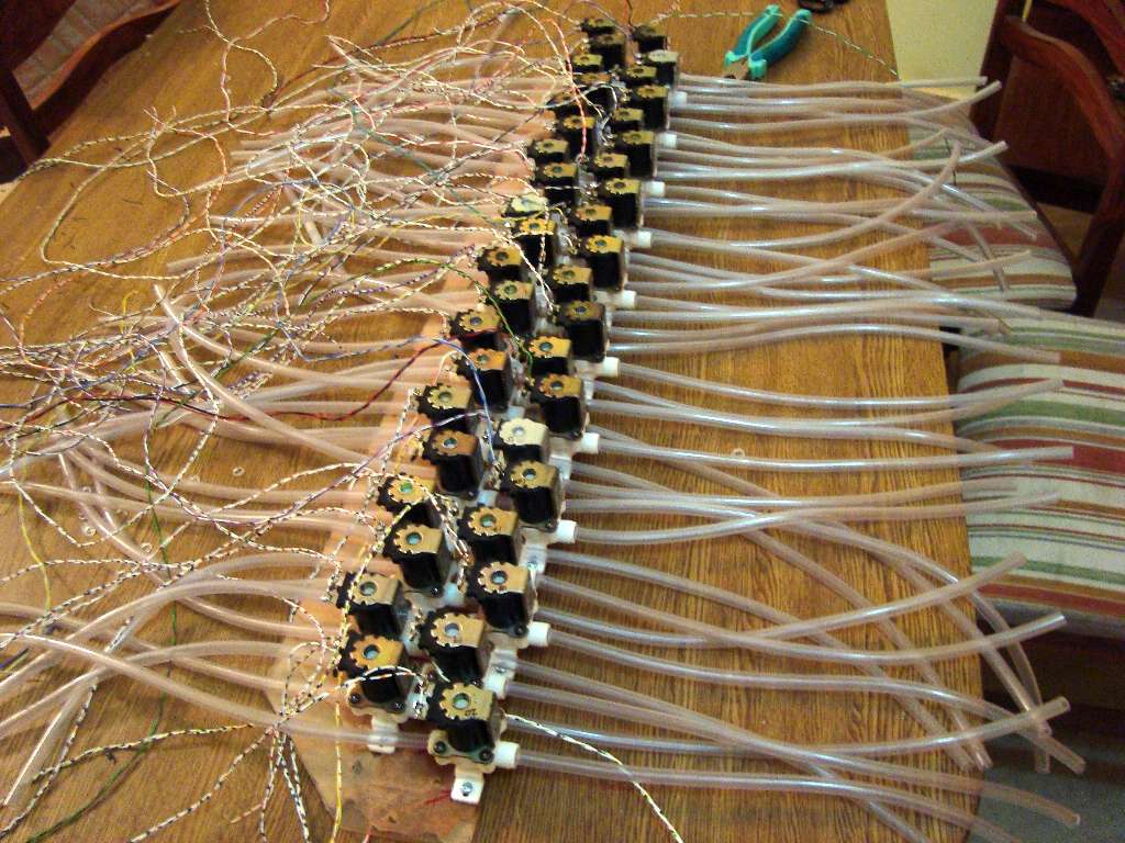

Sounds like you are suffering (or rather your circuit) from some lag in the fets turning off fast, and perhaps should have had a driver on each fet.
I dont recall if the IRF540 is a frequency fet as some dont like high speed switching and am guessing this is the case here.
I am no expert on fets and have run into many problems with them myself, one thing i have learnt is the right fet for the job makes a world of difference and the manner they are driven with is important too.
At high speed do the fets run hot at all?
Pete.
Hi Pete,
Your first sentence is totally Alien to me;)...Did not understand...
The FET is very Cool through out the process... The lag was due to the Diode not by the FET,... If you are involve in CNC machining most of the controller uses Power MOSFETS, they do switching at very high speed...

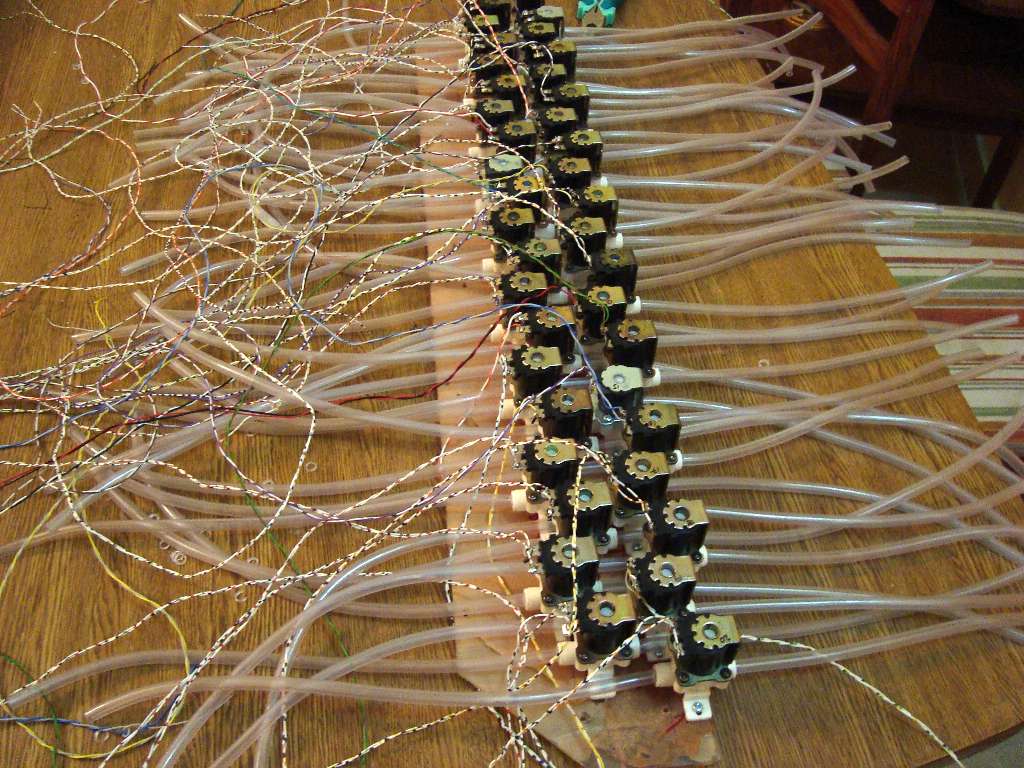

Here is the tubing and wiring of solenoids..

The diode allows the inductor current to hold the solenoid open for a short period of time as the magnetic field collapses which is the delay you're experiencing. You need a push/pull FET arrangement to avoid this. Without the protection diode that inductor current IS definitely going somewhere, and that's an avalanche over voltage event for the FET. This doesn't mean it's necessarily bad, but you better have chosen (by luck in this case) a solid FET that is avalanche rated for the reverse pulse's it's getting or you'll fry every one of those suckers the first time you try to use it for any length of time.
https://www.electro-tech-online.com/custompdfs/2011/05/AN-9034.pdf
Might provide some greater insight.

The users current solenoids will probably work, they just need push pull drivers.. The perceived slowness in the solenoid reaction is because it's a single drive transistor per solenoid so when it switches off and the freewheel diode conducts the solenoid is held open by the collapsing magnetic field from the inductance in the solenoid coil... A push/pull driver will allow that current to be dumped into ground, or better yet a negative rail slamming the solenoid shut, I'd actually be worried about the physical construction of the solenoids at that point as the stresses will be quiet high.

Sceadwian is ontime with the push-pull driver. A touch of neg voltage to SNAP the solenoid off would speed up the shut off time. Letting the coil charge drift to ground will give you a much slower shut-off/.
