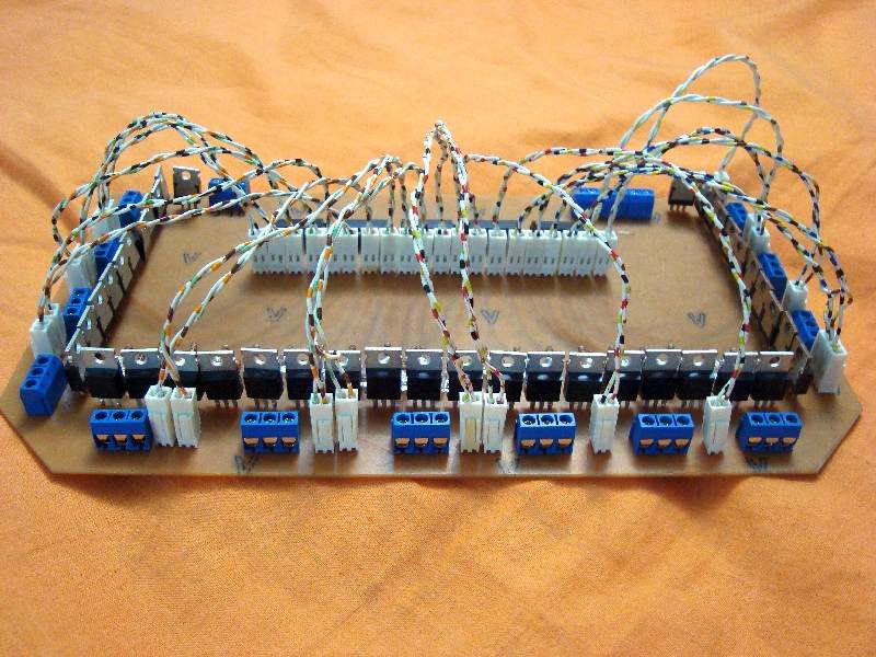

On the matter of the solenoid drives , the ULN darlington series is barely adequate to drive the 500mA loads. Some heatsinking and fans will be required to make those work. I figure it's better to use some dual logic nfets like the fairchild FDC 64XX series. Just use a flywheel diode.
I'd think you would want to switch the solenoids (or whatever) using mosfets...

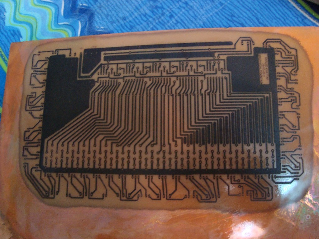

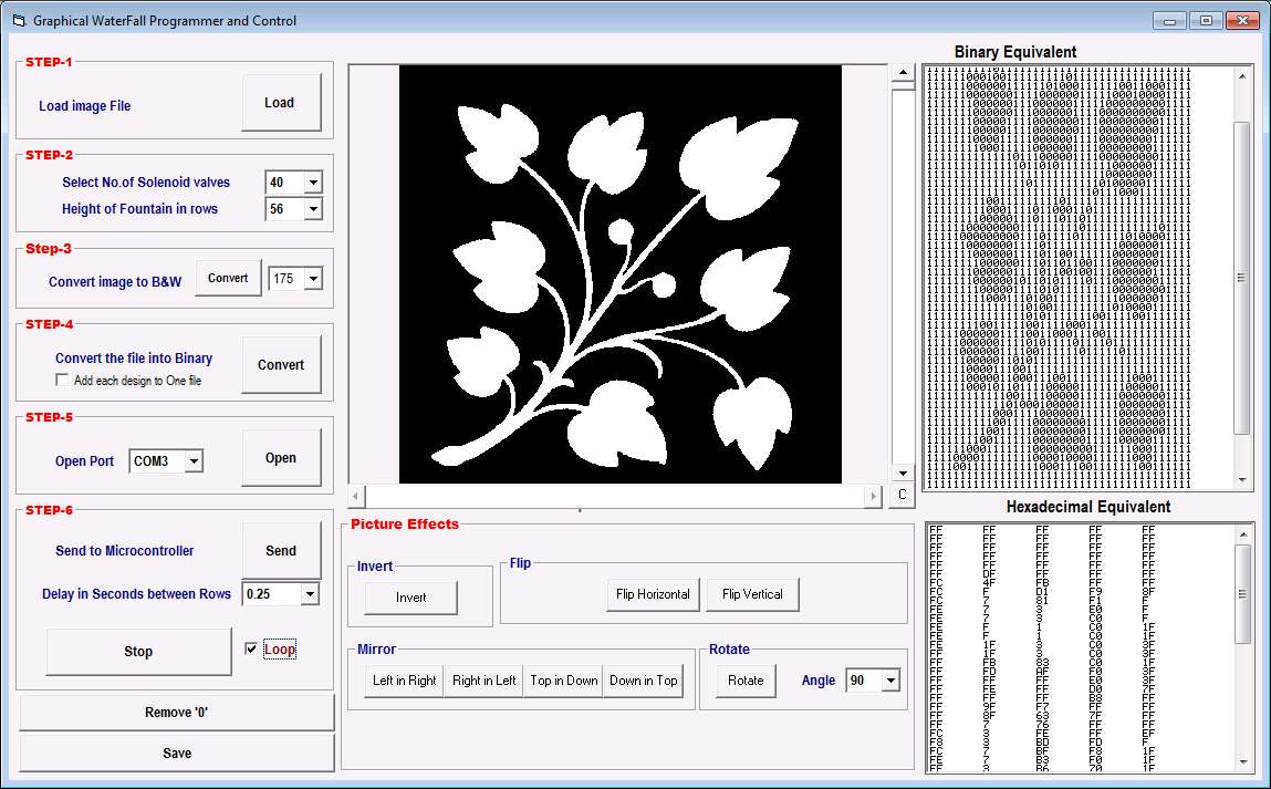

Interesting discussion...I have almost completed the graphical waterfall project.. you can check the testing videos and detail of the project in my following blog:
My Woodwork
i will also post the details if required.

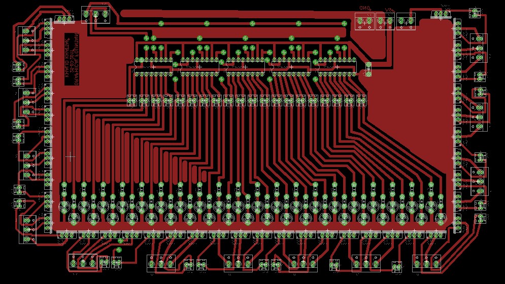

About two months ago i saw a video on youtube 'Japanese Waterfall' and was amazed to see stunning water graphical effects... I flabbergasted just like you all... I decided to work on it and meditated what the Japanese did on this fountain.... I have found no information what is working behind... I came to know that:
1- I need a Graphical design software that can produce bits from pixels i.e. graphical images to binary images
2- A Microcontroller that can get the coomands from the computer and send to 100's of solenoid valves to create those stunning effects.
3- Mechanical hardware i.e. pump,pipes, sump, water Header etc
4- A simulator 40 LEDs mimcking 40 solenoid valves.
5- Brain to do all above, frankly, that is scarce here ;)

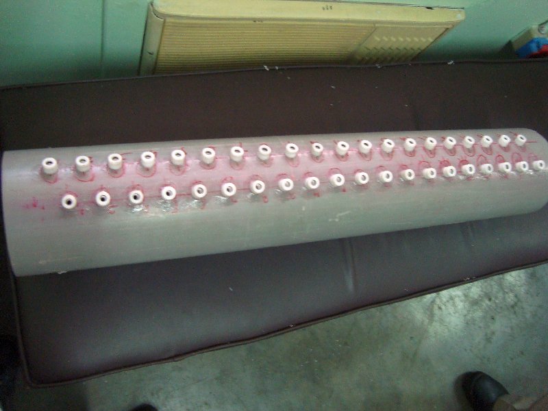

Almost all work is completed and today i am installing the header and solenoids on the wall of my drawing room
I came across many challenges i.e. solenoid valves response timing, water drop shapes etc...and still experimenting to increase the solenoids response by injecting high current for a short time period;)
I am a Mechanical Engineer and nothing to do with electronics and programming.

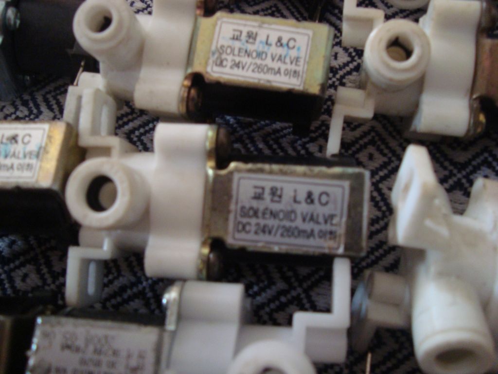

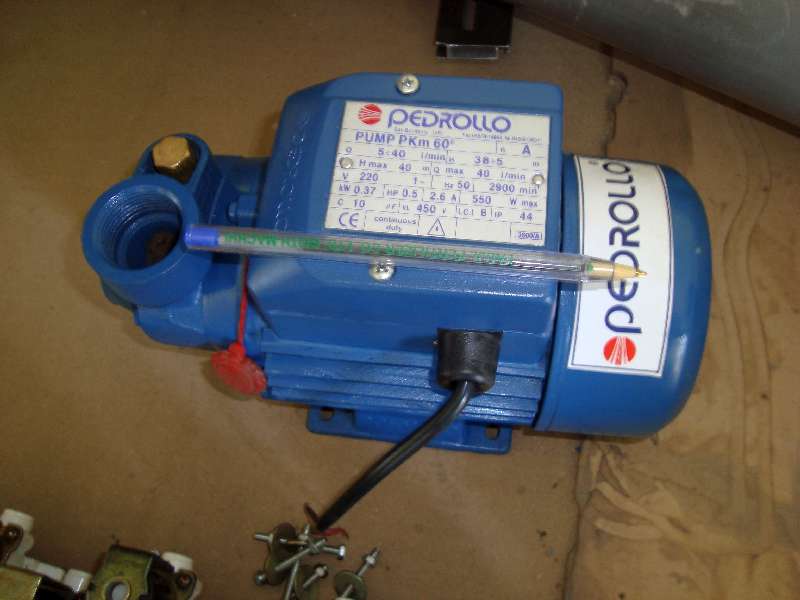

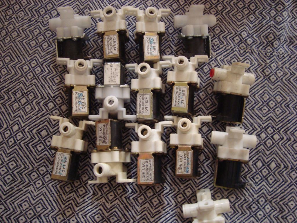

Hi Kagan these are 24VDC 260mAmp solenoid valves i purchased from scrap yard for 0.60US dollar each.
Regards
Khalid

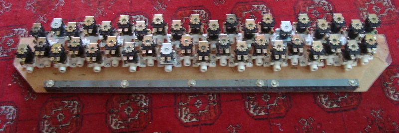

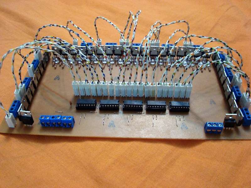

At last i completed the wiring of Solenoids and made an RC circuit. The resistance is 47RJ 5Watt and the capacitors i used are 50V 100mFarad.
Still long way to go, installation of tubing etc.
and sump from galvanized sheets and is tested water proof
I dont see any reverse diodes across your drivers to the solenoids and high switching frequencys of the coils will generate some huge emf that could blow your drivers up, pitty to see all that nice work go up in smoke for the lack of a few diodes.
You could solder the diodes to the bottom of the board across the driver pins.
Wish you good luck with the project and look forward to seeing a utube video of the working result.
Pete.
Pete.
Hi Pete,
I had soldered IN4007 across the Solenoid directly and not on the board.. But, after testing a single solenoid without diode for hours my 74HC595 and micro-controller survived...The Question is why i tested and took the risk without using Protection Diode?
Actually installing Diode across the Solenoid cause a time lag in closing of the solenoid and i was not getting the good response time from the Solenoid... Do you believe i removed all the diodes from 40 solenoid valves yesterday (based on the experimentation)...
If in case i have failed IRF540, i would not damage the complete board and the micro-controller. Only i have to replace all IRF540 with IRF840...
In the coming weekend i will be able to post a video of working fountain..I don't know whether the results will beyond my expectations but i think i would have a good waterfall in my Room irrespective the display is graphical or not.
