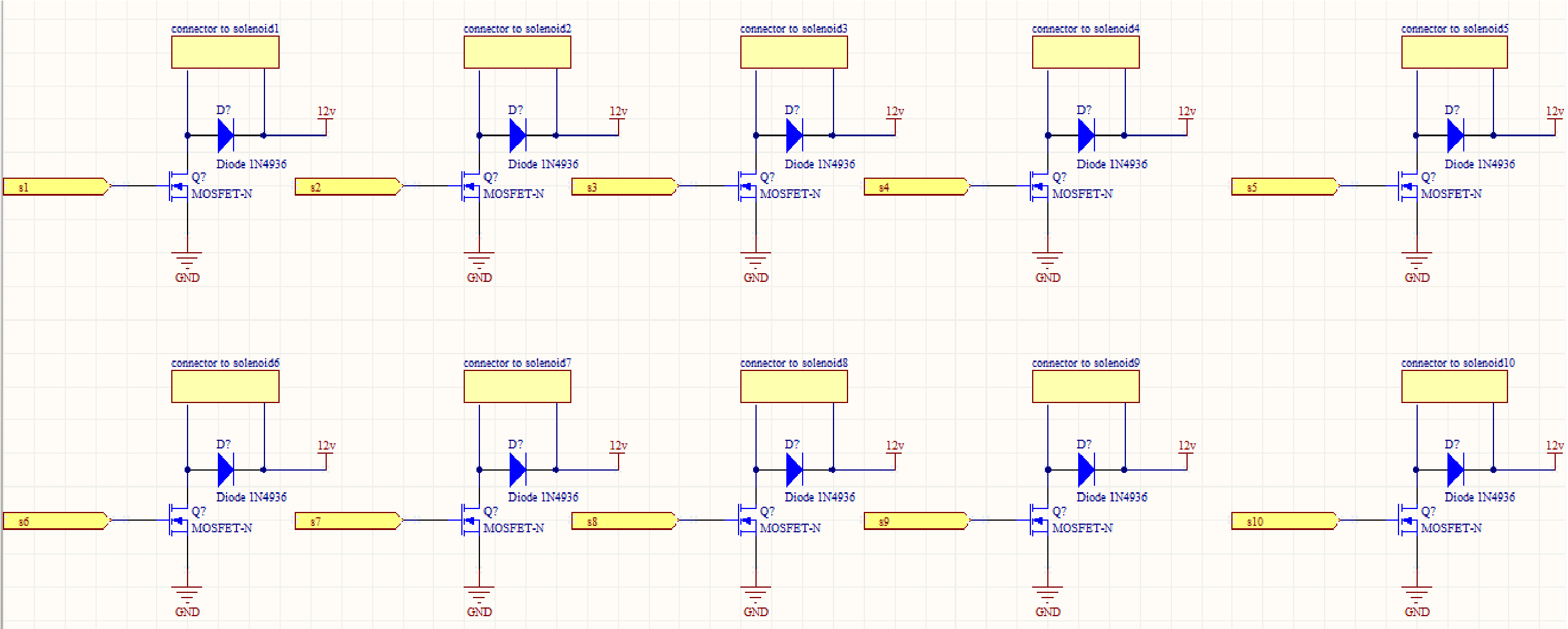

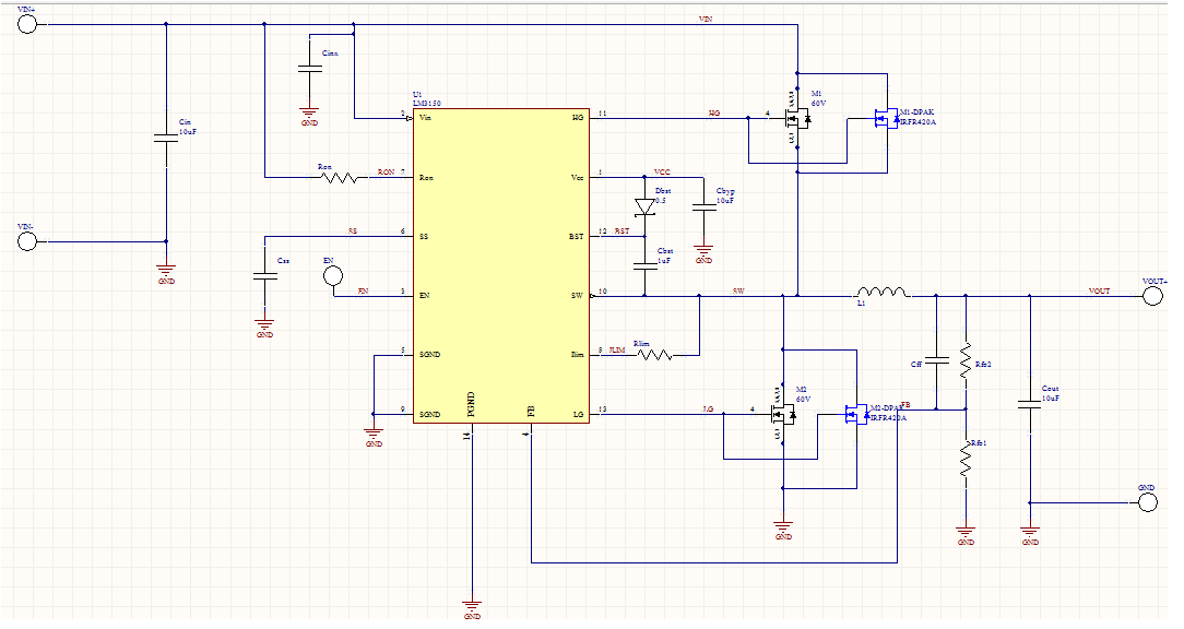

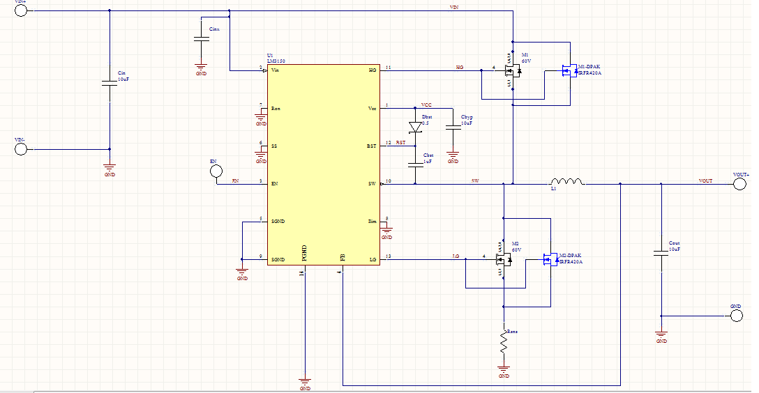

sorry for blurry shematics how can i put a better image. i just print screened the schematic put on paint.
one of my images is named 33v.jpg it is the schematic for my 3.3v power supply.
i've included images again i dont know if its better

sorry didnt have the parts listed these are the parts to use attached
  • solenoid circuit.txt
  • 3_3.txt
  • 5volt.txt
