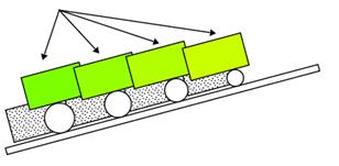

Can you expand on the idea of the mechanism which detects coin diameters and weight please??
Regarding the 4029,
I was going to makes slots of different sizes so that each coin falls through the first slot it can. [See Attachment]

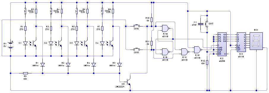

hi Mastahh,
About the 4029 counter, as the PTM u/d switches are wired as clock pull low when pressed, it is possible wire opto coupler outputs to also pull the u/d clocks low.
The point you have to consider is how the opto's are configured, for example: the IR emitter in the opto will be lit, so if the opto detector is wired with cathode [ or photo transistor emitter] is connected to 0V, then the output will be low [0v] when there is no coin in the opto slot.
The opto output will go high when a coin is in the opto slot.
You dont want this condition as it will disable the PTM down/up clock action. Recall that the unused PTM clock MUST be high for the pushed PTM to work.
Let me know which type of opto coupler you plan to use and we can suggest a circuit to give opto u/d and wired 'OR' PTM u/d action.

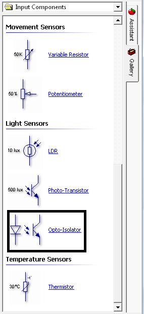

The coin diameter slots were what i had in mind.
A GENIE PIC is something you have to programme EVERTHING MANUALLY.
So it is very difficult to programme an updown count.
That is why i wanted it to work as a pulse generator.
Sorry about the opto-isolator comment.
However, i am unable to identify which one it is.
If you see the below attachment, it just litterally says what it is.
Not the component name.
The only information given is: 'Opto-Isolator (Ideal)'

No problem..:)
That opto coupler is a photo transistor detector type, more sensitive than a photo diode detector.

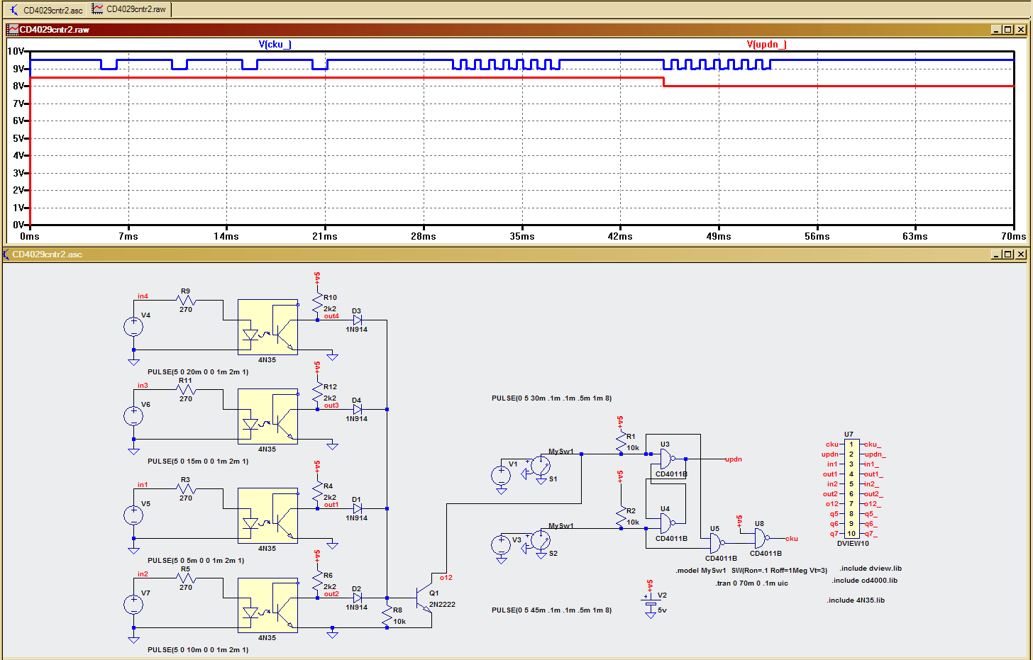

I have shown only 4 of the possible 8 opto-couplers, they are all connected in the same way.
The output from the 2N2222 gate is connected to the UP counter section of the 4029 Latch/Gate.
You can see at the start of the plot, 4 pulses, due to coins interrupting the opto couplers 1 to 4. On the right side of the plot are pulses coming from the PTM switches, this is to show how the two UP clocks are combined OK.
Having done this, I still cannot see how it is going to help with your Genie coin counting project.. perhaps I am missing something.:)

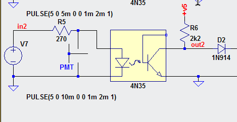

You can add a PTM switch across the opto coupler input emitter.
When you push the switch you would connect the junction of the 270R and opto emitter Anode to 0V, this will stop the opto emitter from driving the opto coupler transistor, its the same as putting a coin in the opto slot.
Do you follow OK.?

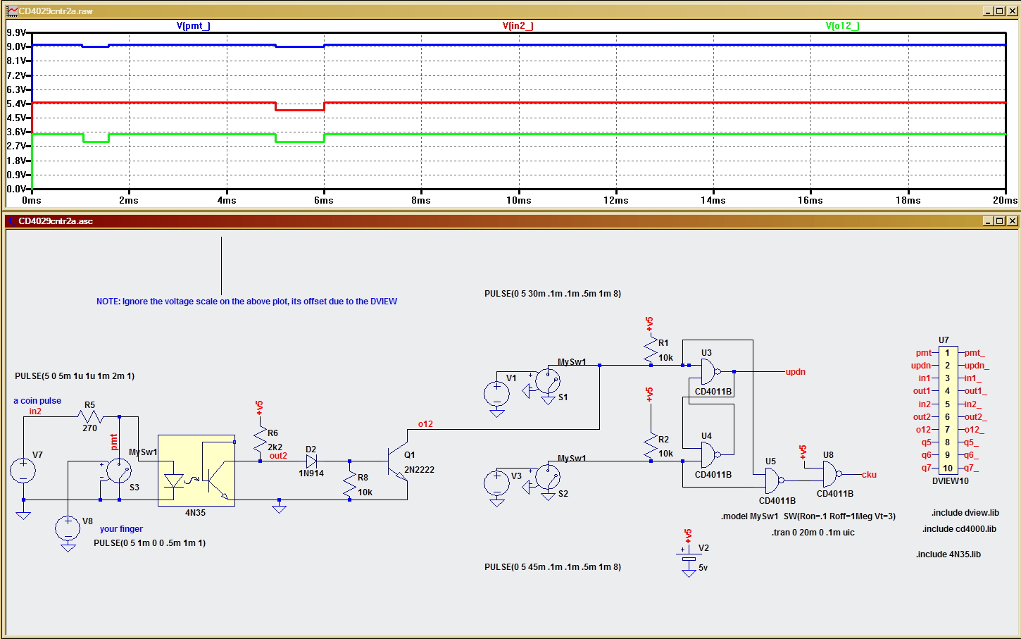

Hey,
So you are saying that this will work in the same method as well.
I just have to add the pulse and it the PTMs would simulate the output, instead of a coin?

Showing only one opto circuit, but it applies to all the optos.
the ptm is your finger press and the in2 is due to a coin.
EDIT:
in the plot I have mislabelled PTM as PMT.! believe me that is something quite different!...:rolleyes:

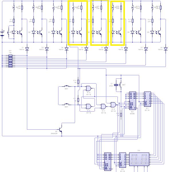

Hey,
Thanks For All Your Help So Far.
Im just wondering if the following can be done...
If you see my attachment, i have connected the 1st three optos directly to the 'units' column.
The first three optos represent 1p, 2p, 5p [the circuit is without the pulse]
Is there a way to connect the next 3 optos, the 10p, 20p, 50p optos directly to the 'tens' column? [the highlighted ones]
And the £1 and £2 optos to the next section? [the ones to the right of the highlighted ones]
I am asking because writing a hundred pulses in a PIC would take too long, and take up a lot of PIC memory.

I can hardly read that circuit diagram.:)
When you say 'tens' column do you mean the second 4029.??
Perhaps on your diagram you could draw in the connections you would like to have.??
EDIT:
on that diagram there is a only 1 resistor required for that diode gate.

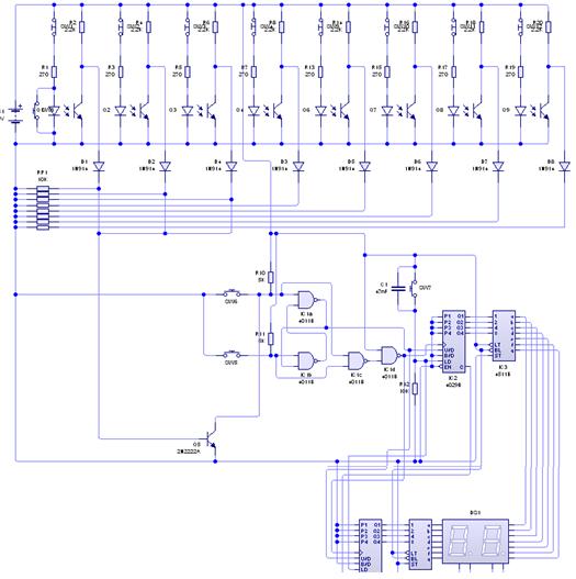

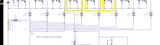

Hey,
Yeah, by tens, i mean the second 4029. Sorry if that didn't come out too clear.
The reason i have all the diodes connected to separate resistors is because each diode will become a separate input into the PIC. This way, i can create specific pulses for specific optos.
Do you think you can help me with this?
EDIT: Also, along with the 'tens', i may need one for the third 4029, as this is where the pound figures shall be displayed.
Circuit attached.
Don't know if this one is better or not.
It is too big to fit onto one page of the program clearly, so i had to crop out two halves on MS Word

If its only for counting a 'ten' UP it could done, to count a 'ten' down as well would be difficult., I will look it over.
