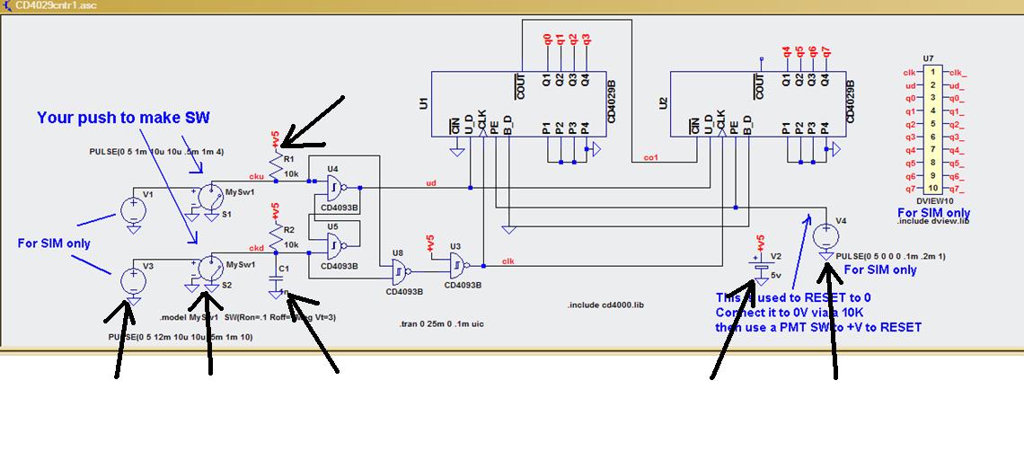

Hey,
I am really sorry about this but the components to which i have made arrows towards i am not familiar with since they are not the same in my program of Circuit Wizard.
Do you mind just quickly stating which they are??
Im really sorry about this.
Hey,
The small triangles are 0V connections.
Study the drawing more closely, you should be able to follow it by looking at the datasheet.
If you get really stuck, come back..

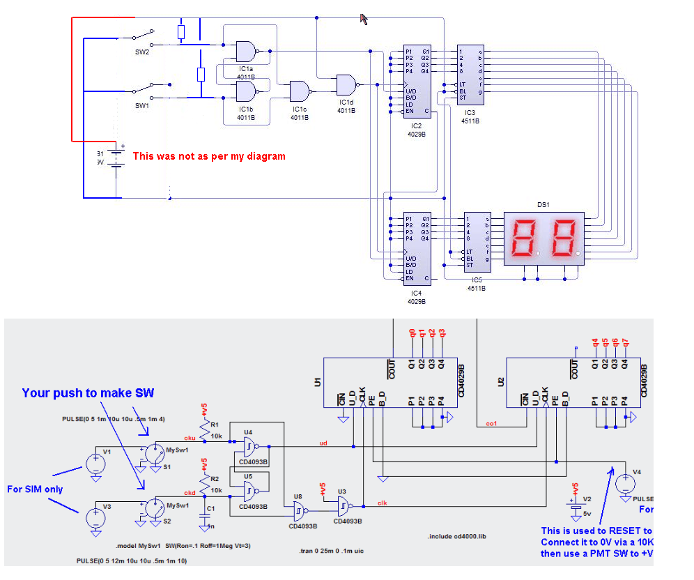

Sorry for the late reply.
I haven't had access to the internet.
This is my circuit, redesigned as per your attachment.
As you can see, it still is dysfunctional.
In fact, it has become worse than my problem before.
Is there anything that can be done??

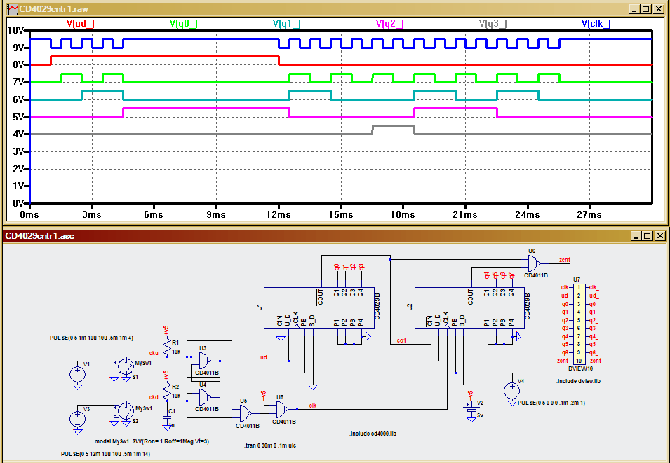

You have the switching wired wrong.!
Look at the sim plot it works OK, 4 pulses UP, then 14 pulses down.

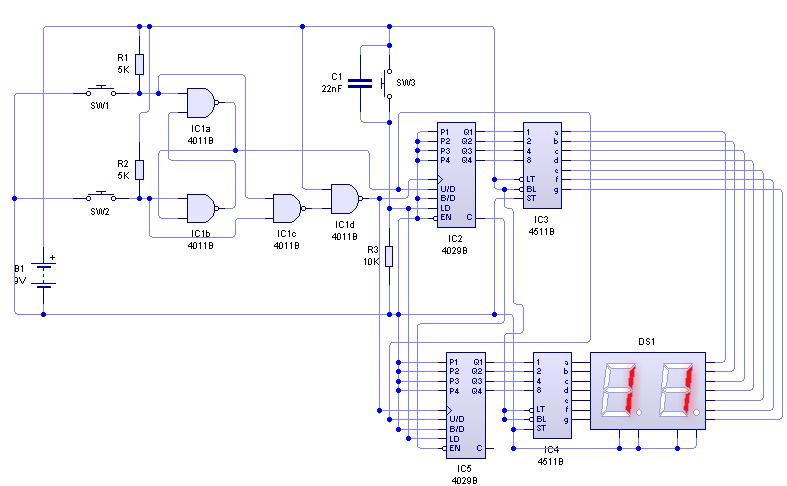

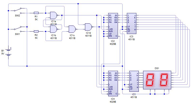

Hey,
Thanks for all your help so far.
I just got a couple of questions, mostly about the theory im guessing, along with some general problems.
First, the number on the 7 segment always starts at either 99 or 11, but never 00. Granted, i can press the reset, but is there a way to make it default on 00?
Second, instead of two SPDT switches, is there a way to make it just one push to make on both end on the left??
Third, if one switch is on the 'top', not connected, only then does the other one work. If it is at the bottom, it doesn't. Why??
Thanks a lot

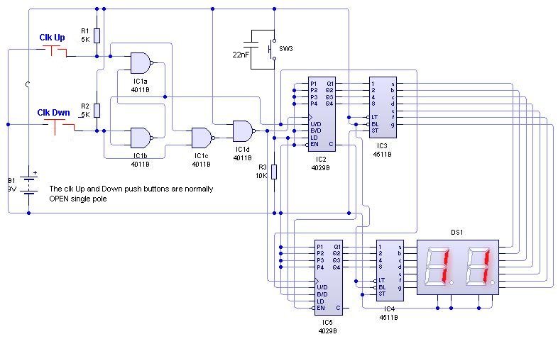

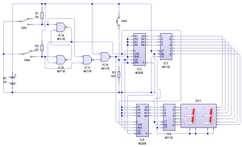

Hey,
Add the cap across the RESET switch
The drawing shows two single pole normally OPEN push buttons.
You have got it wired incorrectly!
Thanks a lot
Look at the edited drawing.

Hey,
You mate are amazing.
I just got one problem persisting.
When i start the circuit, the 7 segment displays 99 or 11. Any way to start at 00?
Hey,
Did you add the 22nF or 47nF cap across the RESET push switch as shown in last drawing..????

Hey,
See attachment
If you are showing a '1' or '9' after the power up RESET, this indicates that the 4011 latching is either setting high or low after the RESET period.
You could try to lengthen the RESET period by increasing the value of the reset10K to say 22K and/or also the cap to 47nF.
Are you just simulating this circuit or actually building it.?
If you building the circuit its important that you add decoupling across the +9V and 0V lines, say at least 22uF cap and a 47nF or 100nF cap in parallel.
If its just a simulation the its not possible to say what the state of the 4011 will be at power up.?
