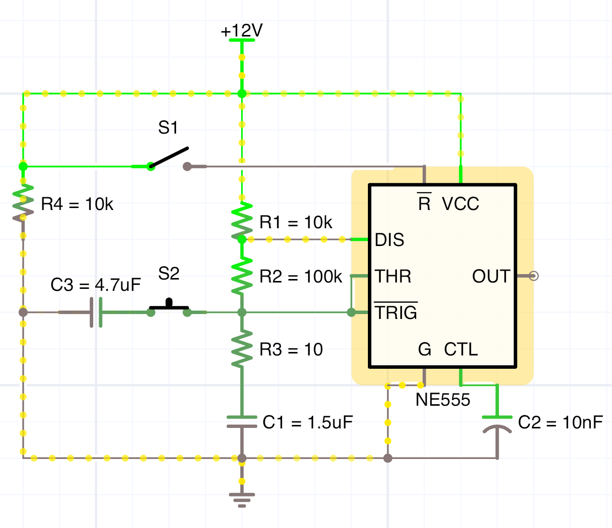

I have a working 12v vehicle CB that I would like to make a modification to.
I'd like for it to scan through the 40 channels on it's own.
With no modifications, I press/release the channel-up button, to go one channel up.
With no modifications, I press/hold the channel-up button it will RAPIDLY go through the channels.
My thought is to have a circuit to close the two pins on the channel up button, maybe once a second. Allowing time to hear activity on the channel.
one pin is 1v, the other is 10v-10.5v (varies each time powered up).
I tried an RC circuit but I'm doing something wrong.
It either goes one channel up just once, or it RAPIDLY goes through the channels.
T = 1 s = 1kΩ x 1 uF
I made the changes, but I'm not seeing the function I'm looking for.
I think the RC circuit is not enough, and maybe I need an oscillator?
I get one channel change with the RC each time I connect it, instead of multiple channel changes.
I will start looking at oscillator circuits.

I tried this circuit, but still have the same results of it speeding though the channels. I may have something wired wrong.
I'm assuming the 9k1Ω is a typo for 9kΩ.
I'm going to try simulating in LTspice to verify results before building.

R1 is 9k, try changing C to 2.2uf so timeout is ~22ms
VCC should be 12v.
If that doesn't work, you might have to drive an analog switch, or a small relay, with the 555 timer.
The circuit you show above is intended to provide a single long pulse each time the button is pressed; the values are daft though, it suits far longer delays than the button press time.
Try this version from the same site, and connect the button in series with the connection between VCC and Ra
If Ra is relatively small, eg. 1K, and Rb quite large, eg. 47k, the output will have almost symmetrical high & low times.
Try 47k and 10uF as a starting value? Or 100K if that is too fast.

Here, turn on S1 to start your pulse train at 1Hz (approx) and press S2 to get Hz or more (depending on capacitor C1 size. R3 can be replaced by a wire (0 ohm) connection (my iPad simulator doesn't like capacitors in parallel).. Note, S2 is normally closed.

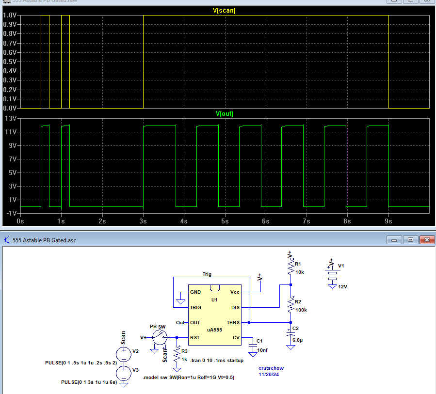

Below is the LTspice sim of ZZO's basic circuit without the added timing capacitor:
I added a pull-down resistor to the RST (/R) input, which is required for proper reset operation, since a RST open is equal to RST high.

R4 was the reset pull-down in my circuit. How do you stop the scan to listen to a channel once interesting content is found?
It appears to be connected to +12V.
And the pull-down can be no larger than 1kΩ to insure Reset (look at the reset voltage and current specs).
Release the button on my circuit.

What is the purpose of R4 across the power supply lines?
Is R3/ C1 pair meant to prolong the 555's output pulse?
R3 is not needed - it was only there because my simulation app won't simulate capacitors in series.
C1 is there in parallel with C3. The 555 timer runs faster when the normally-closed button is pressed to break connection to C3 and make the scan faster so you can run through the channels faster when the button is pressed (S2).
R4 was an error. See revised circuit to show S1 turning off the scan when you find your preferred channel.
