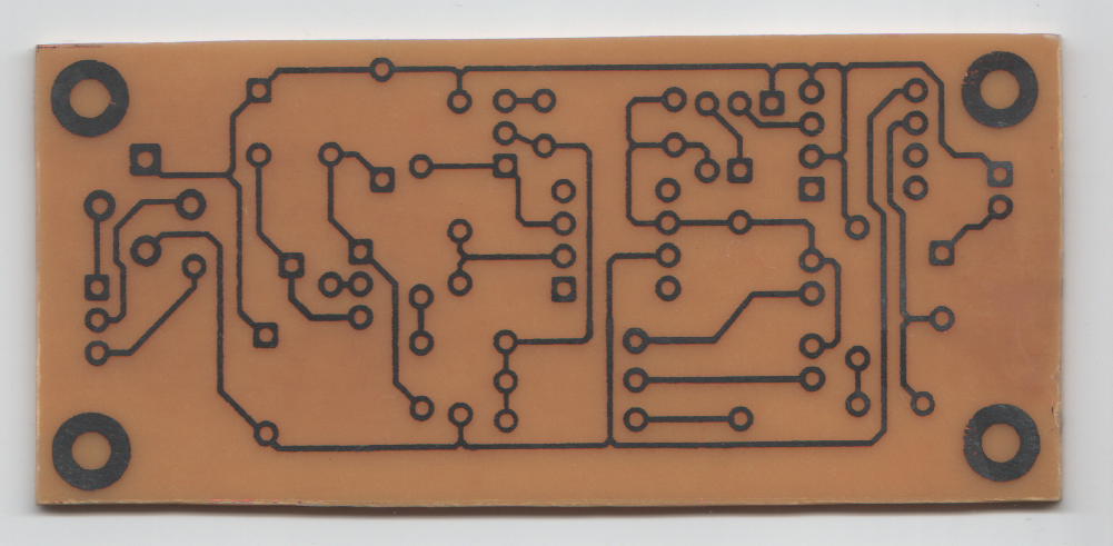

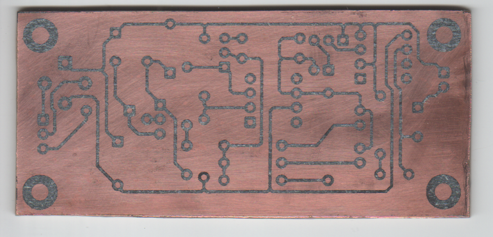

Here's my latest board etched using magazine paper.
I didn't bother experimenting with a release agent because I want the board done tomorrow and don't want to experiment but get a reliable result.
Here are some pictures.

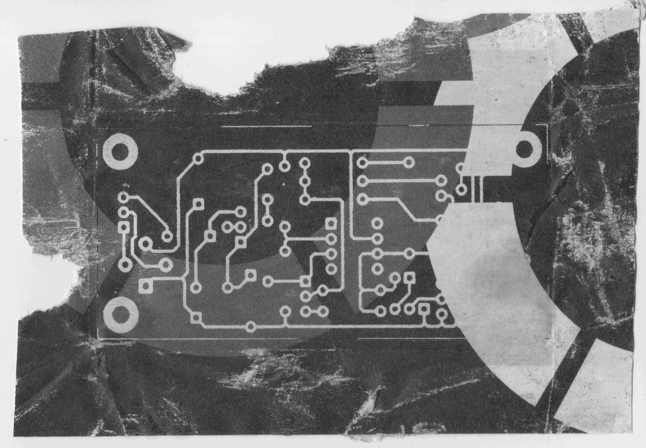

1) The toner transferred to the PCB: notice how the clay has stuck to the toner giving it a greyish colour.
2) The used magazine paper: look you can see where the ink has lifted off the page.
3) The final print, I'm not going to remove the toner until I'm ready to solder.
I took the above pictures by scanning the board/paper - much better than messing around with a camera.
really Nice result Hero. Scanning is the best. we resort to camera for want of scanner.
Don't you feel the drill holes of most components are larger. perhaps, for future boards, you may reduce the drill diameter so that each pad can have more copper skin, and the central drill marking can be as small , only to guide the drill bit centering.
What size are the traces
as well as component pads.
they look big??

The smallest holes are 1mm - it's my smallest drill bit.
The smallest pads are 2mm wide.
I should have put a ruler in the picture, the board is approximately 35×78mm and is not perfectly square as I can't saw perfectly straight with a hacksaw.
mag paper looks like a good alternative but still wonder about jamming the printer,
That'll only happen if you use really thin paper. I've never had a problem with jamming because the paper I use isn't much thinner than normal copier paper.
how small of a trace is possible etc.
The traces on the boards above are all 0.5mm.
I've never needed to go thinner than 0.5mm but I know 0.25mm (about 0.01 inches) must be possible as I use it for the silk screen.

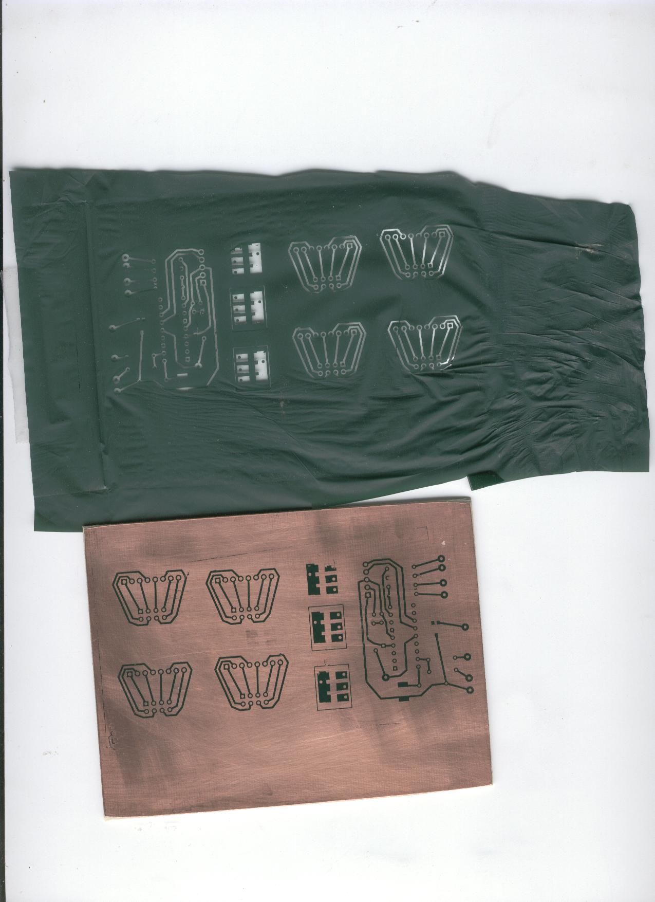

My adapter boards and LED candle PCB
After yesterdays diaster (wrong sized traces) I redid and here are the results.
EXCELLENT transfer using the PULSAR method and a laminator.
in the photo is the green TRF foil after applying to board.
the gree is removed from the foil onto the ink thus you end up with a reverse image of your board.
if you don't have a perfect image then the green didn't fully transfer.
the pads are 1.42mm w/ .74 holes traces are all .o25"
