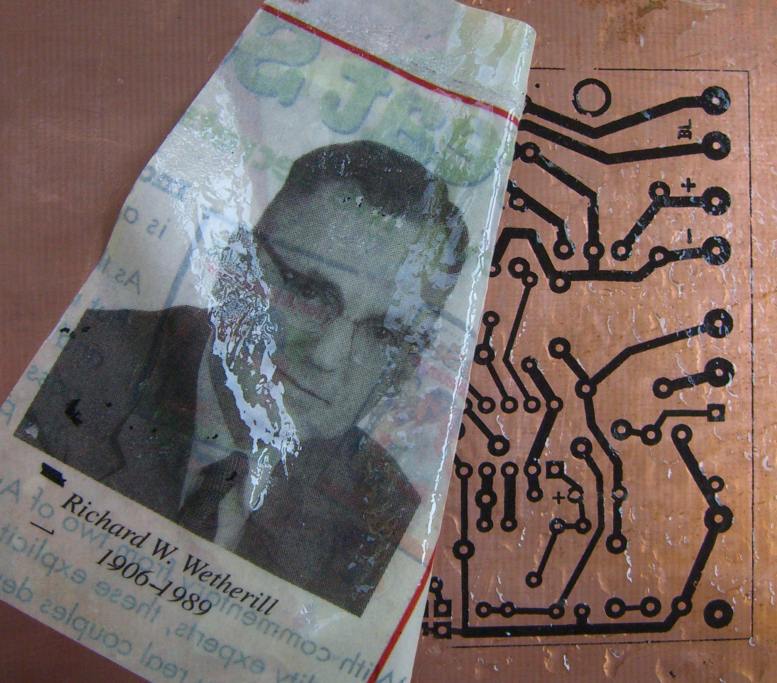

I think I am making progress on the magazine papers ability to release the toner much, much faster.
Elmer's (new) School Glue Gel ($2.29 us for 4 oz)
seems to do the job. Found it accidentally this afternoon.
After smearing it on the magazine paper wrinkles badly during drying and must be ironed before the PCB pattern can be printed.
Made a mistake and left my iron temp. at 300°F,
that was too hot but I went ahead with the test anyhow. The printed pattern looked good under a magnifying glass, except for a few places were it had bubbled due to the excess heat.
The transfer looked fine except for the places with the bubbles. After ironing for about three minutes I dipped the PCB directly in water. After a few minutes soaking, the paper just about fell off!
And the traces looked great.
Now I just have to find out the best way to get the glue on, using my finger is not my preferred way. Maybe I can dilute the glue with water and dip a whole page at the time.
Also I have to find the correct temp., to iron the paper before printing.

2nd try with Elmer's Gel Glue
{snip}And the traces looked great.
Also I have to find the correct temp., to iron the paper before printing. {snip}
Here is a picture of the PCB, still soaking wet, after soaking for about two minutes. Note the transfer paper came off in one piece!
There are some distortions in traces due to water droplets acting like little lenses.
The transfer paper was ironed at 200°F to removed the wrinkles that the Elmer's gel glue caused. Paper has to be dry first.
Next I will try to dilute the glue and dip a whole sheet in at one time. Stay tuned!

The only think I would like to improve it the soak time, if the paper could fall away as soon as it gets wet, it would be great.

Since you are going to coat the paper yourself, go with something heavier than magazine paper. It won't curl and wrinkle as much. Before you coat, you can tape it down to a smooth surface (glass maybe), apply the goo, and use something like a non-stick Teflon cutting board/sheet, maybe even some of that wax paper... over the coating, then a heavy smooth surface to keep it pressed flat. Everything is reusable, except the paper.
Going thicker might not help, any paper will curl and bubble if you get it too soggy.
I think using something less wet is probably a better solution.

I'm going to try hairspray for the next board I print, hopefully it'll be quick drying and won't cause wrinkling. Hairspray should be able to take some heat as it's designed for use with hair driers and curling tongs. It should also be water soluble enough to release the toner effectively.

{snip}I'm going to try hairspray for the next board I print, hopefully it'll be quick drying and won't cause wrinkling. Hairspray should be able to take some heat as it's designed for use with hair driers and curling tongs. It should also be water soluble enough to release the toner effectively.
The hear spray I tried did a good job of going on without causing excessive wrinkles, I am fairly sure I can print on it without ironing it first, it is also fairly fast drying.
Hopefully I can do a toner transfer test tomorrow.
The hair spray I tried did a good job of going on without causing excessive wrinkles, I am fairly sure I can print on it without ironing it first, it is also fairly fast drying.
Edit: The printer smoothed out the paper and made fine impression.
