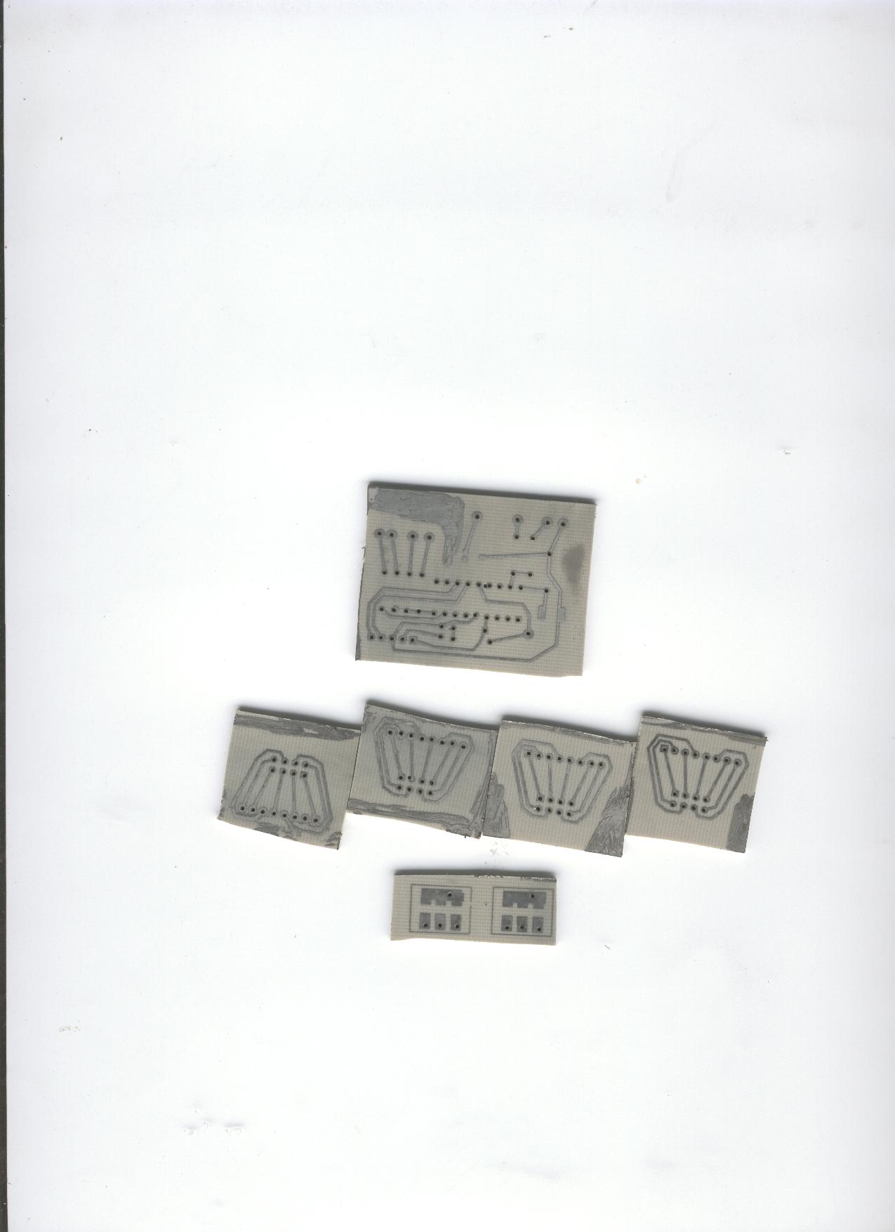

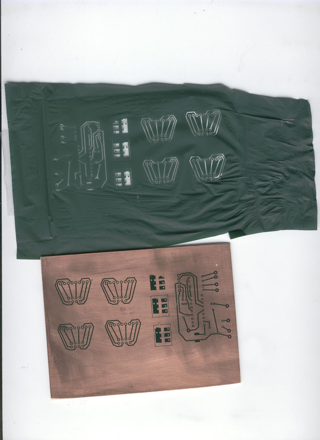

EXCELLENT transfer using the PULSAR method and a laminator.
Your definition of excellent and mine seem to differ a little. One of your components didn't transfer fully (middle top). I also see a few area's that are deformed and missing bits.
I'm not dis'ing the process, because I know it works, but I think you might want to fiddle with some things to try and get it even better. I'm no expert with the Pulsar stuff, but I'm sure someone else here can suggest something.
Saw that after I scaned the board
didn't see any ink on the paper after I removed it.
after looking at board I find I failed to CLEAN it really good after I made yesterdays mistakes.
the traces missing are of no concern anyway.
the bits must have come off when I did the TRF wrong (applied w/ shinny side to ink) then redid the foil right.
I looked at the paper = no bits so it had to come off due to a finger print or ??
Like I said the boards I have been doing of late are coming out almost if not perfect (if I paid more attention to what I am doing, operator error) since I purchased a laminator, put through several times then cooled in water immediately.
One thing that I forgot to mention when printing a board is some printers will not deposit enought ink if printing large printed areas such as filled plains. Pulsar said it is due to the fact that some printers can't keep up with the ink when doing large filled printed areas.
The transfer is fine
I check the paper after removing for traces and there are / none left behind.
Only thing I figure is I failed to clean the board thoroughly.
After I etched I found traces of the previous transfer that I had done on same board but failed to clean off completely.Need to clean better next time.
I let the laminator run for 1/2 hour before using then run the board 4-5 times through the laminator just to be sure.
then cool and remove paper. check for bits of black still on paper.
none appeared so I figured it came off when I did the foil.

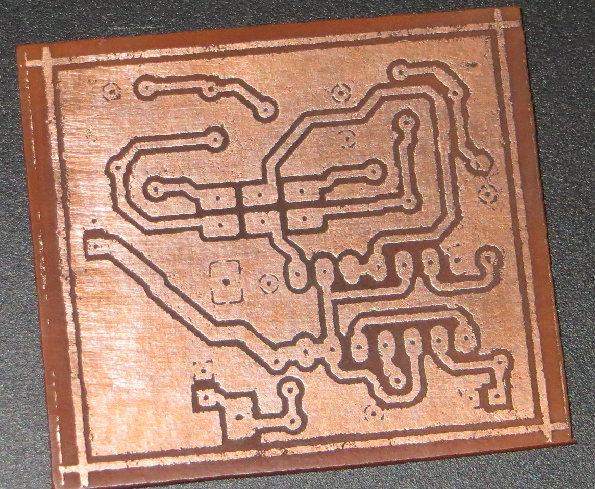

I know this is an old thread, but I thought I'd add my efforts with dextrin coated paper to the list. You can make dextrin by baking (UK cornflour, US cornstarch) in the oven at 200C for 2 hours, stirring regularly. Mix it with water and you get a glue very much like you find on envelopes. In fact, if you taste it, it tastes like licking envelopes tastes like.
Anyway, the recipes on the net say you should spray the paper with silicone waterproofing spray first to stop it wrinkling up. I don't have and can't afford that stuff, so I soaked the paper with water and brushed it down on to the kitchen worktop, much like we did in school art lessons to stretch the paper and stop it wrinkling. It works tolerably well. Next I tried to appy a nice even coat of the dextrin glue. I tried a silicone pastry brush, a traditional pastry brush, and a squeegee. The squeegee isn't very even, though I managed with it for the first sheet. For subsequent sheets I used the traditional pastry brush.
I used some thin paper, I don't know what sort it is - just it's quite old - might have been used for drafting originally.
Being impatient (and wanting to free up the kitchen worktop) I used a hair drier to dry the first sheet. The sheet was a bit wibbly wobbly, but this was easily ironed out. I printed the design on the sheet, ironed it onto the pcb, put it in hot water, paper all but floated off - amazing!
So as far as DIY transfer papers go, for me this The Way.
Having other issues now like toner not sticking to the copper adequately, porous transfer etc, lots of retouching required, but I'm sure I will resolve those.
