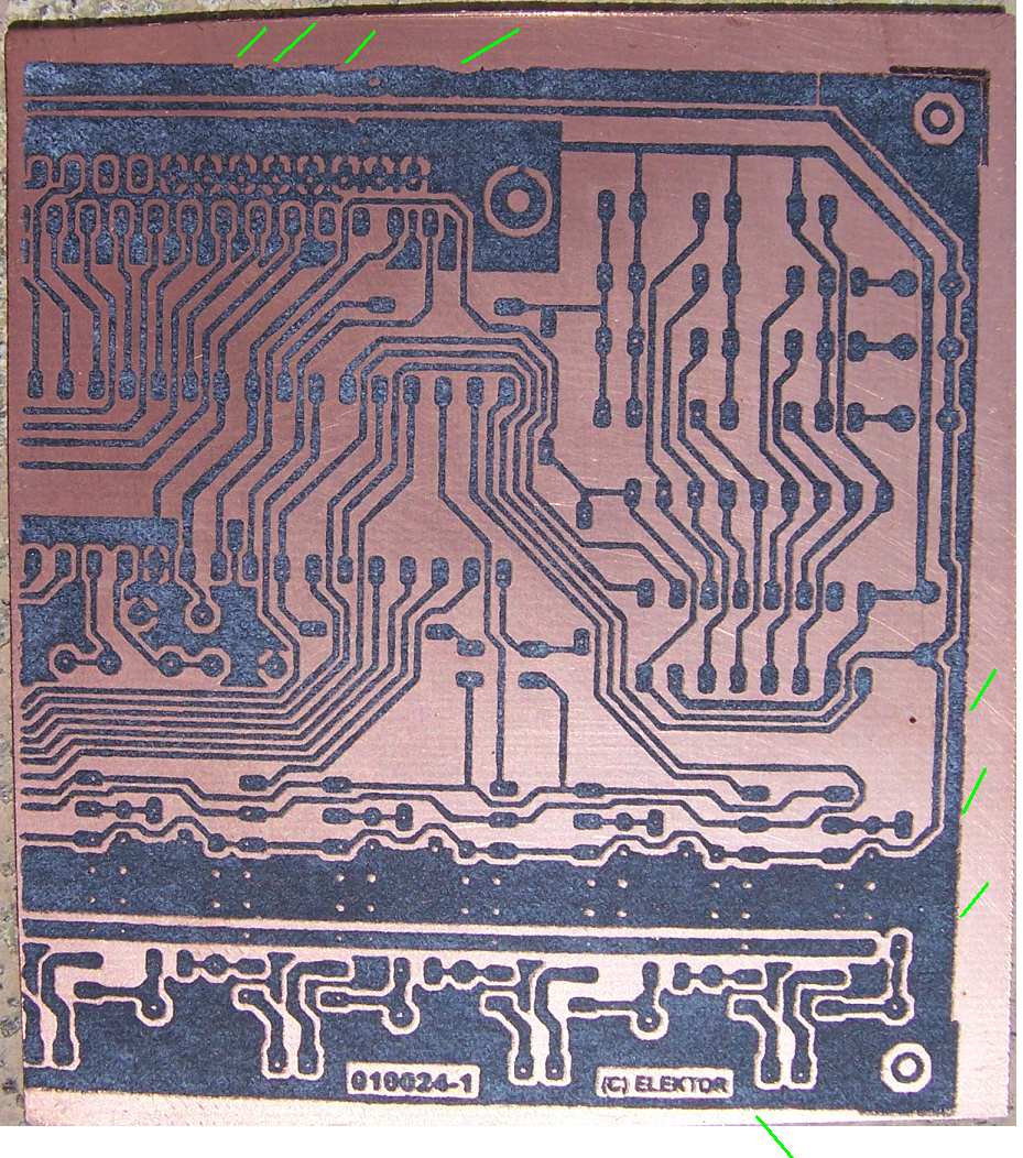

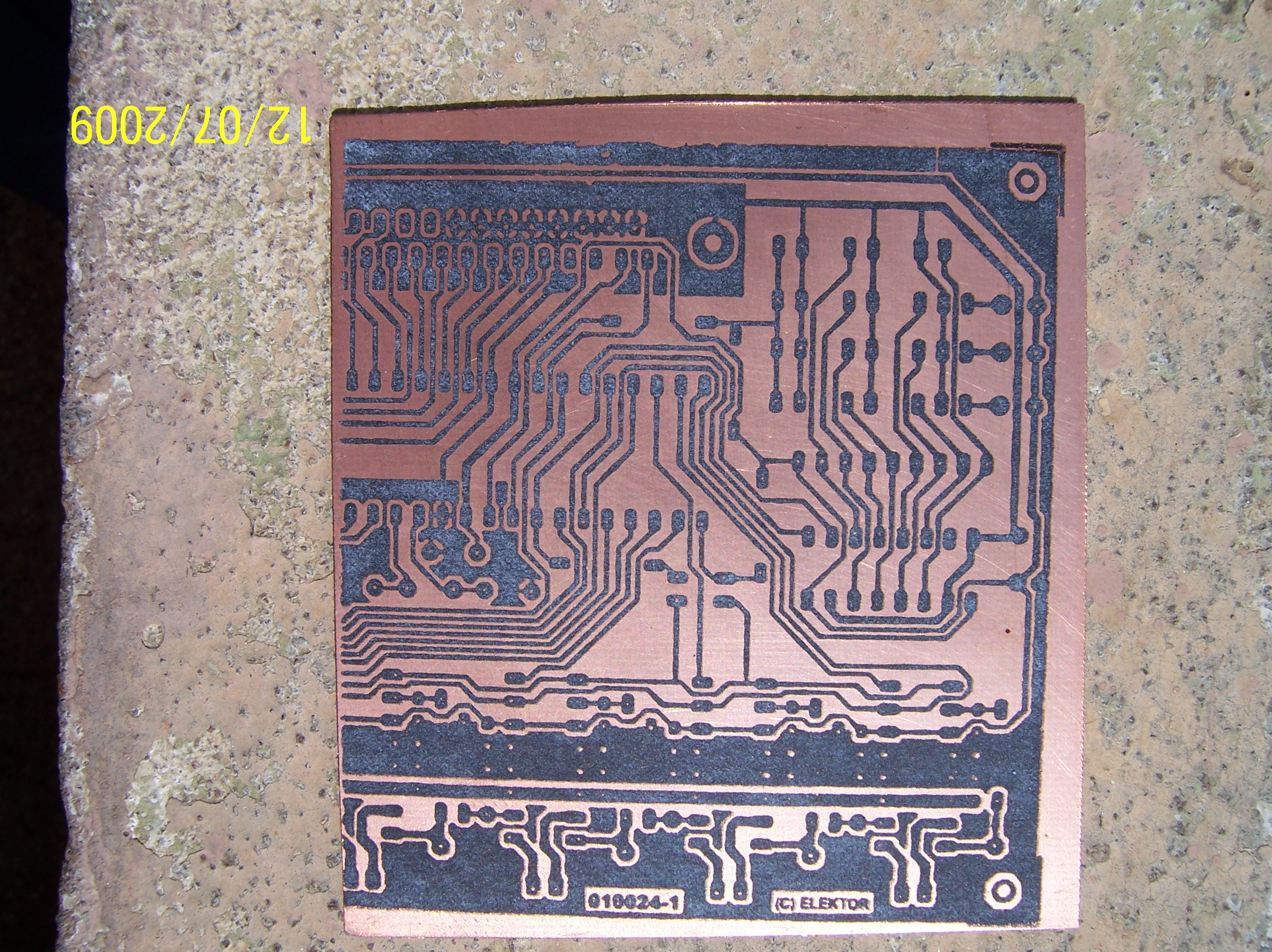

Here is a photo of trial of fraction of the sheet i printed. I am not in for etching at this stage. Little bit of hand rubbing was warranted. the edge of one side is not registered properly on to copper.
What do you mean?
It appears that all of the section you've tried has transferred very well.
What do you mean?
please see the bad locations markesd in Green, Hero999 !!
i need to improve, as small tacks like those for SMD may have problem, i fear.
I think you're being too picky, you're not going to solder anything to the outside tracks, it's just part of the ground plain isn't it?
The fine detail in the middle of the board has transferred perfectly.
I tend to avoid putting traces in between DIL pins, unless there's a solder resist layer, as it's very easy to bridge them with solder.
I've often found that tracks near the edge don't transfer so well, it's an issue with the ironing not the paper. The solution is: don't put any tracks too near the edge of the board, it's considered to be bad practise anyway. It's different with planes since they're already thick enough any way.
If it bothered you, just touch it up with a marker pen.
