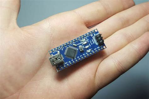

The Arduino is a micro-controller development system, not an actual device. You could develop your project using one, and then transfer it to a bare chip, such as an AT-Tiny, which is only an 8 pin device.
Likewise you could develop it using a MicroChip PIC, which is available in a range of different 8 pin devices.
Either situation is likely to result in a much smaller, much simpler, and much more capable end result. Timing isn't an issue, and you can easily adjust it from microseconds to years, something very difficult in hardware. It can also be programmed and designed to be VERY, VERY low power.
Minimum component wise - you're looking at one PIC/AVR, one FET to drive relay, one diode across relay, and one button switch to control the device. Plus it's power supply - with a 12V supply a simple 78L05 regulator and two capacitors would be all that's needed.

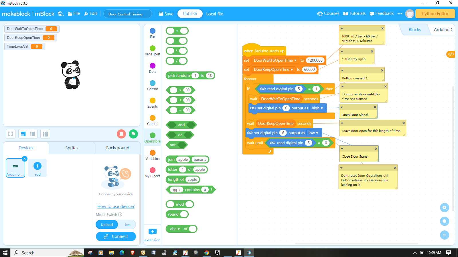

For your design an easy way pf programming is to use block programming, like mBlock .
Basically it takes a GUI representation of your block setup, your design, and converts it
to Arduino code, and programs the board. A Nano board (~3$) would work fine for this :
The above a first pass at the design, you drag and drop blocks into right hand window,
set any variables needed, and create the control signals on pins.
Use off the shelf relay board, some are isolated, like :
To control solenoids, motors......

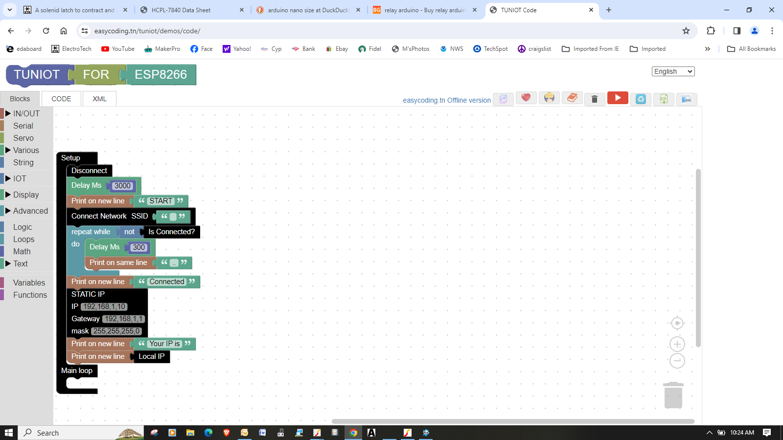

If you wanted a wireless networked solution , use Tuniot instead of mBlock, and an ESP8266 or ESP32
board.
Here is what it takes to setup a basic network interface, and you would add the block code,
similar to what I show above, to it to control the door.
Lots of fun, easy to learn, many videos on youtube.
Note to use mBlock (its free) your install Arduino IDE (also free) as mBlock uses the Arduino
IDE which has a board programmer mBlock uses to upload the code to the board.
Regards, Dana.
