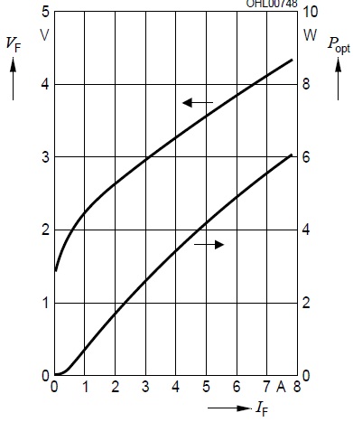

Hi everyone,
i have designed a circuit to amplify a signal(max.Voltage 2V, pulswidth 2 ns,frequency 1MHz) so that it can drive a laserdiode. the request should be a peak current >1A which flows over the laserdiode. Right now i am using only a HF transistor(NTE 48), the laserdiode is as last between Vcc and collector. the emitter is shorted to GND.
right now i can measure the voltage on the laserdiode with peak 3V, pulswidth ≈2,5 ns. But when i meauserd the current( i used a coil which have 36 windings and parallel to a resistor 36Ω that means 1V is 1A),the peak current was only 100 mA and the pulswidth got wider...it should be more narrow...because acrroding the datasheet 3V should have 3A current...(see pic.)
1-jpg.55930
does someone know how it was going? if anyone of u did so just share me ur expirence i appreciated kindly....
by the way i dlike to use a ulztrafast mosfet to amlify, does anyone know which typ pass this? the request is the rise and fall time of the FET should be in 1 ns range.

NTE48 is not fast! There is no way it responds in 2nS.
The data sheet is not good! Some where between 100mhz and 1,000mhz the gain=1 and thats with 5 volts CE. You are using the part with maybe 1V from CE so the transistor will be much slower!
You want 3A form a 1A transistor?
I see more problems. What diode are you using?
I don't understand that. A 1 ohm resistor will drop 1V when passing a 1A current. Why 36 ohms? What is the coil for? Are you trying to make a 1 ohm resistor?
Unless the coil's resistance is 1 ohm (actually slightly above, since it apparently is connected in parallel with 36 ohms) your measurement won't be what you expect.
the pic is the IU- Cureve of diode laser (SPL PL90_0). the continouse current of NTE48 is 1 A. what i want to have is a peak current with 3A in a pulswidth 2 ns. I also changed the tansistor by BLY 88A. but the result was not better than NTE48.

ok. the data for laser u can get from: https://www.electro-tech-online.com/custompdfs/2011/08/OSR_SPLPL90.pdf
