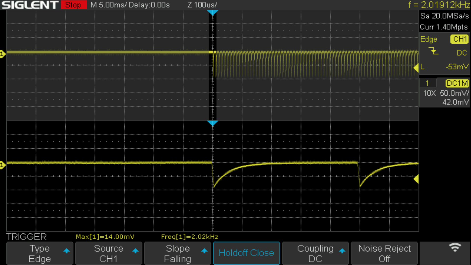

What frequency and waveform does the lcr t4 device use when testing capacitors to measure the capacitance and esr Vloss values of the capacitor?
Is there anyone who is testing different capacitors and can measure the frequency sent by the lcr t4 tester to the capacitor with a scope?

I have a Anatek Blue ESR checker, this is what ESR test waveform look's like at
end of probes. 2 Khz, 100 mV, step, with a cap under test.
From the meter manual :
the meter’s test signal is a 500mV P-P (open circuit) burst of 8 usec pulses at a 2kHz rate, repeated several times per second

Dear engineer, thank you for valuing my challenge and doing the test. Is there the same waveform and frequency in different electrolytic and polyester capacitors?
Yes.
