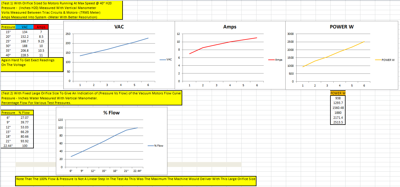

The TRMS meter is a cheaper import type, no manufacturing country named but I think you'll know where from so it should be accurate to within +- 200V or so ha!
I retested things & will attach the results, the TRMS meter was more stable but I still couldn't get exact readings due to small variations, I used a different Clamp Meter this time for the current with much better resolution.

Missed Ya! Nice re-graph! So it looks like V^2 it is, ignoring power factor stuff. Power is pretty linear.
1% may not be good enough, so just think linear interpolation, so you could ask for 93.25%. Easy enough.
I hope you can ride through what I posted. I'm a intuitive kind of guy, but math isn't my specialty.
