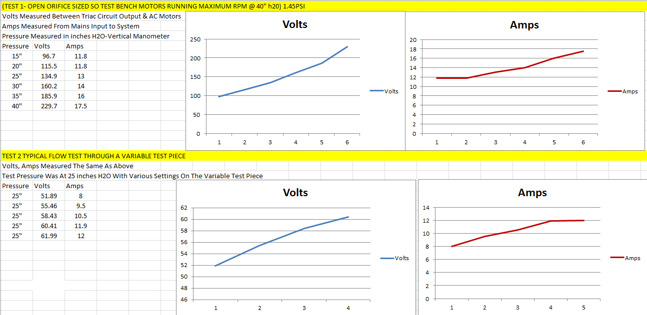

I have had trouble trying to find a suitable Triac locally so I can run all four motors together to test to see if the vacuum is proportional to voltage or current.
I couldn't find a Triac so I thought a dual Potentiometer would allow me to control my two existing Triac circuits together instead of independently running all four motors together at the same speed or closer to it.
After rewiring things to suit I ran a few tests & had some issues with the DMM reading the voltage from the Triacs to the Motors, I guess this is due to trying to read partial ac waveforms?
After persisting I have some results which I will attach, the Power consumed at Maxium settings is around 4kW-APProx 5.3 HP, much less for test purposes.

Voltages and current wont be close unless you use a TRMS meter. The mains current and voltage is a good idea of power.
The initial one sort of shows, an unloaded condition. . It's fairly linear given that your probably not measuring the RMS voltage. The currents are near each other rather than orders of magnitude apart which MAY mean finer control is necessary. 240 * I really doesn't alter the shape of the vacuum(current) curve. It could easily be vacuum(current * 240) or vacuum is likely proportional somewhat to power. Forget about V^2, unless you have a TRMS meter.
We used normal meters too, but we knew they were wrong. It did provide info though, like a thermocouple is out of place. For one experiment we had to use a three phase power monitor (using only one phase) though,
