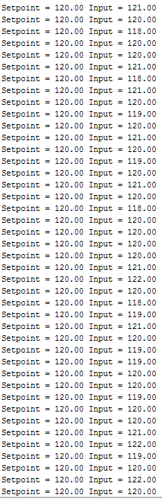

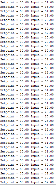

Just getting back to the Lamp setup, power like you mention is proportional to the square of the voltage, so if we have half the voltage the power is one quarter of the of the peak power output.
Is this assuming a constant resistance?
A lamp is not constant resistance is it?
This is where I have been somewhat confused by things but in saying that it doesn't take much to get me confused these days?
Cheers
  • BTA16-600B - STMicroelectronics.pdf
  • NTE56033.pdf
Yes.
It can best be described as a current dependent resistor. The resistance is about 11-12x lower than the full brightness R.
However,
In the limit as ΔT approaches zero, R(lamp) is a constant.
The proportional gain might only work for a small value of ΔT. e.g. 10 degrees might cause the controller to output 100%. 1/kp is the proportional band.
The PID algorithm should be modified for Tungsten and you can buy "triac circuits" designed for Tungsten loads.
What happens, I don't really know, but limiting the rate of change of the output per unit time would really help.
When you combine it with V^2 limits, rate of rise on V^2 and current limits you have a stronger solution.
One way to implement current limit would be to feedback the current and cause the output of PID to reduce. Usually 25 to 100% of the TRIAC/SCR unit is the range of current limit operation.

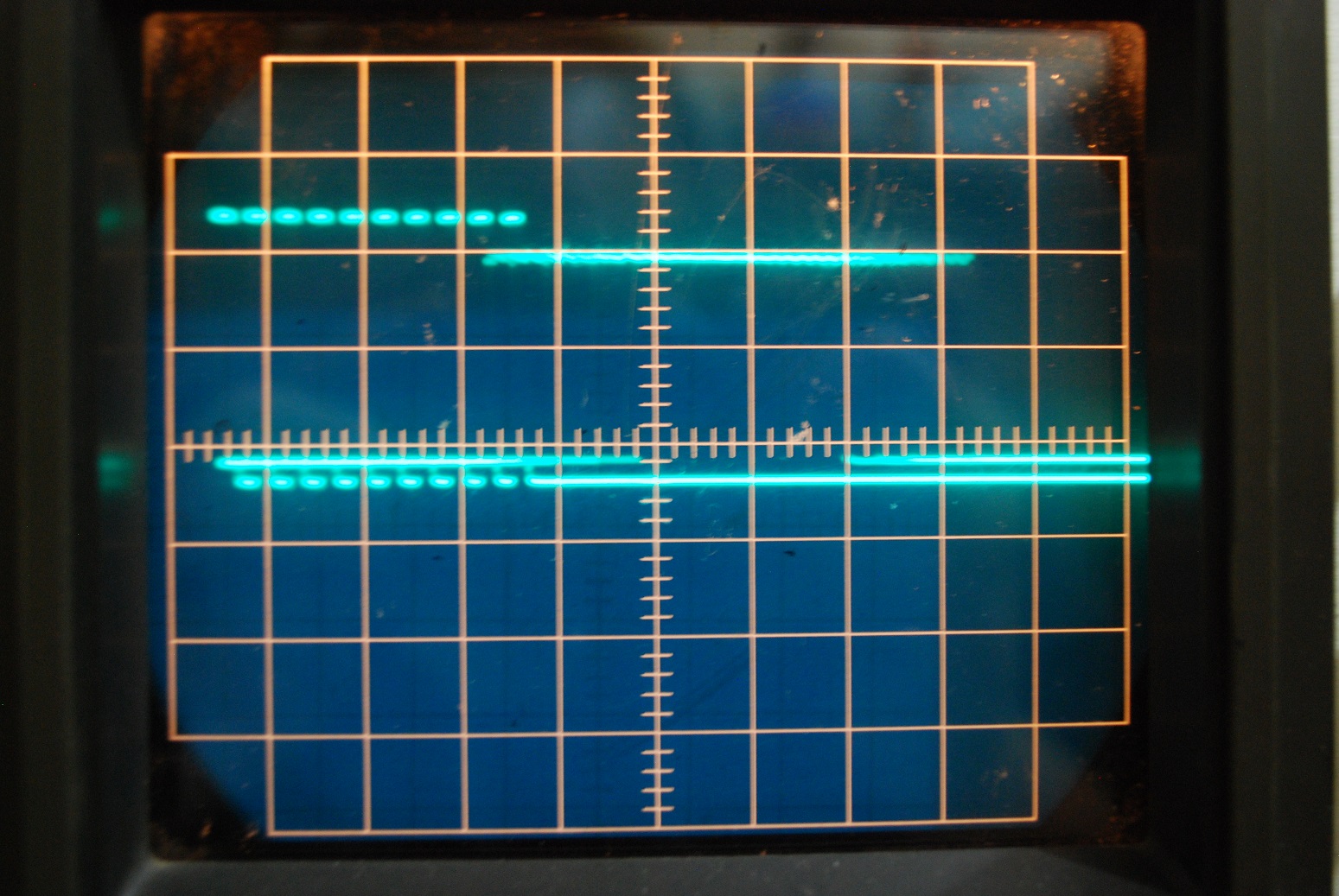

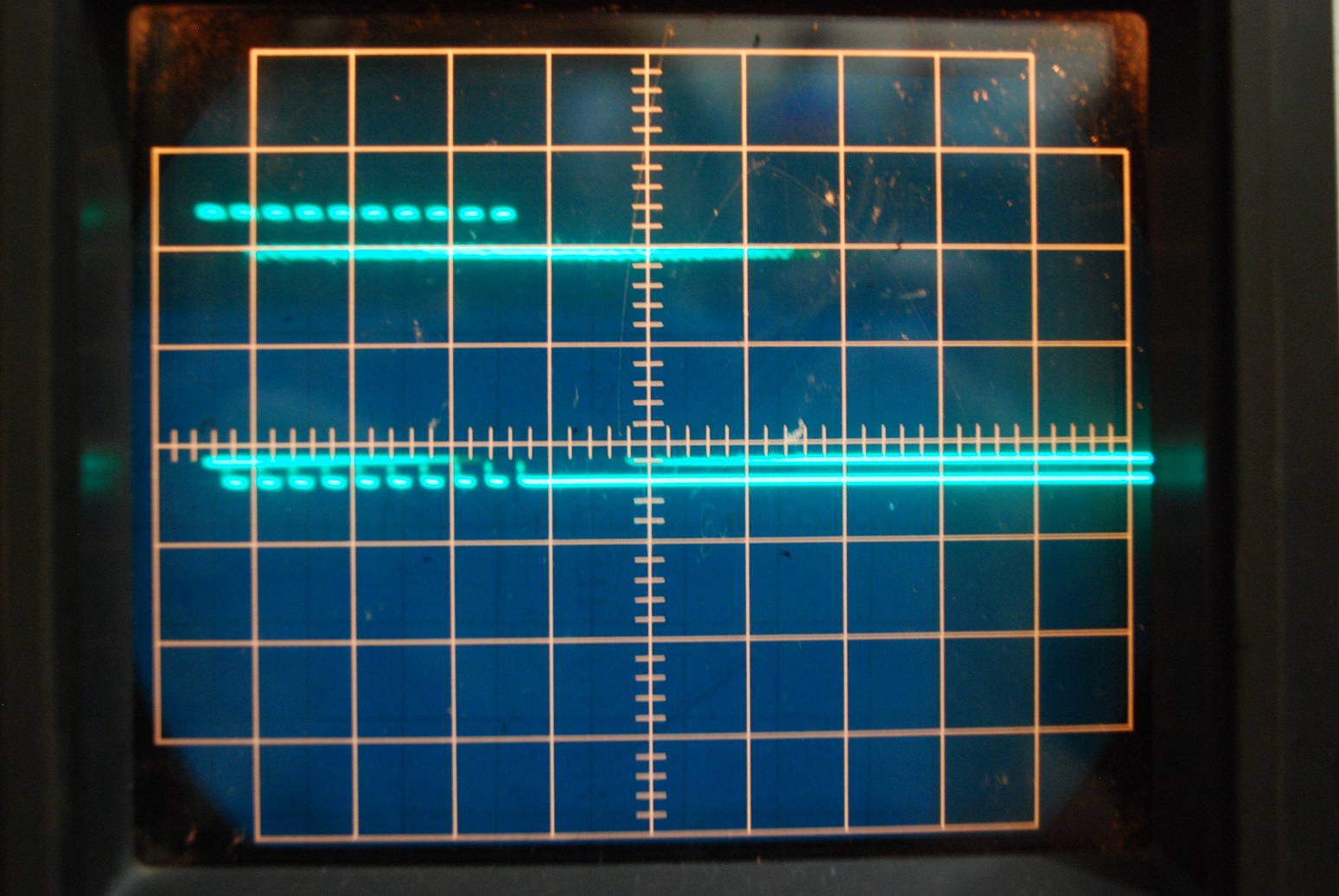

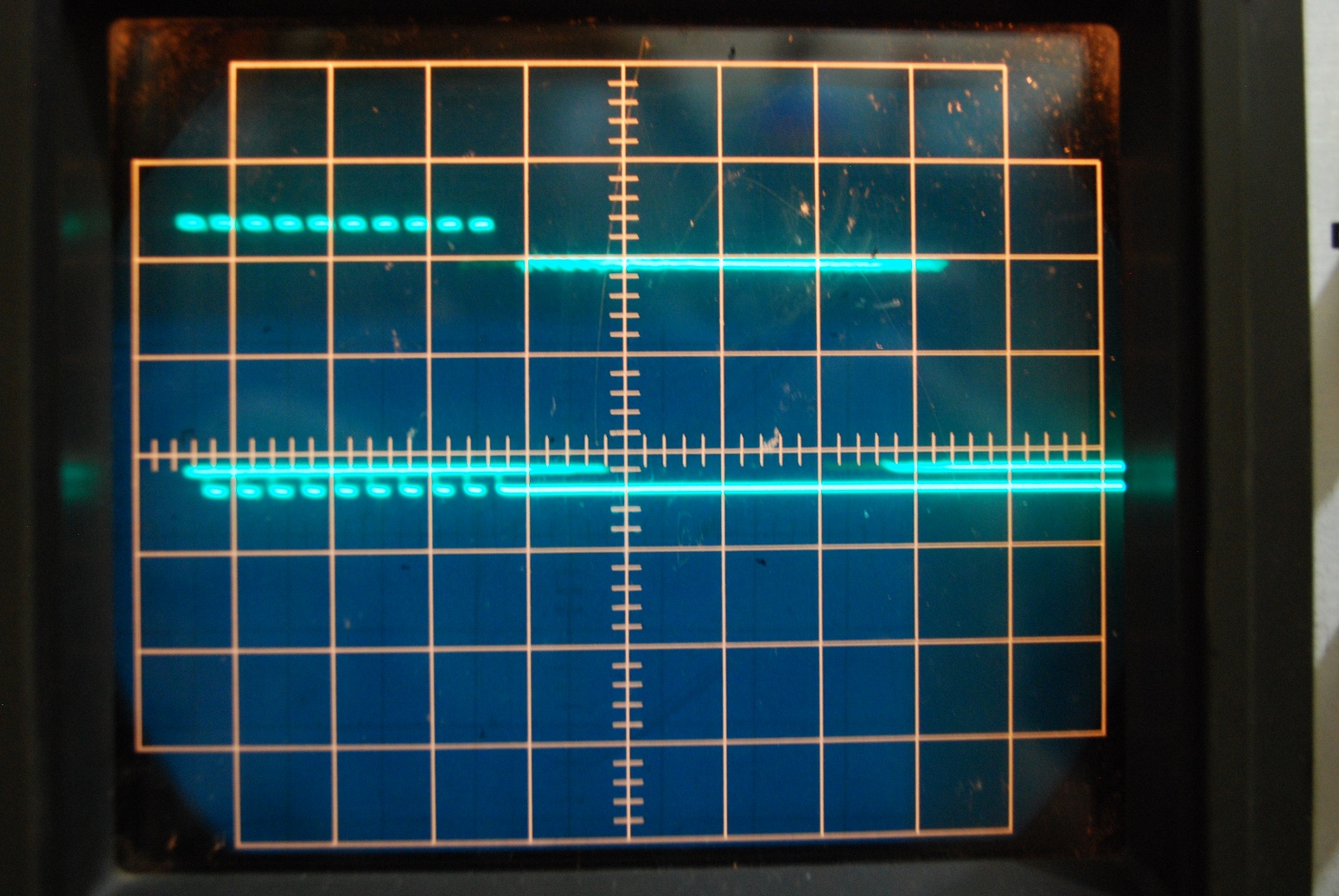

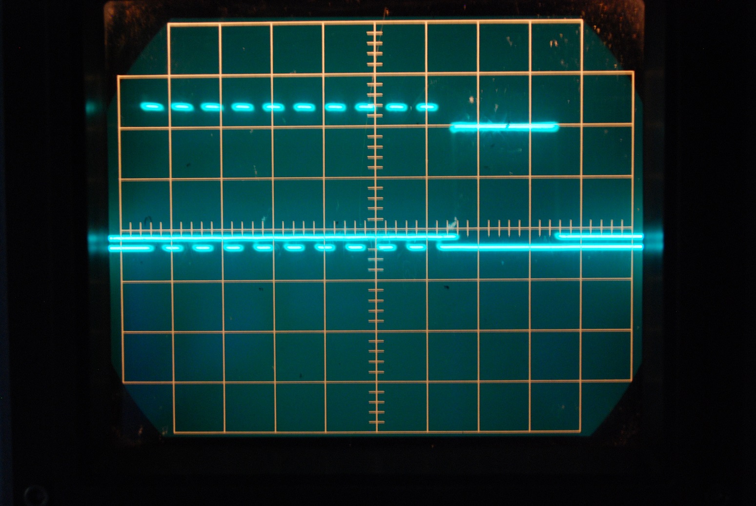

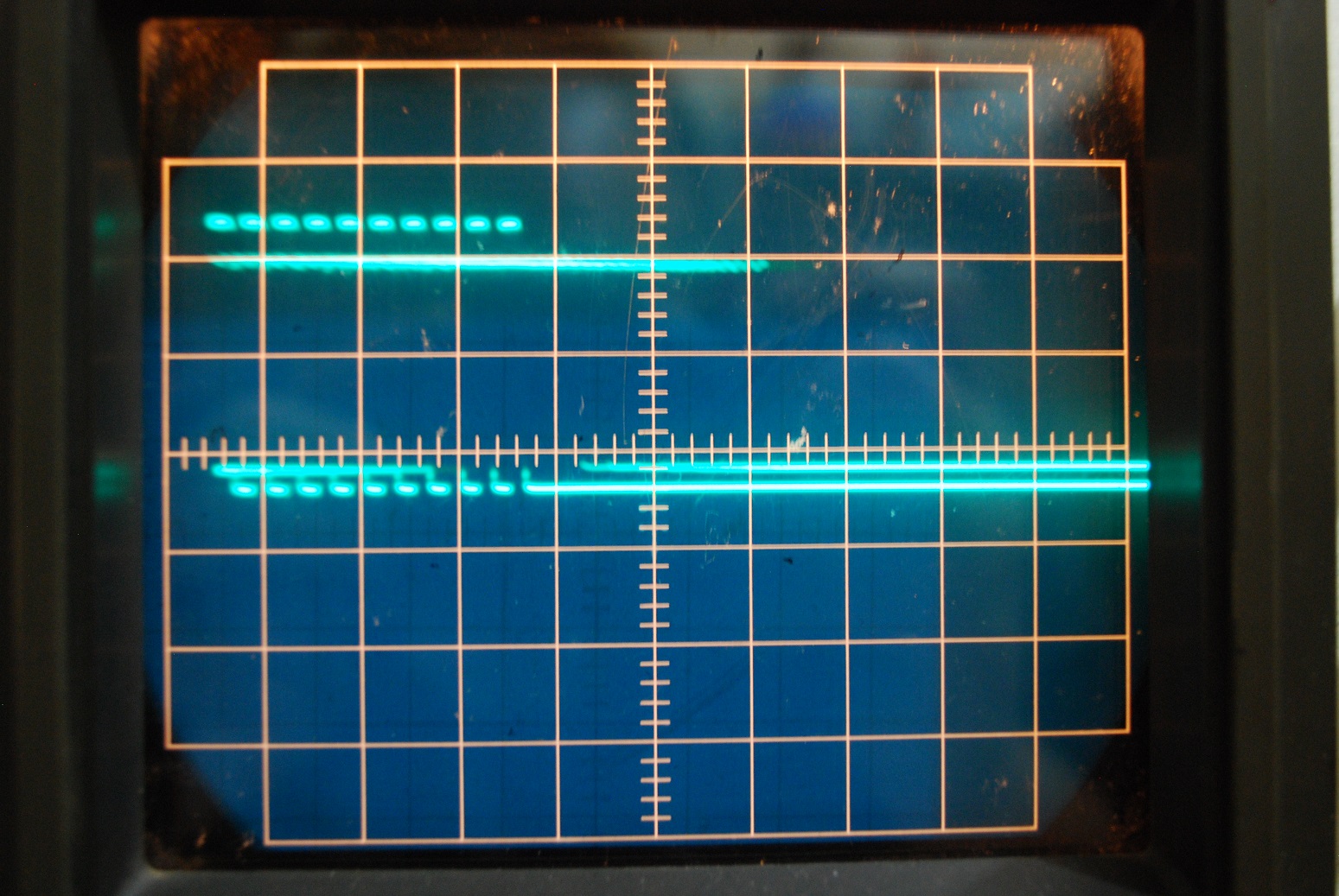

I have been attempting the Pulse Train to the Triac gate as suggested & am having issues with it due to not doing it correctly I would say.
Every time I get it close to the correct timing it becomes unstable, you can see the instability on the scope.
I have a picture of the Zero Cross Detector output & the Pulse to the MOC3021, is this what I am chasing although the timing is out which I am aware of.
Cheers
I can't tell much in terms of pulse width or instability.
With short pulse widths, you may have to increase the gate current. The average current will still be low.
Sorry about that I didn't word things correctly,
The picture was taken where things were stable just to see if I have the right idea.
I have taken some other pictures to show the instability, basically when there is a single pulse to the Triac the circuit is stable because the Zero Cross signal is stable & the circuit will adjust to 0V.
When I have a Pulse Train the Zero Cross signal jumps or jitters from left to right so much so that you can't set the circuit near 0V because of this instability & the Zero Cross signal jumps in & out of the trigger point intermittently triggering the Triac.
You will see this in the pictures.
The pulse widths are 10uS, I have tried increasing & decreasing the pulse widths but there is instability whenever there is a pulse train?
At this stage I am only writing digitalWrite high & low with a delay to create the pulse train & maybe this is the issue that I can't work out yet how to do this better?
Cheers

After a long day looking at this with novice eye balls I have found some solutions to the problem.
Like everything there has to be compromise, you fix one thing & it takes away from another & visa versa.
I boosted the gate current as suggested to the Triac & fitted a Diac in the circuit, maybe not needed but it did seem to help.
I now have 10 gate pulses, 5uS on 5uS off & it is stable, I have 0 = 0V but now 4V from the Potentiometer = 240V output.
If I adjust the Pulse width to say 10uS on & 10uS off then around 3V will be 240V output.
Is this acceptable ?
The Triac is firing nicely & it is stable, although the way I created the pulse train is very crude, but it works.
I tried a few different ways which would appear to be more professional but the instability was still there because basically I wouldn't have a damn clue at this stage?.
If all is well with this I will move onto the PID for the lamp but if not I will try again until it is right.
Long day & again I learnt how much I don't know!
Cheers
Go for it.
As for creating the pulse train, you could have used something like an "on timer" kind of construct at some rate, say 1 uS.
Then you do everything by counts.
Somewhere, you tell the "program to switch on triac or pulse.
So, the traic turns on and 10 interrupts later, the triac turns off, because your counting them.

Today instead of throwing in the towel like I felt like doing I decided to just try the PID using just a single pulse to the Triac gate & have come up with at least something, this may not be suitable either but it's a start.
Like I mentioned I just don't think the right way with all this & especially now.
I have attached a couple of screen shots of the Serial readout which shows the Setpoint Vs Thermocouple Input to see what you think?
I am not sure I have any of this correct even though I get some sort of results, to explain:
If I have the Setpoint at say "100" & the Input from the Thermocouple goes fractionally above this say 101, 102, the Lamp does not DIM smoothly to correct to the 100 Setpoint mark but instead it drops the power to the lamp very quickly & then back on very quickly making the lamp FLICKER to hold the Setpoint number.
I thought it should Dim the power smoothly up & down to hold the Setpoint figure.
It's more than likely my total misunderstanding of how to go about programming these damn things that is causing the issues?
Could you have a look at the sketch & tell me where I have gone wrong with things, If I have totally buggered up just say so, I can handle it!
I just wasn't born to be a programmer!
EDIT: I forgot to mention that the timing for the serial readout is every 500mS when you look at the pictures attached, you will see that in the sketch anyway.
Cheers

Hopefully, I can look at this later, but I have a few things for you to look at:
The graphs here https://en.wikipedia.org/wiki/PID_controller of the effects of P I and D.
and here: https://www.futuredesigncontrols.com/AutoTune Page.htm
You MAY have what you see in the red line or a non-optimally tuned PID, but I don;t think so. Unfortunately, your data doesn't include t=0. I do see it oscillating +-1 or 2 degrees, but then I don't see any fractional temperatures, so I don't initially think it could do much better. If your reading to 1 degree, how can you expect any better control? In reality, I think you did good. Does this make any sense? Both how fine, you can read the temperature, even if it isn't correct and the output % on resolution has an effect.
PID does have a habit of turning off the control if you overshoot.
The total picture requires: time, setpoint, measured value and Pout(%) including both a step change and steady state. So, these are my initial thoughts.
