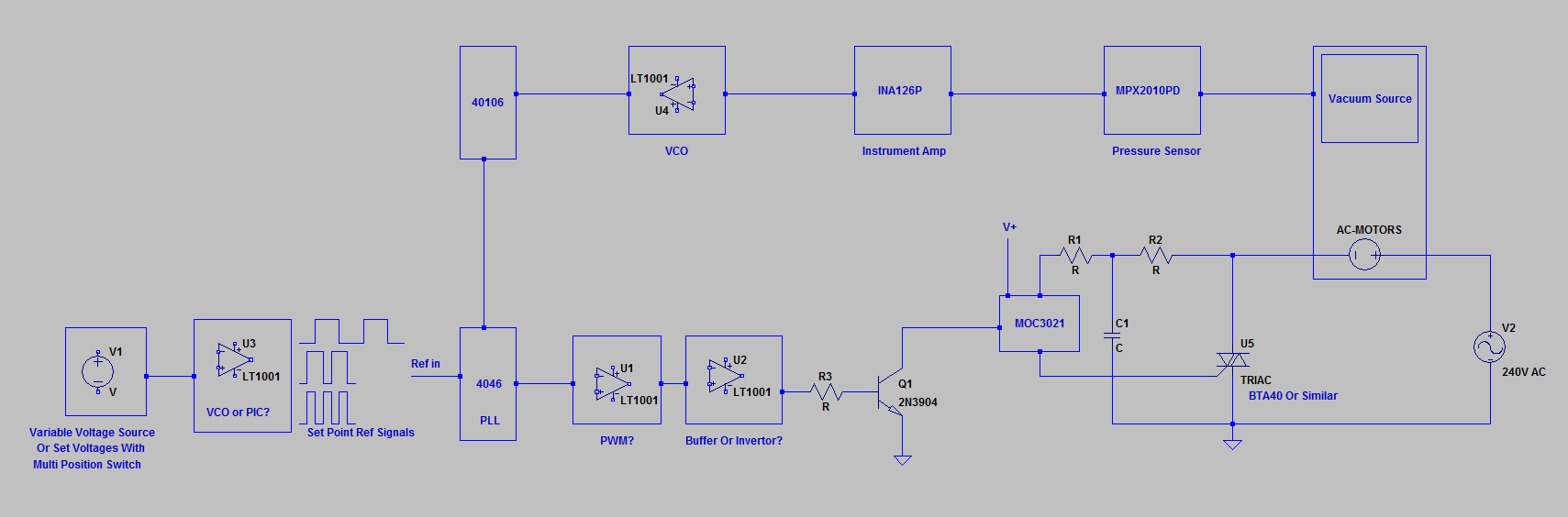

I have roughly put my idea to a drawing- Attached, sort of hoping I don't embarrass myself to much?
The mention of not having set points & having to move dials etc made me think a little differently about the control unit.
Like mentioned I would like to give it a go if you think it's ok & with some assistance along the way.
Here's hoping?
Cheers

Kiss,
I had a read of the link you provided.
Is the fault in my Triac circuit due to the fact that it will be randomly firing the Triac instead of it firing at the beginning of each half cycle, zero crossing, synchronised?
Cheers
If your randomly firing, your shooting after a moving target - not controlling. Ideally for the same input, you would like the same average voltage over one half cycle at least.
With an inductive load, there is a phase shift and a triac turns off at both zero voltage and ZERO current. Hence, if you trigger some degree after, the zero cross, it turns off at some other, possibly random, zero current cross.
Zero voltage switching eliminates RFI. Random firing is USUALLY used to turn on an inductive load when turning it on to stay. At v(0 degrees) you can have substantial current and that's the general reason to be able to current limit.
So, it would be NICE to trigger so that some average voltage would be produced. e.g. An average Voltage vs firing angle table or lets call it % mains. So, if my setpoint was 50% the RMS mains voltage, that's what I would get. We would assume that the load is predictable. The key is predictable and repeatable, not exact.
In actuality, a Tungsten load requires tweaking as well because cold resistance is like 10-15x less than the hot resistance.
The TE10A **broken link removed** from Eurotherm is an example of such a controller. It states that the input is proportional to the RMS voltage squared and will compensate for up to +-10% of supply variations. P=(V^2)/R. Your vacuum might be more proportional to motor speed.

Hi again,
We talked about phase control of the triac already and stated that you should not use variable phase control for the traic if you are using an AC motor. That should really only be used for motors with brushes. If your motor does have brushes then maybe it's ok, but a question that comes up is do you really need sub cycle control? It's doubtful because the line goes through zero either every 8.33ms or every 10ms, which is not that long anyway.
The triac can be fired anytime after the zero crossing and yes it will turn off when the CURRENT goes though zero the next time. You have to be careful though that you dont trigger with a delay longer than 1/2 cycle though or else you'll end up with half wave rectification and that's not good. But if you just turn on at the zero crossing and then turn off anytime after that, the motor will probably be ok, so you probably dont need sub cycle phase angle firing.
What's the PLL for, and why is the starter circuit so complex, is that for sub cycle phase angle control? If so, it's still much too complex.
willeng said:
I understand now that you can basically turn the Triac on anywhere in the half cycle after zero crossing for example 90deg & 270deg & it will turn off when the current is near or at 0 Amps until fired again in the next half cycle.
True for a RESISTIVE load only. The triac will turn off at zero volts and zero current which may not occur at the same time with an inductive load.
Maybe I have an Ahha moment. You said you had a universal motor, so why not use PWM and DC?
I think before we worry about using PWM or not we should learn whether or not the application really needs that knid of accuracy. From the original posts it sounds like a simple on/off control would be good enough, but of course i'll wait for more info. Also, dont forget that PWM can come in the form of on for 10us and off for 10us, or on for 10 minutes and off for ten minutes. The former would require sub cycle phase control, while the latter would just require turning the triac on and off.

Yes I understand about current lag in inductive loads, power factor etc.
My original thought was to rectify the mains hence the PWM on the circuit I proposed with the ? next to it, I thought I would just use suitable Mosfets to deliver the DC power to the motors, DC will have Tighter control.
I am still working on the phase control for the Triac circuit.
I understand that I can buy a Process Controller etc but I am not going to learn anything that way, I have need for several things that I want to control so now is the time to learn.
Cheers
The LAG you may understand, but you missed the turn off at zero voltage and zero current which may not be co-incident.
Rectifying the mains won;t necessarily work. You would need 240 VDC with no losses. Your vacuum motors are what HP?
Not sure if regulating voltage squared or voltage would be better.
I can walk you through writing a PID controller on any processor that supports floating point. I just haven't done autotune, The PID loop is nothing more than numerical integration and differentiation.
A auto-tuning process controller, I think is your best option. 1st job find one. Next interface it to read pressure in engineering units. You may or may not need an isolated output.
Well, probably a transformer would be involved to get 240 ish VDC. The good part; is it's easy. I've used this https://www.jameco.com/webapp/wcs/stores/servlet/Product_10001_10001_120539_-1 guy before, so most of the work is done for you.
Now, the triac thing, probably best done with a microprocessor. But would you want to do it with a look-up table without a processor. A/D creates a index to a look-up table for the phase angle of some average voltage, 0-5 is say 0-100% (0-511). Look up value of phase angle or maybe it's a digital divider. That's where you would start firing and you would continue this until the voltage went to zero again.
Even though we might look at it as 0-100% to a phase angle, the "phase angle" could be a time base divider.
