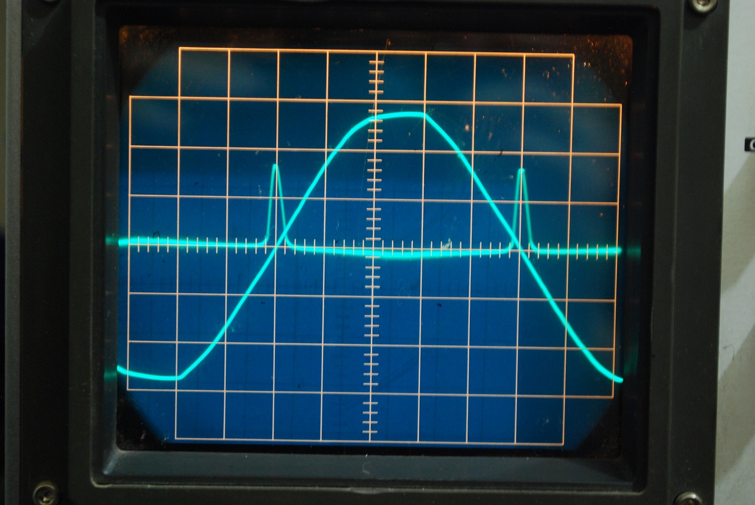

I made up the circuit I posted before & just tested the Zero Crossing Detector section of the circuit first, if the Arduino is set to detect the falling edge is this close enough or good enough?
It's not to bad I think for my first attempt but others may see issues I am unaware of.
Should the signal be squarer or is this ok?
Sorry about the picture quality?
Cheers

The picture quality is great.
The triac control code attempts to compensate for the shift or should I say, shift empirically determined. e.g Figure out the best you can the amount of time the peak as to be shifted to put the peak at the zero cross. I think the code uses like 150-200 uS.
The signal probably isn't good enough for an "edge trigger", but it's probably OK for rising. It depends on the Arduino. It can always be squared up with a Schmidt trigger,
You can look at the trailing edge as you suggested or you can look at the rising edge and delay and that's probably what the code does. Basically subtracts out the shift from the timing. So, if the real trigger was 1000 uS for 10%, it would use say 850, because 150 has already passed. Whatever is chosen, there should be enough slop to say the zero cross has reliably occurred.

I noticed on the scope that the zero cross circuit output to the Arduino was distorted so I combined a Schmitt trigger into the circuit, it now has a nice signal which I thought would help but no luck or improvement there at all.
