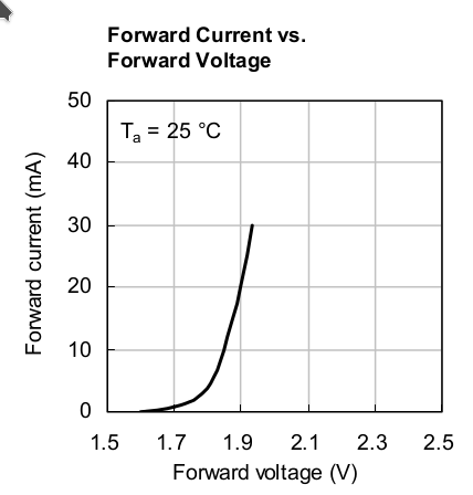

Background: I have esp32 s3 starter kit. Red Led’s etc.
I am not able to find any data sheet on exactly wtf my Led’s are specd at.
Google, my friend… said “2V @ .020A” and I saw the graphs. I finally was able to test it on a better DMM and found basically 2V fwd. voltage. My Centech-Child’s First DMM seems more aimed at regular diodes perhaps.
My issue is understanding why I keep getting 4 or 5mA as current draw vs 20mA. I did 3.3V off the esp32, used a 220 Ohm resistor and get 5mA.
I figured if I set my little Alientek powersupply to 2V and see what current it draws, that Id also get the fwd current that way… sure enough it’s like 3, or 4’ish mA there.
I guess I also wonder why it’s not 5mA on power supply. Why is current different LED alone vs. in the circuit w resistor.
Perhaps I am not understanding current draw in circuits fully yet? Or,
Is the answer simply Ive acquired LEDs that have a different “V to I” graph then the one touted online (2V @ 20mA)?

The figure you see quoted in datasheets is the maximum continous current the LED is rated to withstand without failing. The LED is powerless to change the current you put though it. That current is set by the series resistor you put in series with the LED.
Here's an easy way to think about it. It is somewhat simplified but acceptable if you're just starting out. Assume the LED always drops 2V. If your supply voltage (or digital I/O voltage) is 3.3v, that leaves 1.3v for the resistor. If you use a 220 ohm resistor, you will get 1.3/220 = 5.9mA. If you want 20mA (the max current the LED is rated for), you will need a resistor that passes 20mA when the voltage across it is 1.3 volts. R = V/I = 1.3 / 0.02 = 65 ohms.
In practice you want to be on the safe side and not exceed the max current rating of the LED, so round up to the nearest standard value. You can choose 68 ohms, but I would go for 82 ohms to be safe. Also, in my experience standard 5mm LEDs do not get significantly brighter as seen by the human eye above 10mA so I usually go for 5mA - 10mA on my indicator LEDs.
Also, in reality the LED will drop slightly more voltage at higher currents. I've attached the datasheet for an RGB LED as an example. The graph below is for the red colored LED. Although the voltage changes slighlty with forward current, it is always very close to 2v (I usually use 1.8v for my calculations) so you can just assume it will be 2v or whatever. If you open the datasheet you will see that LEDs with different wavelengths (colours) drop different voltages.
