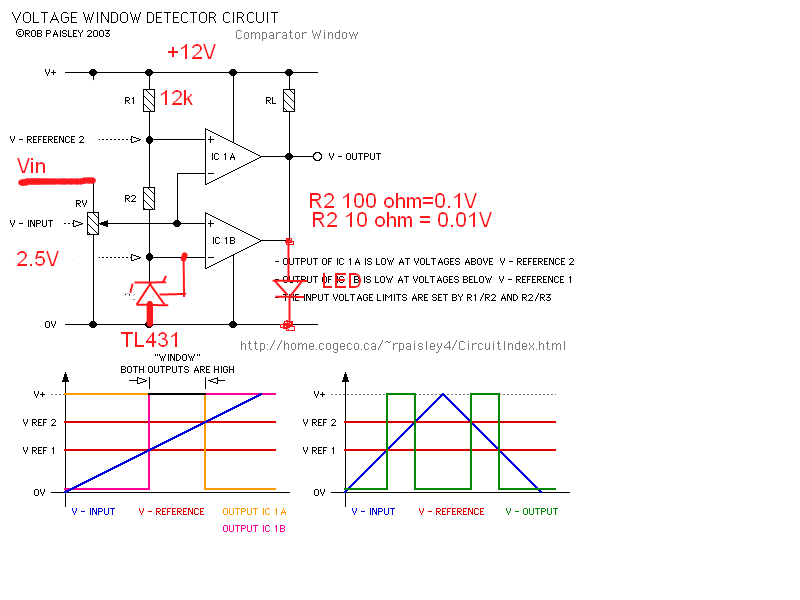

I require a circuit that switches an LED on at a pre-set voltage & off again if the voltage falls or rises above this this pre-set value.
I thought of using a peak detector circuit which will switch on at the desired value & off again if it falls below this value but I am not sure if this can be configured to go off again if the value rises above the pre-set value?
I would like the circuit to work in a very narrow band & to be fairly precise.
Could someone advise me as to what circuit I require to achieve this?
Basically I am using a differential pressure sensor connected to an instrument amplifier circuit & I want to switch the LED on at the pre-set Pressure & off if the Pressure is above or below this value.

What you are looking for is a comparator, most often implemented using an operational amplifier. The values of R1 and R2 determine the voltage level at which it switches its output.
Depending on your sensor, though, you may need a preamp, but the above is the basic circuit you'll want to use.

Sorry for the double post, but doesn't a comparator circuit work like a peak detector where it will just turn on when the input is greater than the reference signal & stay on until the input drops below the reference signal.
In other words it will not turn off if the input signal is greater than the reference signal. I need to switch on when the input signal matches the reference signal & off if the input is Above or Below the reference signal.

Ah, I see what you're saying. What you want, then, is a window comparator (it turns on the output only for a small "window", or range of voltages).
Here's the basic circuit, along with some graphs (pulled from Google):
When the input voltage is between the two reference voltages, the output will go high. Once the voltage drops below the reference "window" or rises above it, the output will go low.

R2 sets the V ref1 to V ref2 difference.
A TL431 is a good reference. 2.5V 2.5% or 1%
RL sets the LED current. If the output is low it shorts out the LED and no light. If the output is high then RL powers the LED.

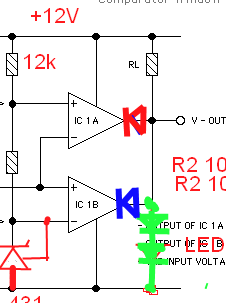

I think your "good" window is so small it will be hard to hit. You don't have a way to know if you are too high or low.
The RED LED is on when the voltage is too high.
The BLUE LED is on when the voltage is too low.
The two GREEN LEDs are on when the voltage is just right. (must use 2 LEDs)
You can also always widen the window to, say, 2 volts--1 volt above or 1 volt below (11-13v). You could even use a window of 1V, and have .5v high or low, depending on how precise you're expecting the input to be.

Thanks everyone for the additional information & yes Ron your correct with not knowing if I am above or below the desired setting, the idea with the coloured LEDs is a good one & obviously something I never thought of.
I have been simulating some circuits on Ltspice & realised myself that the window is far to tight considering the manual adjustments that are required to get the correct "Vacuum Pressure" from my machine.
