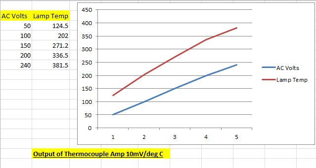

I did an AC Voltage to Lamp Temp test just to see if it was linear, see attachment. It's difficult to get exact readings on this as the mains variation seems to play havoc with the temp readings, frustrating.
My Thermocouple Amplifiers output is 10mV/ deg C

I don't think I have ever seen mains variations like that. Any possibility your having issues at home and didn't know it until now? Could this be affecting your current vacuum setup?
PID would probably give the same sort of oscillating behavior unless there is supply correction within the triac controller.
If you up to it, check the mains before the main breaker for the property and determine if it's a utility issue. I'll assume the your electrical has the 240 secondary with one end grounded which is different than the US. Check N to ground voltage as well.

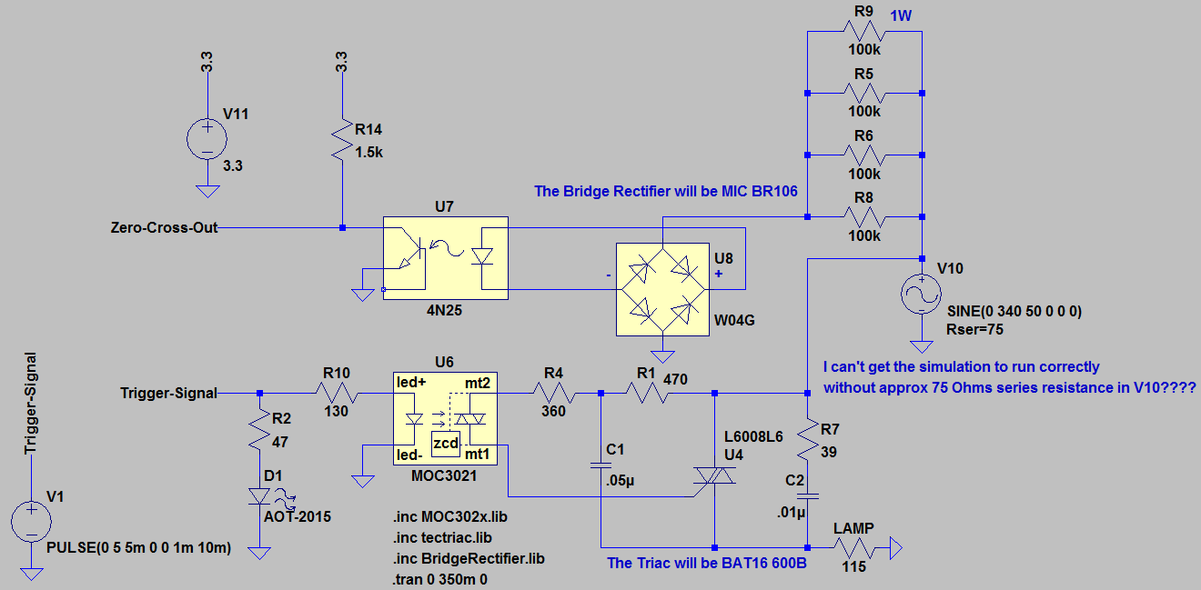

Sorry for the delay but I have been reading up on many things trying to get a better understanding of what's involved to do the job correctly.
I like to do things correctly if I am able so could someone have a look at my new circuit & let me know if there are any issues with it before I build it.
I want to control this lamp properly although I think the time constant for cooling of the glass may be a little slow, I may be wrong & still want to try though, it will be an excellent start.
If the circuit is ok I will use it for the PID testing.
For the Anode pin of the MOC3021 & the LED I have had to adjust the resistors to suit the Simulation to get the required current input.
The Formula I used for the 4N25 & the MOC3021 was:
R = (V-VF)/IF, is this correct. If so I will use the right values on the circuit.
Cheers

Yes, the formula you used is correct.

When doing an experiment like this I believe you also need to consider the time constant of the thermocouple. How fast the thermocouple responds to change.
Ron
Thanks Reloadron,
Yes there are a few things to consider, it's a steep learning curve for me but it is very interesting.
Any idea why I had to use around 75 Ohm series resistance to V10 in the simulation to get it to work correctly??
Cheers
So, something like 1 or zero ohms didn't work?

I am just making up a proper circuit board now so things are safe.
Yes I tried very small resistances in the simulation but the output was erratic????
