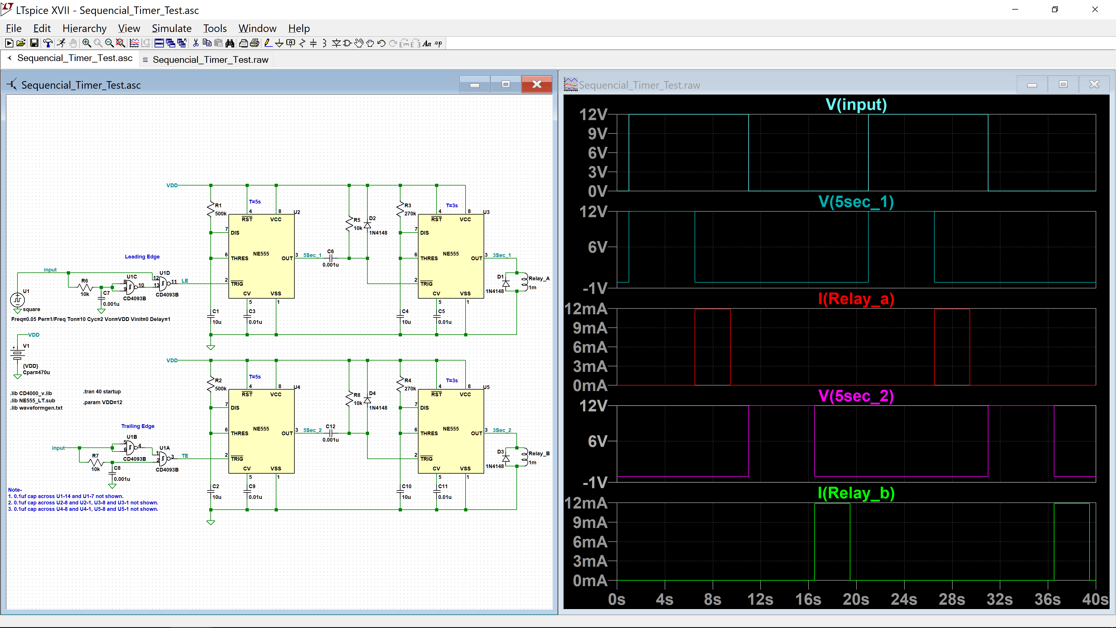

For this circuit, when the signal goes from 0V to 5V, there should first be a delay of 5 seconds. Then Relay_A must be switched ON for just 3 seconds.
Then when the 5V later goes to 0V, there should again be a 5 second delay, and then Relay_B should be switched on for 3 seconds only.
Its achieved by the attached, though can you think of a lesser_component way?
(PDF schem and Ltspice sim attached)

Here is a version that uses two edge detectors(one CD4093B) and four 555 timers (or two 556 timers). See Below.

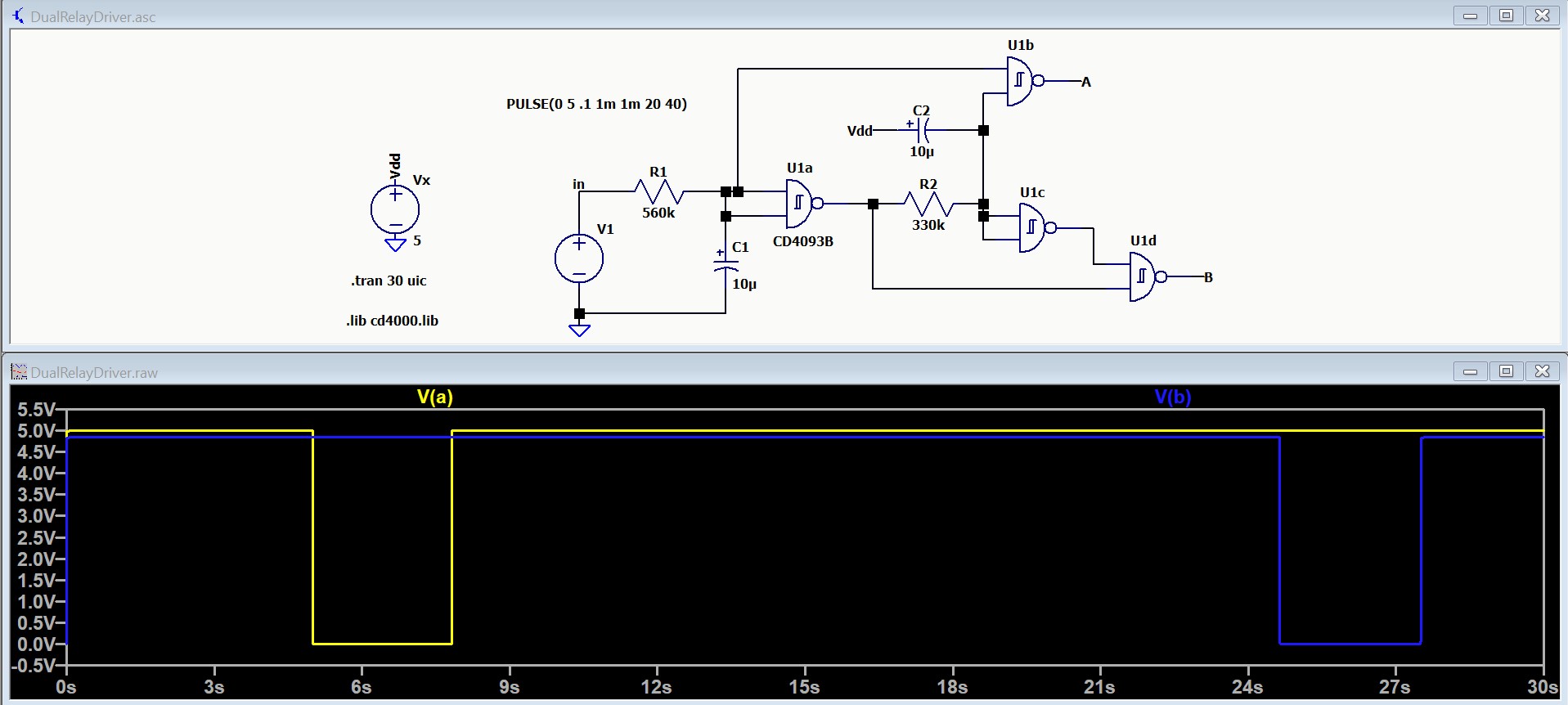

If only you could guarantee that the signal would stay high (or low) for ~20 secs then you could get away with a much simpler circuit :-
(That 20s is to allow the caps to charge/discharge fully.)

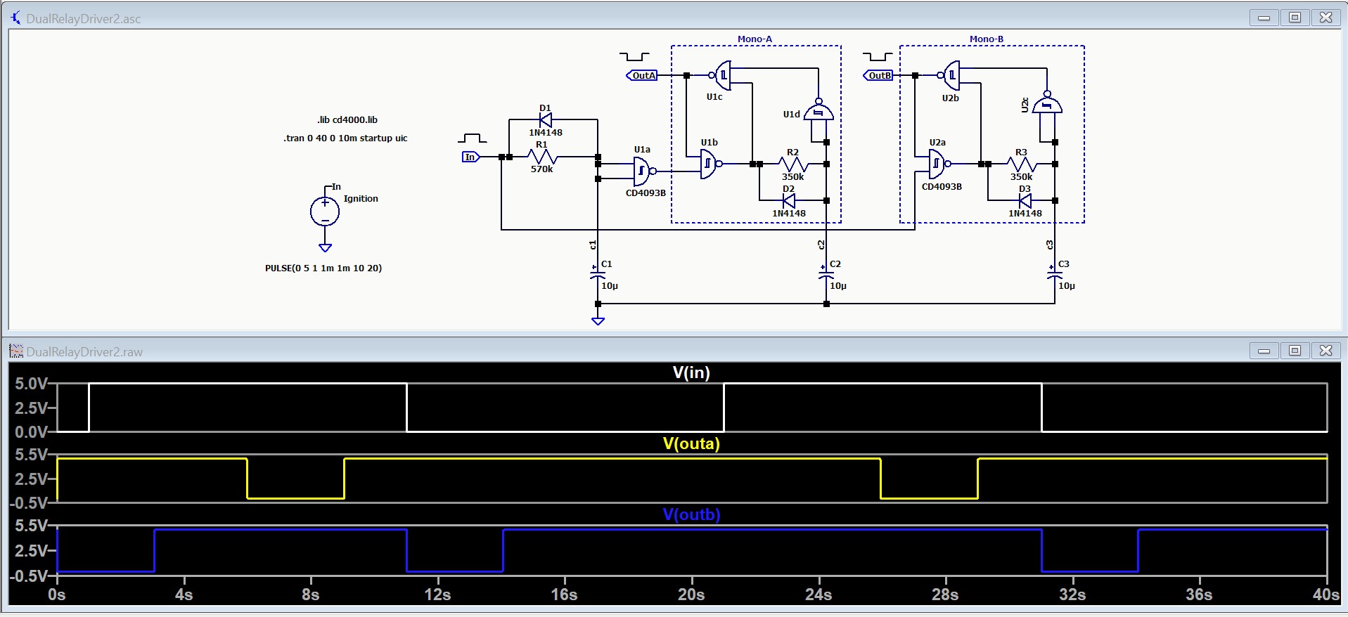

With those latest conditions I think the attached would be a simplified basis for the control logic (but need PFETs for driving the relays).
The 5 sec timer (R1,C1,U1a) only runs for the 'A' relay.
A couple of 4093 ICs are configured as two 3-sec timer monostables :-

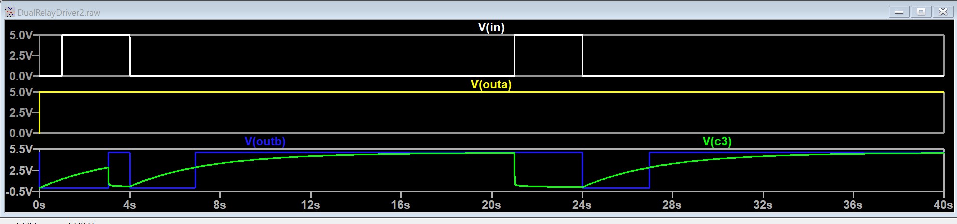

The above waveforms are for the situation where the ignition stays on for at least 5 sec. If the ignition were switched off after only 3 sec the waveforms would be as below, with no drive for the 'A' (mirror extend) relay.
In this situation the mirrors would already be fully retracted and it is assumed that a limit switch could be used to prevent actuation of relay 'B' if necessary.
