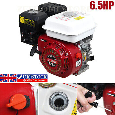

You can get a new clone of a Honda GX series engine on ebay for less that £100.

Many thanks for your response, seems like a plan. £99.99 is well worth the price.
So utilising what I already have but have not used and coupling it onto the following
  • Drive Shaft Diameter: 20mm / 0.786inch
  • Length of Drive Shaft :50mm/1.97inch
  • Keyway Diameter: 4.8mm
Also, I have just noticed "Engine rotation Anti clockwise"
What size O.D. pulley wheel do I need I will then couple up to my three terminal alternator this is to get the correct ratio to speed correct. I then need somehow to get to my inverter
Looking at the typical speed range of that series of engines, probably somewhere around the same diameter as a car crankshaft pulley, or a bit smaller; in the 4" to 6" range at a guess?

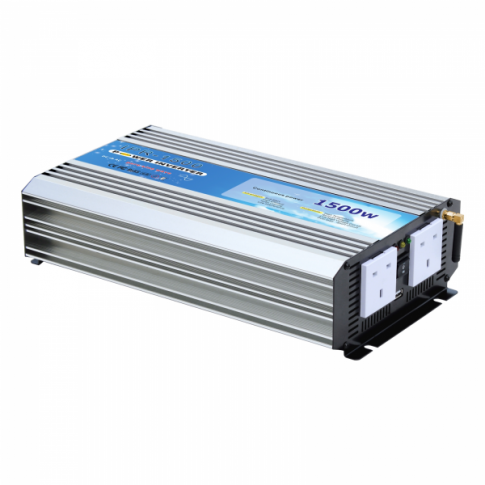

This is exactly what I want “Photonic Universe – 1500W 12V Pure Sine Wave Power Inverter”
This does away with the consumer unit which is an added expense.

It looks like we have my problem sorted at last
