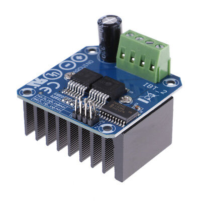

As long as the voltage is not too high, you could use BTS7960 half bridge driver ICs or full bridge modules - they are rated at 43A.
These modules with two ICs to make a full bridge are readily available from various places:
Jut be aware that a common diagram for these shows them with a built-in 5V regulator.. The typical modules do not have that, the logic supply pin is an input & you need an external 5V or 3.3V supply.
