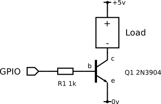

Are you trying to do the attached photo? I don't see why you need a 50ohm resistor to begin with.
If so, you could use a PNP or a P-channel MOS on the high-side rather than an NPN or N-channel on the low side so the switch voltage drop doesn't disrupt the ground. Disrupting ground could cause issues in some cases (radio modules could be particularly picky).

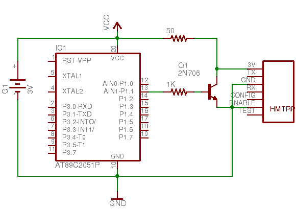

Ok I'm adding a circuit because at least somebody is confused:
As you can see, the microcontroller is powered with 3V.
For the purposes of my question, the details of the internal functionality of the micro as well as the wireless data content are irrelevant.
What is known is that one pin of the microcontroller will be made as output and will control when the entire radio module goes on and off.
Yes I am completely aware than an enable input exists as well but because the radio module gives me bad luck (I suspect someone programmed it wrong), I'm going to use every line of that radio module available to me including the power pin.
In this circuit I will be able to turn the module on and off, but the problem is that this circuit wastes alot of current when the microcontroller turns the power to the module off especially with the 50 ohm collector resistor.
If I remember transistor operation, then when the pin feeding the base goes high, then current goes from collector to emitter which means the 50 ohm resistor is connected from VCC to ground which means 3/50ths of an amp of current is wasted for nothing. I want to avoid wasting this current.
Any way I can pull it off? I'm not sure if totem pole could help here. hmm..
Well there's your problem. You never don't short across the power pins of something to shut it off. You interrupt the current. Do something more akin to what I showed in my previous post where the switch is in series with the thing you want to power down.
99.999% of the time, never short across the power pins of something to shut it down.
My circuit shows no short. I'm just illustrating that VCC is 3V battery +ve (same connection) and GND is the other end of the battery.
I looked at your previous post and based on it, you're suggesting I should connect all VCC's together and all grounds of the module to NPN collector? I mean its an idea but would enough power get into the module? I'm asking for the datasheet limit of 120mA so the module functions normally when on.

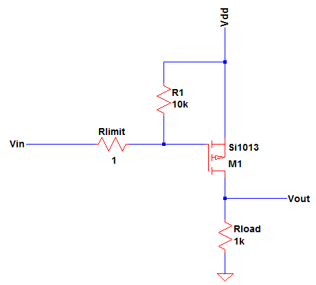

That said, are you really using a 2N706 transistor? That transistor caps out (saturates) at 30mA. Use a different transistor that doesn't saturate at 120mA.
However, what I actually recommend you to do is to use a high-side P-channel MOS or PNP switch so that the transistor is not in the ground path of the module which could cause issues (like noise or maybe worse for something sensitive like a radio module).
See attached schematic. The resistors are different values of you use a PNP instead of a P-ch but you get the idea. In the PNP/P-ch case, pulling the base/gate LO allows current to flow and turns everything ON while pulling the base/gate HI turns everything OFF.
You can omit R1 if you wish since it's just a pull-up resistor to keep everything off in the absence of a base/gate control signal. The base/gate resistor optional if you are using a PMOSFET, but required if you are using a PNP (obviously don't use 1 ohm for the PNP).
In your schematic, your transistor is connected across the 3.3V and GND pin of the power supply pin. So when the transistor turns on, the module turns off because the transistor starts conducting and produces a short-circuit across the power pins of the module making 0V appear across it. But as you've discovered, it consumes a lot of power because current is essentially flowing directly from the 3.3V rail straight to ground necessistating the 50 ohm resistor.
