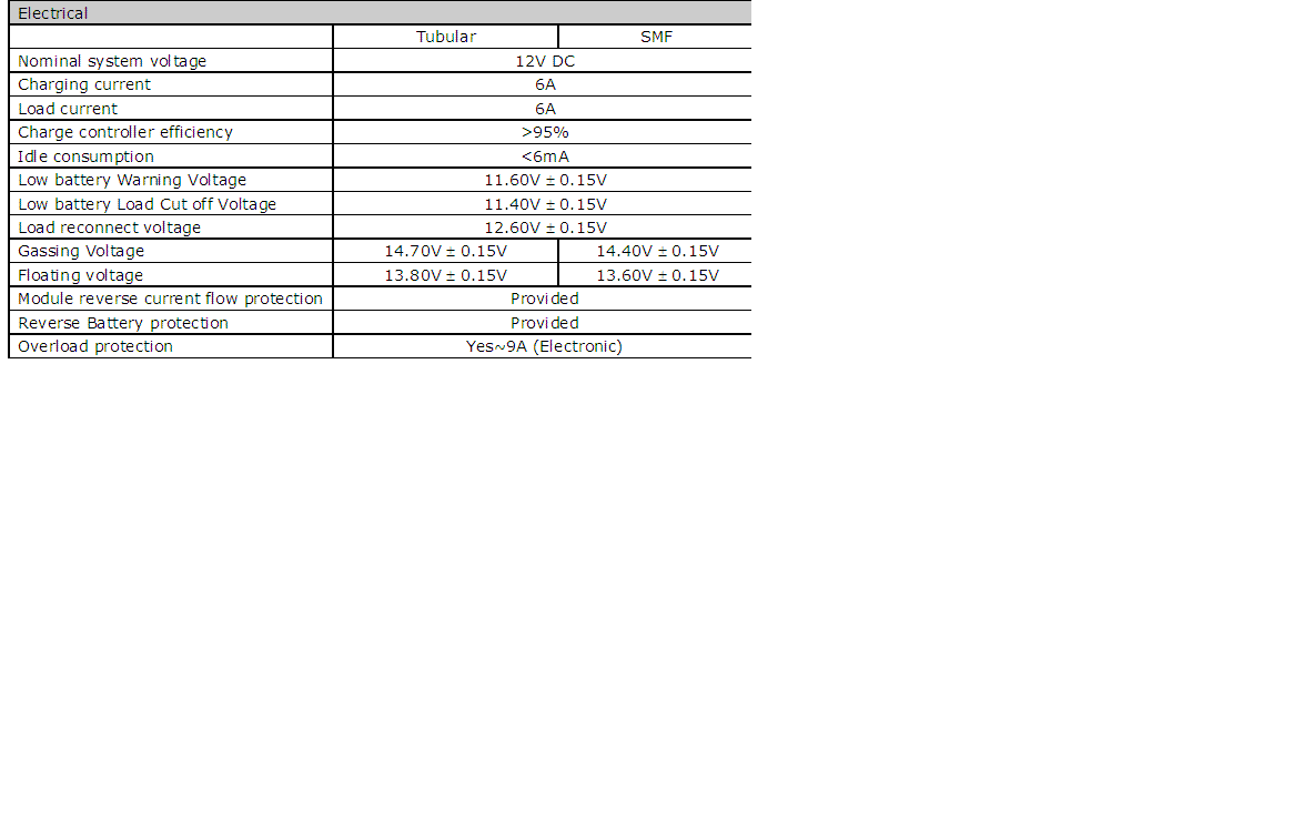

Charge Control Unit
For a project using solar panel my load is 600mA at 12V. I use a 75W solar panel as suggested by the panel supplier and a 6A CCU with the attached specs. I prefer the DC voltage to be 12V+0 -1V. Can anybody please suggest a good method.
A lot of missing information:
How long do you want to operate on battery and at what duty cycle
How long do you have to charge the battery
Do you expect it to fully charge on a cloudy day
how far from the equator you are and what time of year (relates to how long it takes to charge. I know you are in India, just pointing out variables )
Dan
Dan
I think I couldn't convey my question clearly. The load point seems to be now directly connected to the battery with a high and low limit and cut off. So it may vary from 11.5V to 15V or so. I want this to be regulated. Probably a DC-DC converter may take care of this. I wanted to have the opinion of other experienced people.
Regarding your other questions, those parts are taken care of the supplier who supplied me the solar panel, CCU and battery. My requirement now is to get regulated DC from the unregulated DC. Hope it is clear now.
