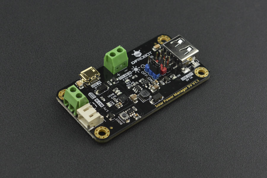

Solar Lithium management system :
Regards, Dana.
For lithium, you would need a two cell combined protection and balance module connected between the cells and everything else. Do not use internally protected cells with those.
Bear in mind, this is NOT a charging circuit, you still need a properly designed Li-Ion charger as well as the protection circuit.
