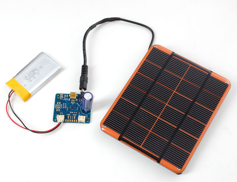

Take a look at these :

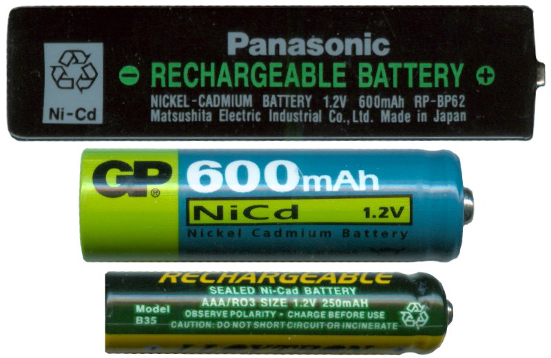

Exactly - however, 'years' might be optimistic (or at least many of them), as NiCd and NiMh tend to be relatively short lived.
