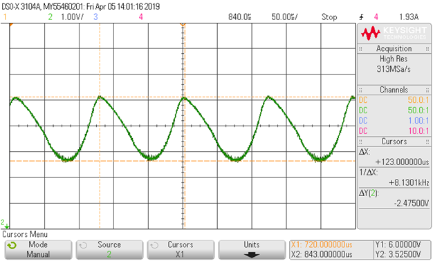

It is working fine in open loop, but in closed loop I am getting a ripple in output Voltage of 2.5Volts Peak to peak.
Voltage waveform is given below:

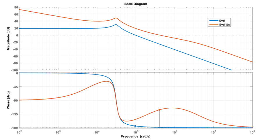

I have designed controller considering settling time and load disturbance rejection. Here is the bode plot of my plant Gvd(s) and my plant+Controller.
What should I do to reduce the ripple in output voltage.

Looks like you have a power 8khz oscillator.
First I would slow down your error amp by 10:1 just to see if that stops the 8khz. (C23, C4, maybe C38)

Adding another cap and resistor in parallel to C24 would flatten the resonant bump in your response curve.

Shadow_Warrior,
You know what a phase shift oscillator is:
Your power amplifier (PWM), then the LC filter, and the phase delay and gain in the error amplifier all combine to make a oscillator. Much like the "feedback loop" in the oscillator above.
Look at the attached circuit. If you change one of the "RC" time constants the think will stop oscillating. If you reduce the gain at the oscillation frequency it will stop oscillating.

To rephrase Crrisp58, if you were to build the circuit then do the bode plot, the bump in in the graph would not be pronounced, due to the Esr of the 47u cap.
And my comment in #3 is valid when you need a large value cap and therefore low esr (hi Q and oscillation likely), by adding a resistance in series with another cap to damp things out.
If the Lc peak is really sharp this is effective.

Your error amp needs to have much gain at DC. It has too much gain and probably the wrong phase shift at 8khz.
yes you were correct, there is no ripple after I reduced the gain but I want my gain to be large because of the undershoot specification .

Whats the Esr of C24, and the primary inductance of Tx3.
I'll do some calcs on my spreadsheet with these.
Something is way off.
I simulated your power stage and I get a resonance at 1.5khz.
One thing I tried, I placed a 470u cap with 2 ohms in series across C24, it flattens out the peak nicely.

Thank you dr pepper .
The ripple in the output voltage is reduced significantly at full load(2A current) condition but at half load i.e. 1Amps current the ripple is high(around 500mVolts). The desired output is achieved but the efficiency has reduced. The ripple should not have come at the first place itself if the controller was good. Am i doing something wrong in designing controller.
Yes.
I'd say something wrong with compensation.
There will be a phase shift around the 8khz oscillation frequency.
This could be in the power stage, or maybe your compensation is way off.
One way to know whats going on with the plant is to simulate it, and place a swept frequency source in the feedback loop, then you'll get the frequency and phase response of the entire system, the problem should stand out.
