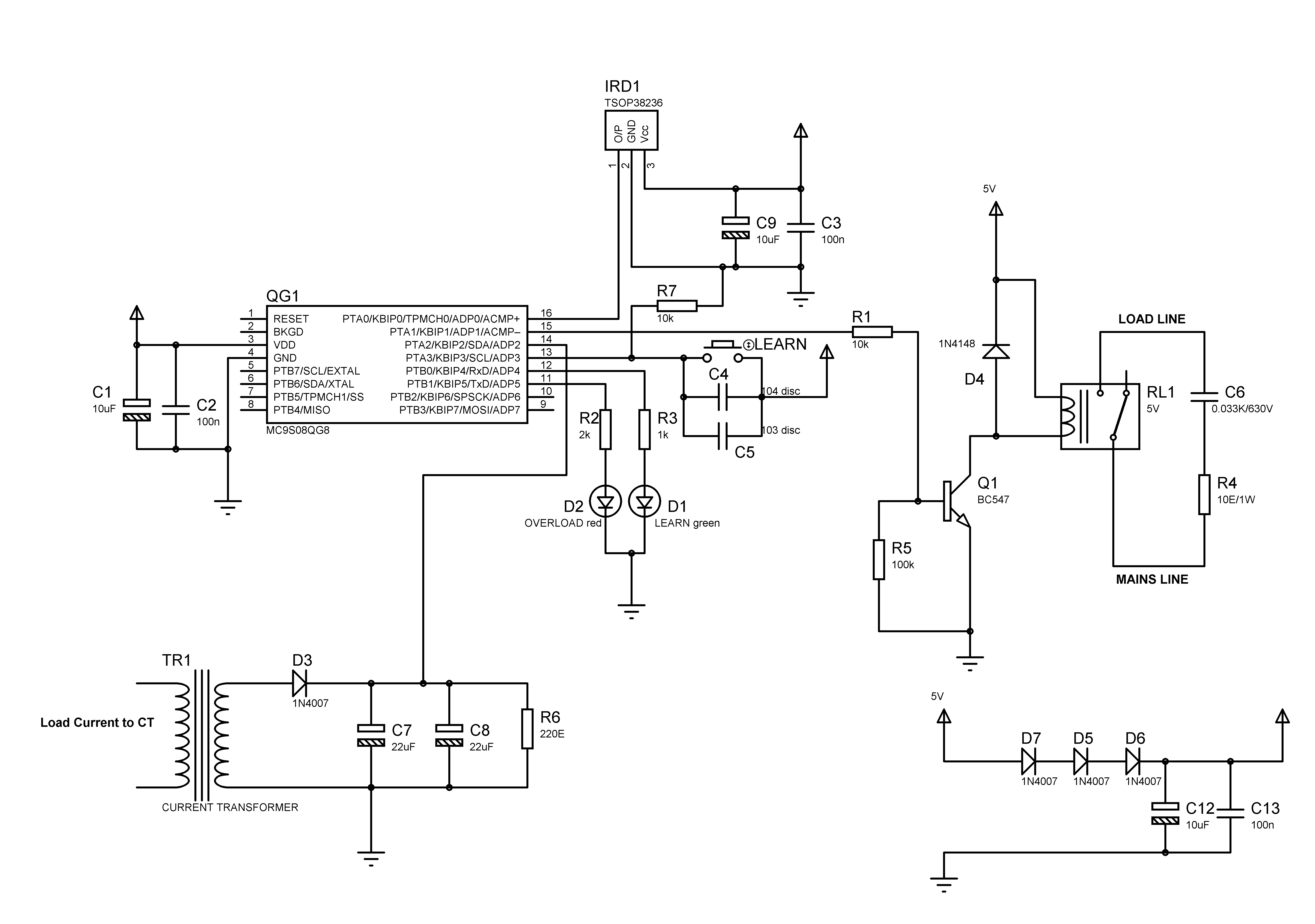

I am driving an electromagnetic relay from a microcontroller pin (through a transistor switch)
When no load is across the Relay contact,the circuit works fine.
When some load (230V Incandescent lamp) is connected and the relay is turned on,my microcontroller jumps to unknown routines.
I tried to suppress the switching noise with help of a 0.1µF/630V in series with various resistors (5 ohms to 330 ohms) across the contacts ,but that doesn't work.
I tried an MOV 30V across the contacts but that seems to pass the current through.
Please suggest something .

How is the MCU powered, mains/battery etc and what decoupling do you have on the MCU power lines also does the MCU have any floating input pins.?
Hello thanks for reading and replying..much appreciated:)
The Neutral is not common with ground for the moment (but yes that is the plan later)
Currently I am running all the electronics from a 12V battery.
5V for the relay coil is got through 7805 and i further drop this voltage to 3.6V for the microcontrolelr.
No matter how i filter the contacts or the electronics,this problem is sustained.
I have put 0.1µf ceramic disc across the freewheel diode(1N4148),filtered(1microfarad) the Vcc of micro.And the snubbers as described earlier.
I CANNOT distance the micro from the Relay.(small form factor ckt)
Please help me out!!!

On the 5V and 3.3V supplies you should have at least one 100nF cap located near to the PIC supply pins as possible also at least a 47uF cap on both these supplies.
Especially the 5V which is powering the relay coil. I know that the relay [without the lamp connected] dosnt reset the PIC, but any noise on this rail could be 'added' to any noise due to switching the lamp and be sufficient to reset the PIC.
How do you have the PIC's 'MCLR' pin wired.???

I am using MC9S08QG8
Its got a BKGD pin which is used to program the flash which is as close to MCLR that i can think of.Rest you can find in the link above.

I seem to have solved it :D
A snubber of 10 ohms + 330nf was connected across the contacts and a small 103 disc at a keyboard input on the board did it.
At least i can switch on the load any number of times for now..Lets see if it misbehaves in a while..

People have been using micro controllers to switch relays for a very long time with little to no problems if everything is bypassed properly. Can you post a schematic of your circuit? Exactly how much current are these relays switching?
Hi Sceadwian
Thanks for reading and replying :)
I have bypassed almost everything now still the problem is consistent.
The Load that this relay switches is not much (75W@230Vac)
I checked it with a very small non-linear load (PSU of my Fn Generator)
It misbehaved on this meagre current too.
I think as eric suggested,i will have to use a ZCD switching.
Anyways..please find my schematic attached.
Thanks and regards
You don't have the reset line bypased... trusting the internal pullup on a reset line for a high noise application is just begging for trouble, use a low value resistor (1k) to tie the reset line to VCC and bypass it with another 10n cap to ground.

I once saw a really small spike on its LEARN switch,which took it into a LEARN routine (which it shouldn't have)..and I guess thats doing it.
But this problem comes when a non-linear load is connected..Maybe more because of EMI/EMC of the relay switching.
