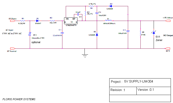

Please also find the 5V PSU I designed attached to this mail.

I am sure the 5V supply is fine. The problem is your 3v supply is not. You will need to play games to get your 3v supply clean, best thing is a regulator. If your 5v sags or surges when the relay energizes, this sag or surge will be on your MCU supply.
Maybe you can play with many cap values on the relay + pin plus +5v but this is just a band aid, best thing is like I said.
It is common practice to isolate digital supplies and analog supplies for this very reason. Your diode scheme offers little to no isolation of power supply noise.
Good luck
I really don't know why you are firm on using a non isolated power of 5V direct from230V /110V AC.
In fact even if you use any cellphone adopter, you get a good isolated power and these adopters are now a days very cheap. Use a resistor and 3.3V zener with a 1uF cap to get your 3V supply instead of three diodes. Always ensure that 0.1 is just across pins 5and 14 not far away to either of the pins.

I think cell phone adapters use some kind of similar ckt I used for 5V,and it is unisolated.Please correct me if i am wrong.
