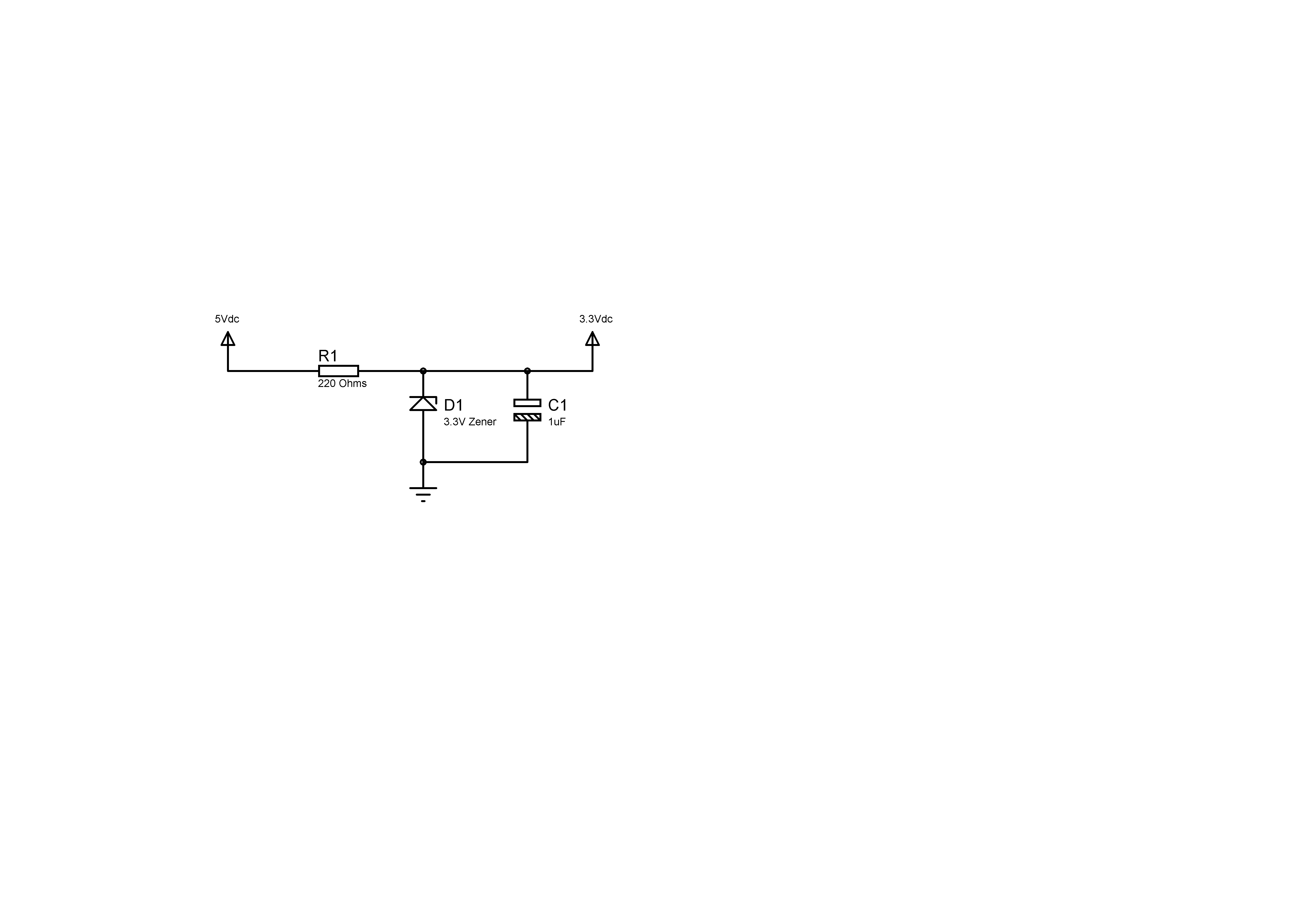

You have proved that running seperate supplies solves your problem, so it would then make sense that you know where your trouble is. Zener diodes do not make good regulators, Perhaps if you had a myriad of capacitors on your zener you may solve your woes. A regulator will eliminate all your problems I think. Yes LDO is expensive, but how much is your time worth?
You didn't just swap the diodes for the zener did you? Cause it's not going to regulate properly setup like that.
Oh no ;)
5V __/\/\/\/\____________ 3.3V
--- GND
theres also a capacitor acros the zener
(the zenere is after the resistor)
Sorry abicash, I can't read that =)
ick, eek, ack, gadzooks. I told ya how to solve your problem, if you want to try a cheap way out, then I give up...

After adding an LDO...the problems didn't seem to go away so I played around with the RC snubber across the relay contact (that seemed to be the problem)
I found that a larger time constant supresses noise substantially on the neutral path...
I have reached a value of 680ohms/3W and 2 capacitors effectively 66pf/630V at which theres NO problem at all..
Well, congrats on fixing your problem. I suspect you had a few problems, and you fixed them both. A good test would be to keep your current configuration and revert back to the diode regulator, if that works then you can yell at me for getting you to fork over the cash for an LDO...
:p Currently I am using the Zener Diode after testing it with the LDO and am happy with that..
