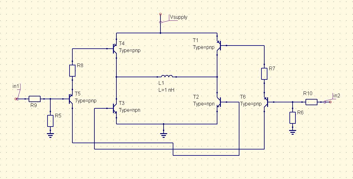

I looked over this design, are you seeing any problem with it?
Yes, there is a problem. You need more than 3.8V at the base of T6 to turn T1 off. 5V minus the BE voltages of T1 and T6 equals 3.8 volts. Your 3.3 volt input isn't going to get you that.
Can you use diodes or more of the same transistors. I don't know what the constraints are what parts you have to work with.

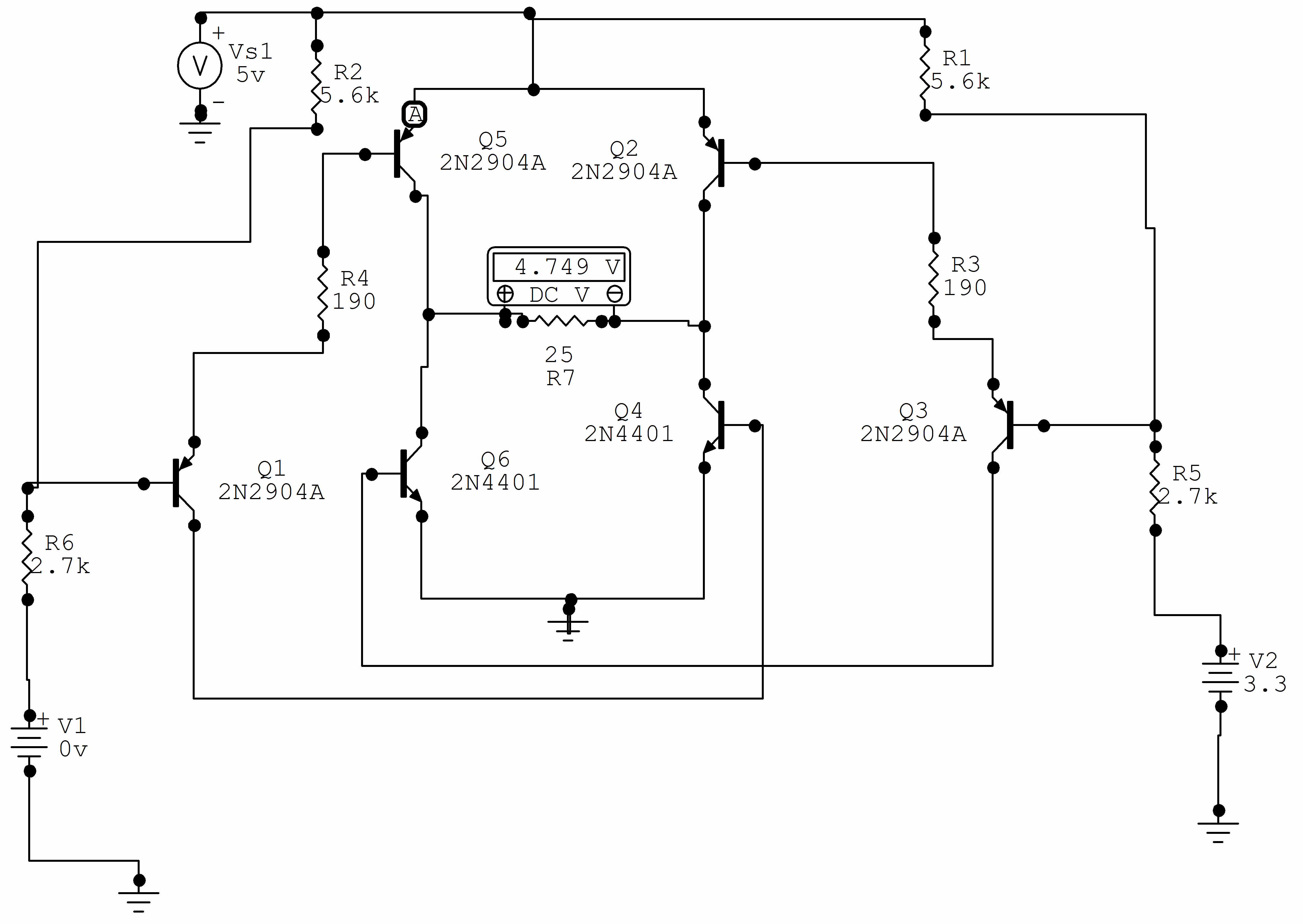

Using the same number and type of components as in your latest design, the attached circuit will work. You should optimize the resistor values for the greatest margin and performance with your transistors.
The circuit is very similar to the Collin55 motor circuit with a few tweaks for two inputs instead of one so you can turn all transistors off.

Before we go to the next level (adding parts which make the design to cost more - we wanna go for mass prodution), i really want to understand what is wrong with this design, why the relay's voltage wasn't around 5V, and why was the stand-by current 50mA and not less?
To turn a PNP off, the base voltage needs to be at least as positive as the emitter. You only have 3.3V on the base of Q4, while the emitter is at 5V. Under this condition, Q2 and Q4 will both be on, and Q4 will most likely will die due to excess power dissipation. In your simulation, try probing the currents in Q2 and Q4.
The collector of Q3 should be near +5V. I don't understand why it is at 582.4mV.
Thank you so much!
I simulated your design now, and received (with BSR14 NPN, and BSR15 PNP) V_Relay = 4.883V and I_Relay = 188.7mA (0.89W) which is great.
