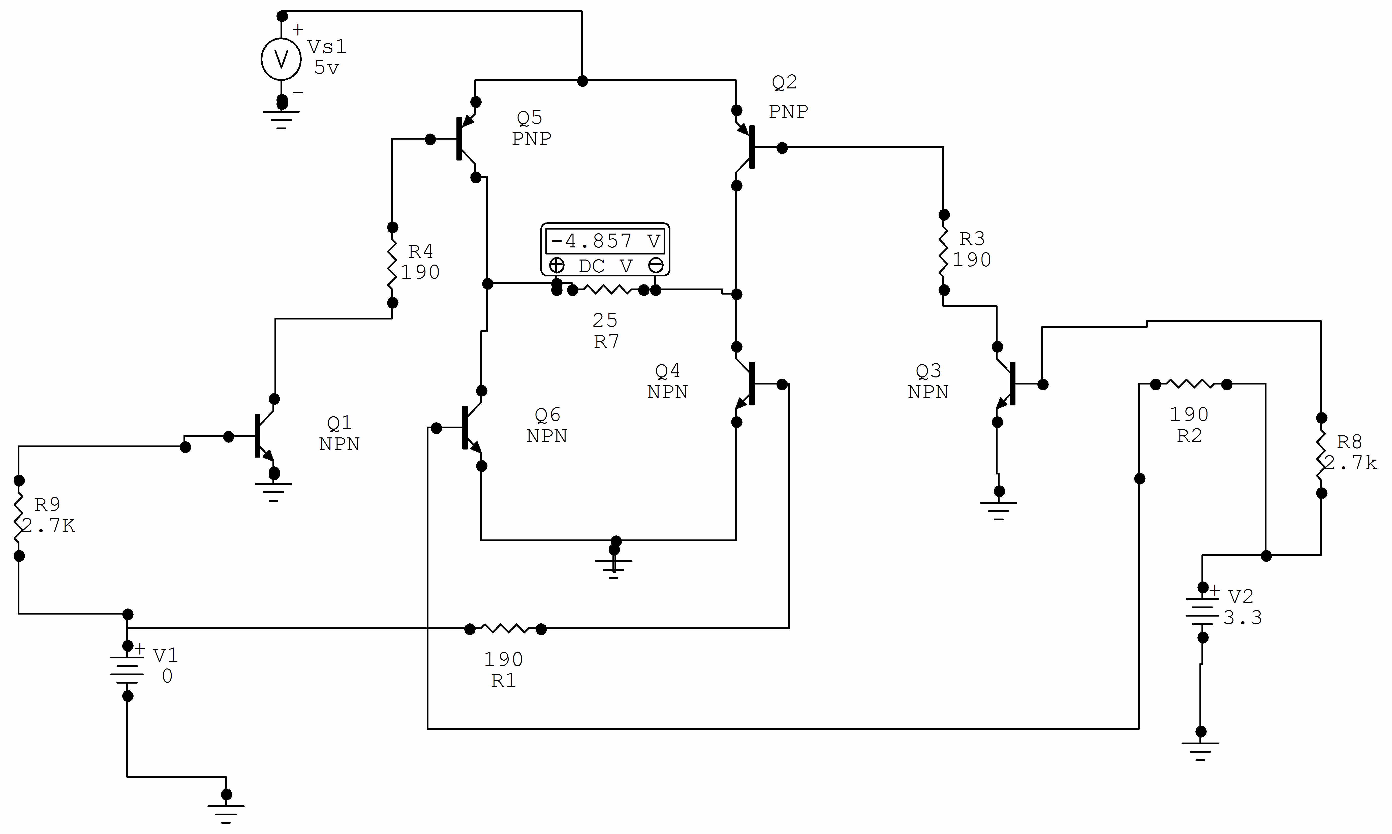

Alphadog, see the attached. It will not harm your I/O. In sleep mode your I/O retains the mode and state that is set before entering sleep mode. At power-up, your I/O is set to input mode with no pull-ups, so all bridge transistors will be off. You should put reversed biased diodes across each of the four transistors to protect the transistors against counter-EMF from the relay coil when it is turned off.

I simulated your circuit with QBSR14 (NPN) and QBSR15 (PNP) and received I_RELAY = 5mA.

Your simulation results are not the same as mine. Check that your bridge transistors have a gain (hfe) of at least 20 at collector curent of 200 mA, preferably more.
Yeah, but it's about .3 volts (max) at 200 mA, less typically. Still can't vouch for simulator's accuracy, though. Lots of pitfalls with simulators.

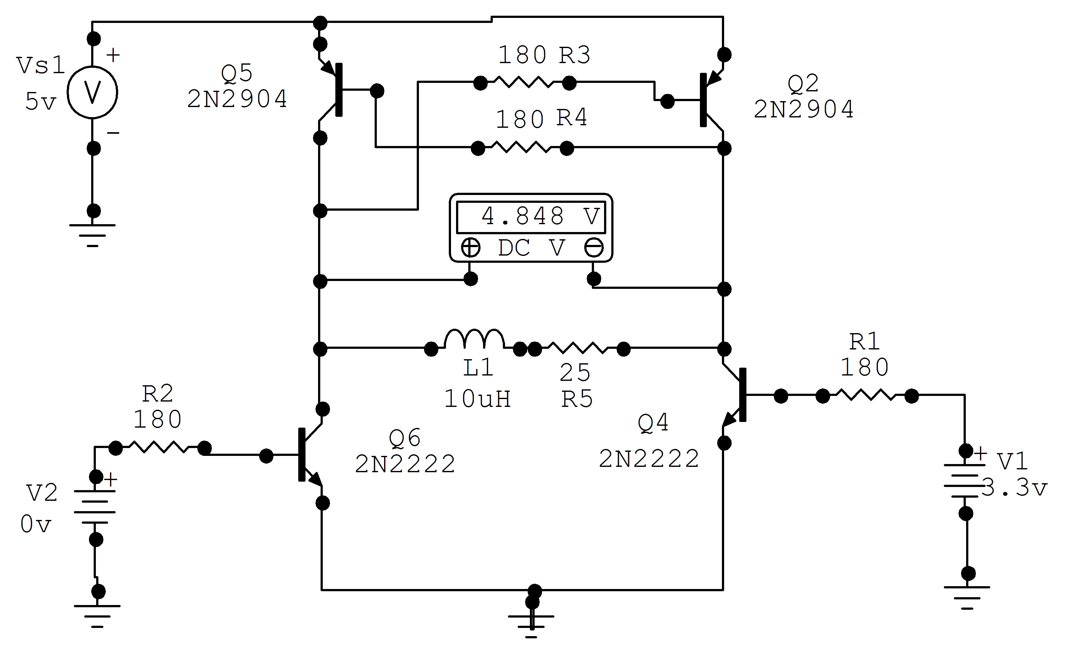

The simpler circuit (presented above) will need base resistors on the PNP transistors to keep them turned off as the bases are floating at the moment (say 4k7 from base to positive).
The 10uH choke will not be needed as this value will not have any effect in this situation. The 25R (27R) resistor will reduce the back emf from the (relay) coil.
The transistors may have to be up-rated to take the current.
One of the best transistors is ZTX851. (NPN) It is rated a 5A but at 2A the collector-emitter voltage is 150mV.
You will need to search the web for an equivalent PNP. This means the minimum loss will be 300mV.
