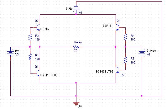

I built the presented circuit today for switching a single coil latching relay (1W, 5V rated):
I managed to switch the relay by changing the states of V2 and V3 - 0V and 3.3V states.
In switching mode (meaning V2 equals 3.3V, V3 equals 0v), the current that flowed from the 5V PSU was 250mA continuous, but the voltage drop on the relay was less than 1V.
I must say that I measured the relay's voltage after the switching of the relay and not during the switching.
There are two things that i dont understand:
1. The relay must consume at least 75% of 5V in order to change its state, how come that its coil's voltage (that shouldn't change after switching) was less than 1V?
2. Another problem that occured was that when both inputs V1,V2 were 0V, the current from the 5V PSU was 50mA.
It means that the current were flowing from the PNP collector to the base?
Should it happen?
Thank you very much for any help.

Seems like Q3 and Q4 are upside-down. The emitters should be connected to V1, not the collectors.
ken
All the emitters should point to GND.
V2 needs to be higher, try 5V. Also the transistors will drop 0.7V Use Logic level P & N channel MOSFETs if you can't afford the 1.4V loss.

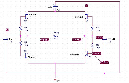

Yes, i'm sorry, i didnt sketch it right,
Here it is:

Hey, Thanks for the help.
Here are my answers to you:
1.
I cant use higher V2,V3 inputs, because these are provided by MCU, which have only 3.3V GPIO pins.
2.
The place where i work has made recently an order, so i cant for now ask to order the TL4427.
3.
Why is the VCE of the trasistors will be 0.7V? I read in datasheet that its max VCE is 0.4V.
I would appreciate it if you could answer the 2 question i wrote in the post, now that i corrected the sketch.
Thank you very much.

Before we go to the next level (adding parts which make the design to cost more - we wanna go for mass prodution), i really want to understand what is wrong with this design, why the relay's voltage wasn't around 5V, and why was the stand-by current 50mA and not less?

The answers to your questions:
Your circuit will not work.
To turn off Q3 and Q4, the input voltage must rise higher than 3.3v - it must be higher than 4.5v.
You circuit draws current via the 190R resistors on each leg, via the base-emitter junctions of the transistors.
You need to see the principles of my circuit, posted above.
My circuit needs 220R (or higher) current-limiting resistors on the bases of Q6 and Q8 for a 5v supply.

Did you turn your PNP transistors over? To turn the PNP transistors OFF, you need to drive their bases higher than V1-Vbe...+5V-0.6V...~+4.5V. +3.3V will turn the NPN transistors ON, but not turn the PNP's OFF. You need to do that the get 5V across the coil.
