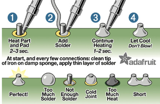

Most of you solder joints have too much solder, and look like they could be cold (no connection).
You should be able to see the outline of the wire being soldered.
This is how to make a proper joint. and how it should look:
This is also worth bearing in mind. I'll print this one out and paste to the wall in full view.
