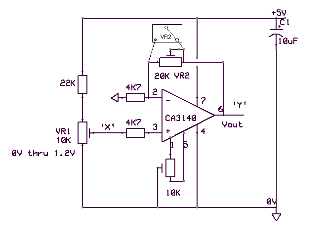

I would recommend that you build the CA3140 amplifier, this will increase the voltage that is output from the AD736.
You can use your dc meter to check the output.
Use a pot about 10k or 20K as a test input source for the amplifier.
I'll attach a sketch.

If I am reading your post correctly, you are saying you havn't adjusted the 20K pot.???
You need to turn the pot to give a 'X' point voltage of 1Volt [use a small screwdriver]
Once you have set 'X' at 1V then adjust the gain pot to give +3V on the output of the CA3140 'Y'.
Read the instruction notes on the drawing.
The term 'SET' means adjust.
Do you follow.?

The 1.08V on VR1 is OK for the present.
The VR2 pot is not shorted.
You should be able to set the VR2 gain pot from 1 thru times 4
So the output pin should read from about 1V thru 4V as you adjust VR2.
It sounds as though you have got a wiring error.
Post a picture on how you have it wired.:)

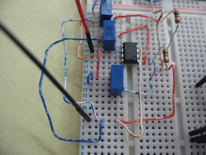

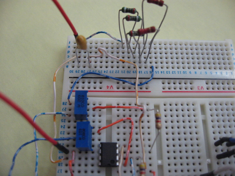

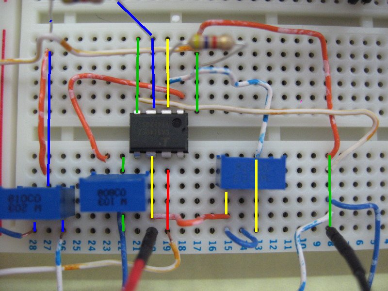

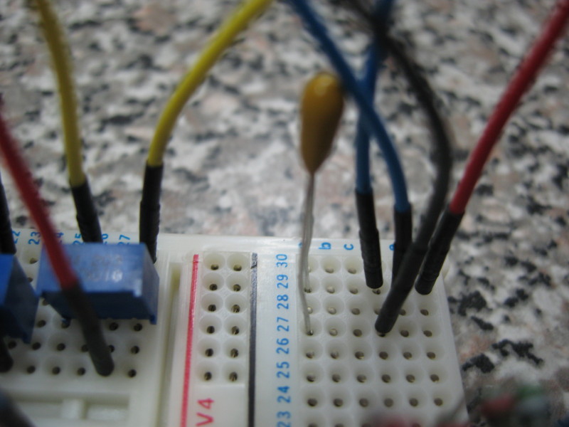

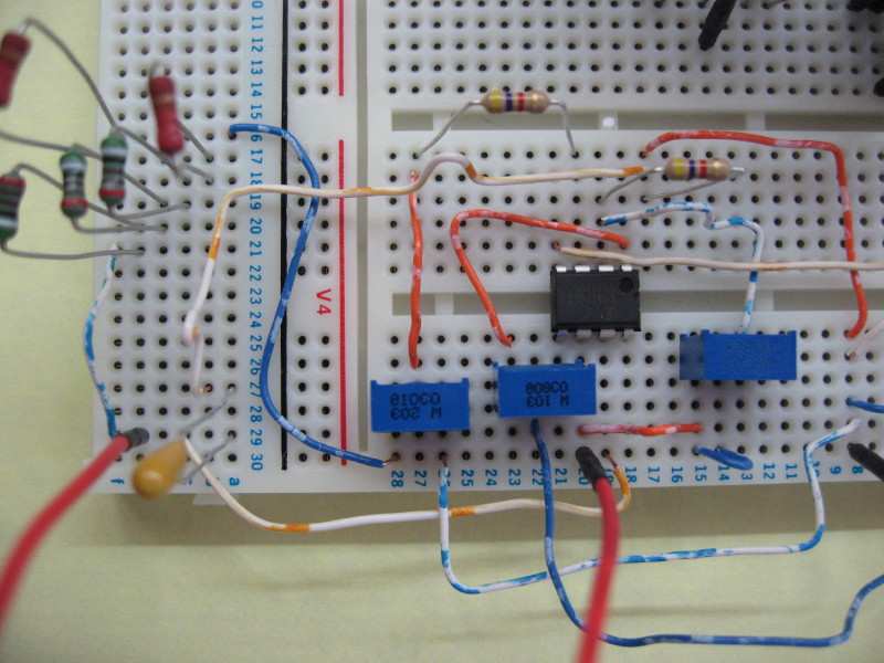

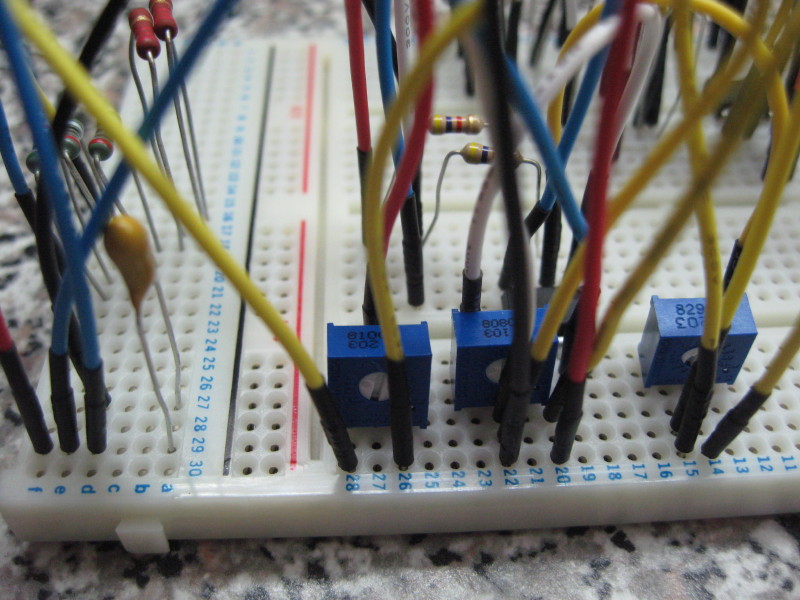

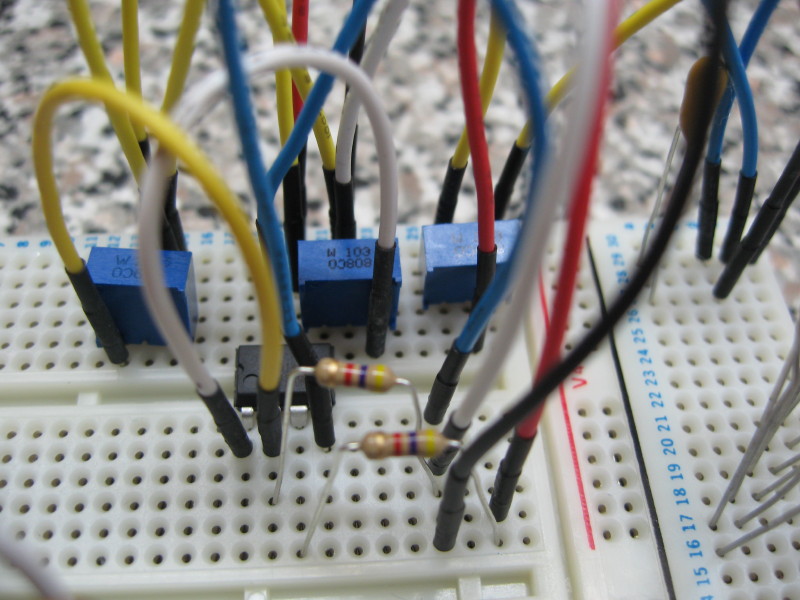

Here are the pics.
If anything is not clear or would like a different view please let me know.
Thanks.

I think I need some time to digest these pics.!:eek:
Its like an aerial view of an Amazonion rain forest, I must go and sharpen my machete.:)
I'll be back.!
Sorry :eek:,
I was attempting to do it myself just for the fun of it, and I can imagine how difficult it is.
Maybe I will try a small video.:D

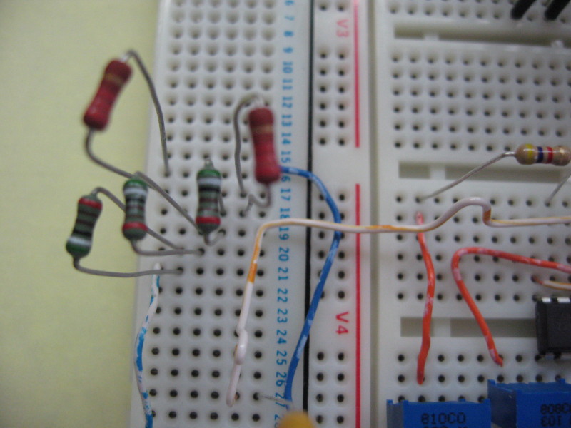

Looked thru the images, its almost impossible to make any sense of the layout.

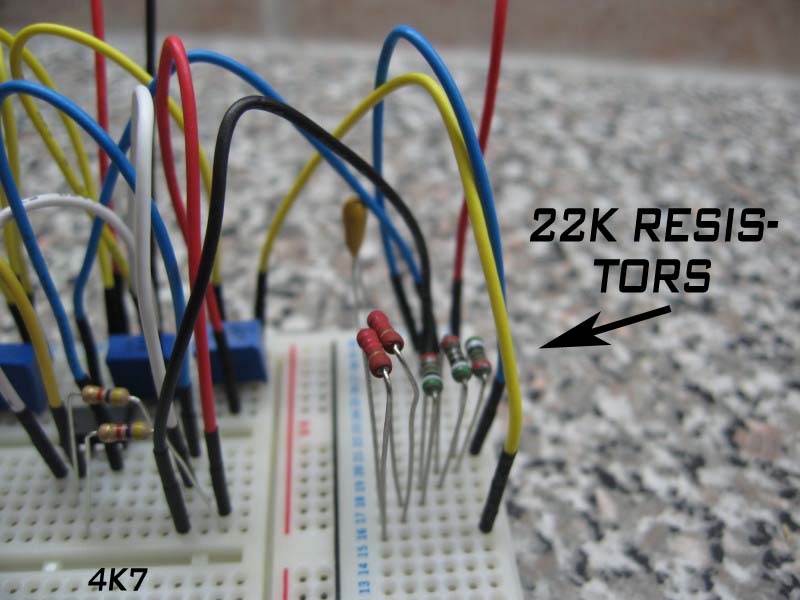

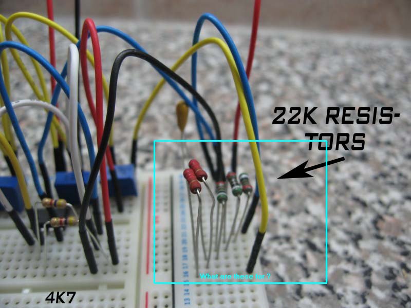

Whats this group of resistors for.? Ref this image.
Re layout the circuit using short pieces of wire. Old single strand phone cable is OK.
Where possible keep the layout something like the circuit diagram layout.
Those resistors are in series totaling 22k. the connection between +v and VR1.
I will also try to use phone cables, to make it more understandable.

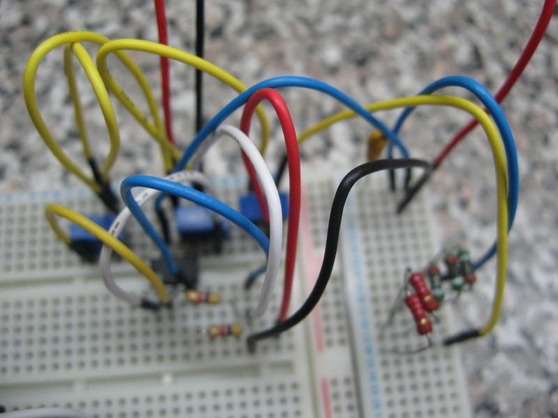

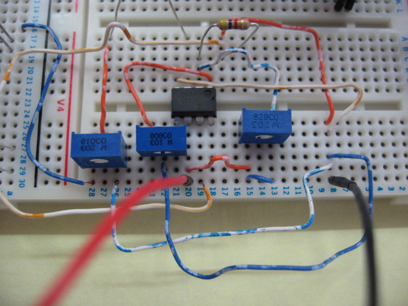

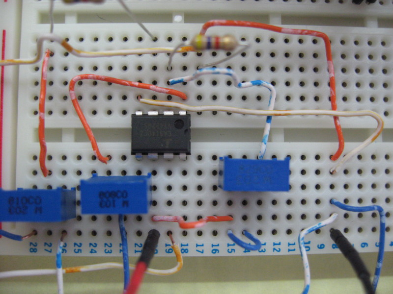

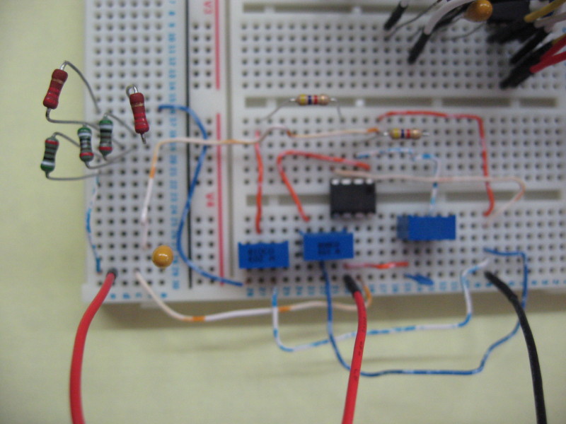

Here the updated pictures.
Wow what a difference.
I also was able to set the VR1 (20k pot) to produce 1.01 VDC.
The VR2 is producing 2.86-2.90VDC

As you say Wow.!:rolleyes:
I can now see the project board, give me a few minutes, I'll go thru them.
That looks OK to me.
For a test remove the 10K pot between pin 1 and 5 [ leave the wire links in place], leave it out for now.
I assume the the +V is 5Volts.
Try adjusting VR1 and measure the X and Y voltages, just do about 5 readings from say X = 0, 0.2, 0.5, 1.0, 1.5V
As close as you can get, its difficult with a single turn pot, lets know the Y voltages.
