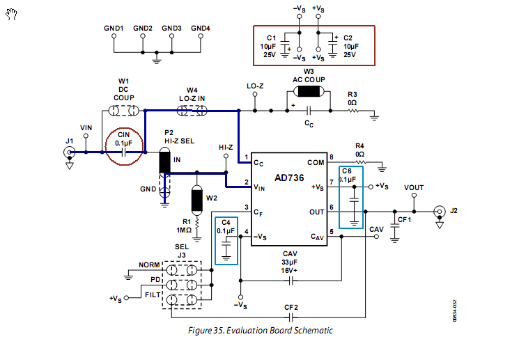

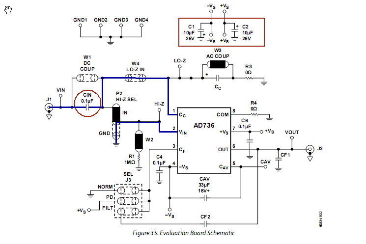

The 0.1uF is the input cap, see RED ring, the 10uF are decoupling caps, see RED rectangle.
The BLUE wires are the input you require.

This means that i am only missing the single capacitor unless I need to connect ground to pin4 in which case I will need another 0.1µf
Right thanks for that.
Pin 4 MUST go to a negative supply, about -3.4V
also its decoupled to 0V via a 0.1uF.
Eric,
I am really sorry about this, you must think I am an idiot or something.
What does the decoupling to 0v exactly means?
Its common practice to connect power supply lines to 0V via a low value capacitor. They reduce any electrical noise on the supply lines so that the ic dosn't malfunction. They also help reduce any noise the AD may make, that could cause problems elsewhere in the circuit.
Look at the LIGHT BLUE rectangles, these are decoupling.
NOTE: the caps 10uF in the RED rect are also power decoupling.
When you are testing it may be necessary to add some more conditioning to the signal, read up on the function of CF2 shown in the image.

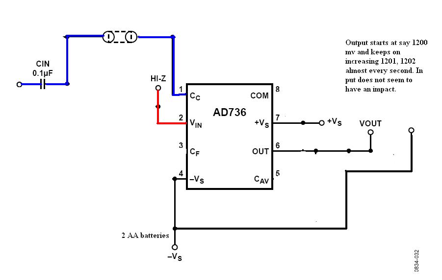

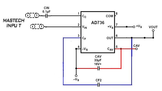

Just a quick update:
I got the kit and connected as in the diagram but I do not seem to be getting anywhere.
Any advice on what I am missing is very much appreciated.
I now have the Mastech MS3302:
Thanks.
Another question: How do I measure the output? at the moment I am connecting my multimeter to the output and to the -v supply to the chip.
Is this correct?
With regards to the image posted:
Pin 1 & 2 are connecting to my Ac current transducer.
Pin 4 to my battery negative & Pin 7 to positive battery (2 AA @ 1.5V each).
Pin 6 is my expected output which i am measuring as stated above.
Now for the blue and red line do I need those connected too?
I am trying to get 0-3V output that represents my transducer current readings.
If I need the blue and red line what should the capacitor size be at CF2 and with regards to the 33µF on the red line what does the 16V+ mean.
Any helpful feedback on this are much appreciated.
Thanks a lot.

I have looked thru the meter spec.
Are you getting the 'ac' output voltages you expect from the clamp ammeter.?
Hi Eric,
Thats a good question:
My multimeter shows nothing on DC mv and if I switch over to AC I do not see anything either but I Assumed it was becuase it is not sensitive enough to pick AC at such low voltage.
I tried the Ohms and I can see a change when I put load on the live wire, so I assumed a signal must be comming through.
If you have any suggestions I will be heading off to Maplins in the next couple of hours..
Thanks a lot.
Thanks a lot.
Whats the lowest range on your ac DMM.?
EDIT: the most sensitive range is the 1mV/0.1Aac.
Does your clamp require that you clamp only one of the conductor pair.?
A 2KW electric fire or electric kettle would be a good load test.
The 2KW fire should give about 80mVac output.
