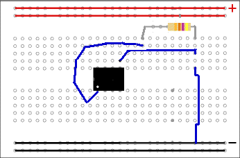

Why are you connecting pin 5 to pin 7 then through a resistor to the negative supply?
Power sensor signal conditioning

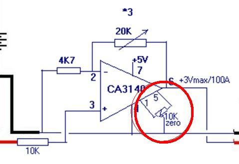

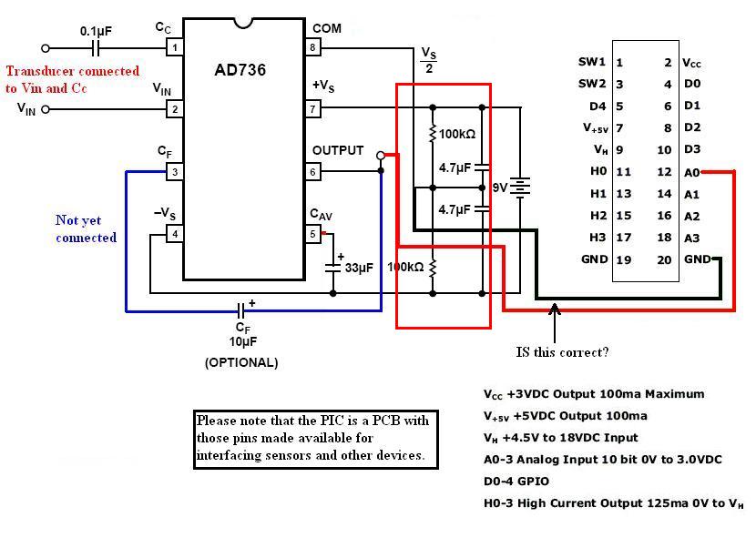

I am trying to replicate what circled in red in the image. I think I got it wrong somehow. Maybe it should be as in the updated image.

The schematic has a 10k pot between pin 1 and pin 5 with the slider of the pot connected to the negative supply.
You have a 10k (or 1k?) fixed resistor between pin 5 and pin 7 and pin 5 is connected to the negative supply.

I am also a bit worried about the connection highlight in red in the circuit image.
A breadboard drawing of how they should be connected will be nice.

You don't understand what is a potentiometer. Look it up in Google.
You show a precision trimpot with a screw that turns 10 times or 22 times around. You cannot see where it is adjusted.
I show less expensive but good quality trim pots with an adjustment of about 300 degrees so you can see where it is adjusted.
The middle pin is the slider. Your circuit has an ordinary resistor that does not have a slider.

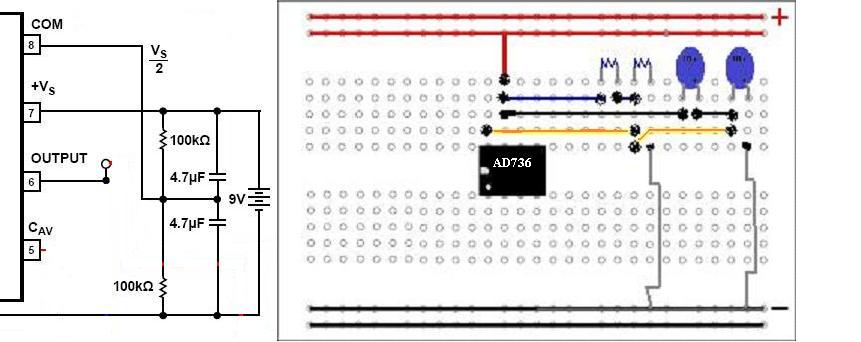

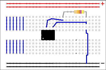

Here is an updated drawing.

Good. The offset adjust trimpot is connected correctly.
Thanks.
What about this drawing are they equal?
As pointed out by agu,the 10uF are reversed, if you apply 9V to the board they could explode.

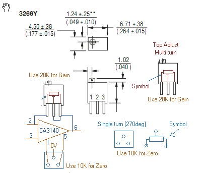

Dont buy those pot types, Ill post a sketch later[ bit busy at the moment]
showing the pots more clearly.
Look at this sketch showing the pots.
Also study the links.

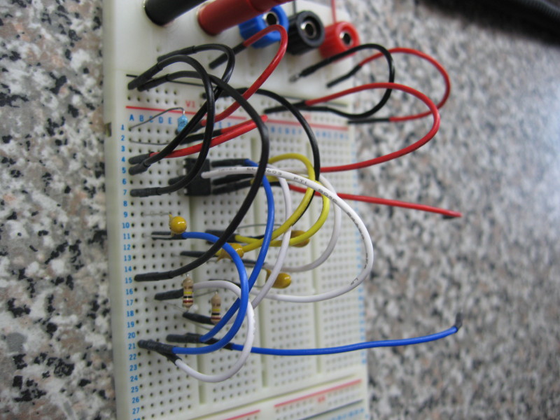

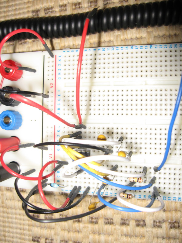

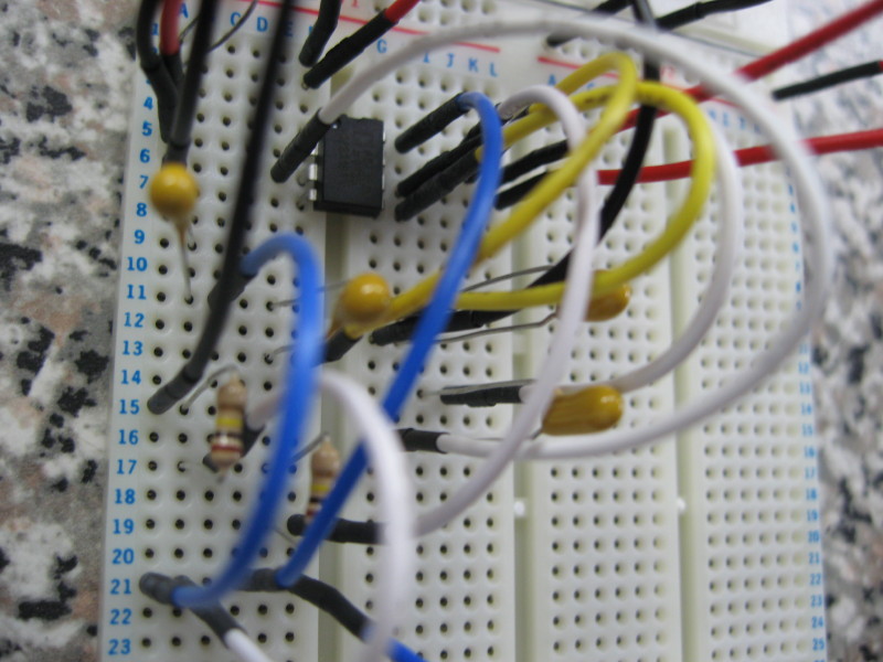

I thought this was a test for me ;) :D

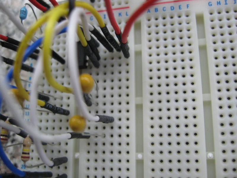

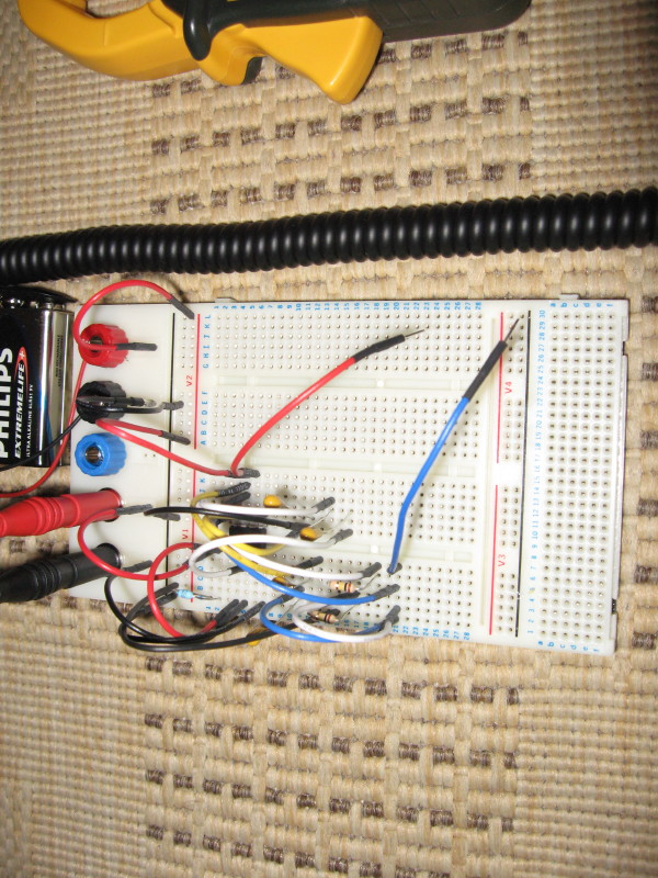

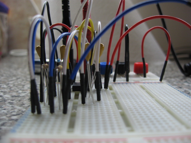

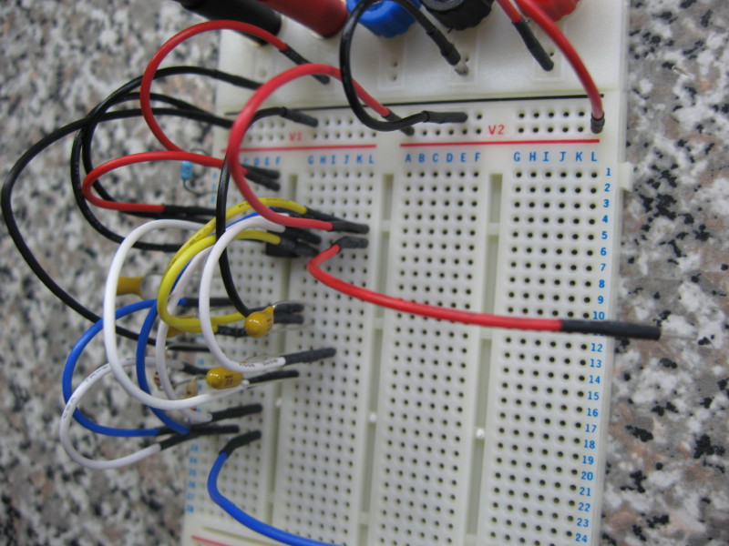

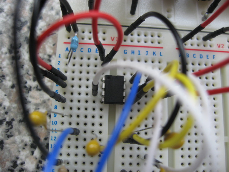

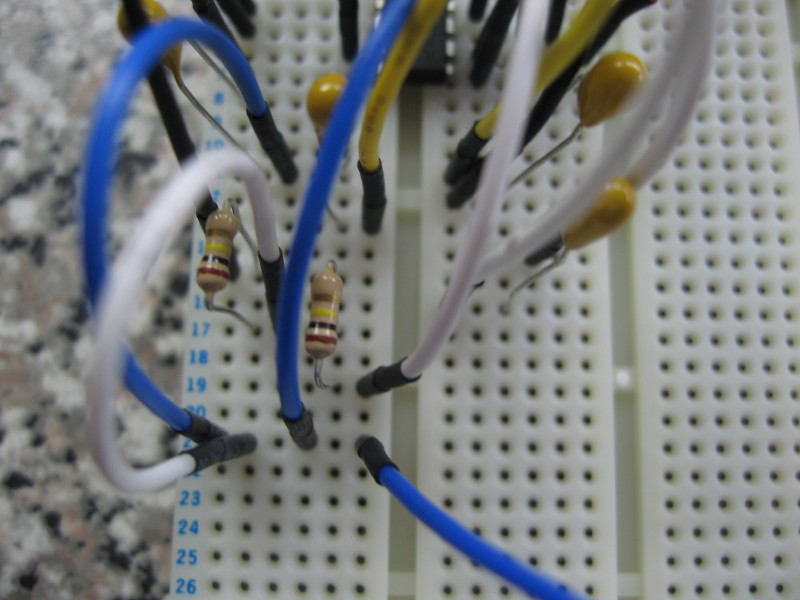

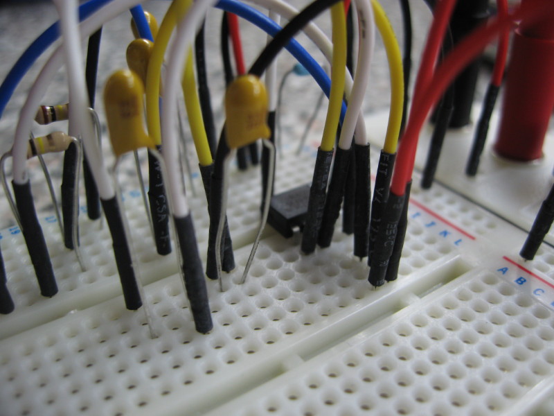

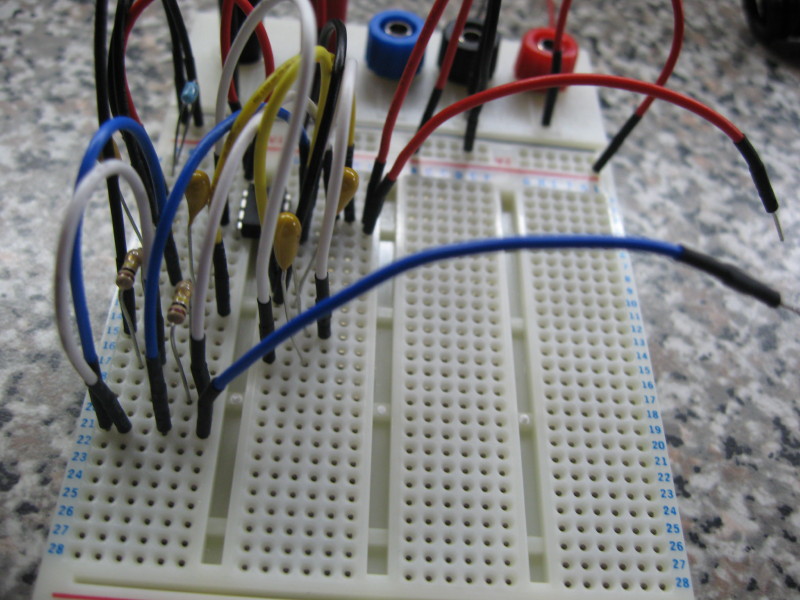

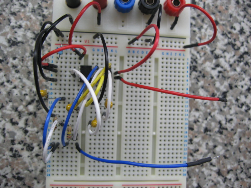

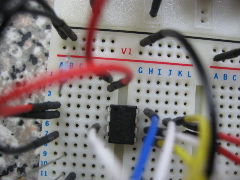

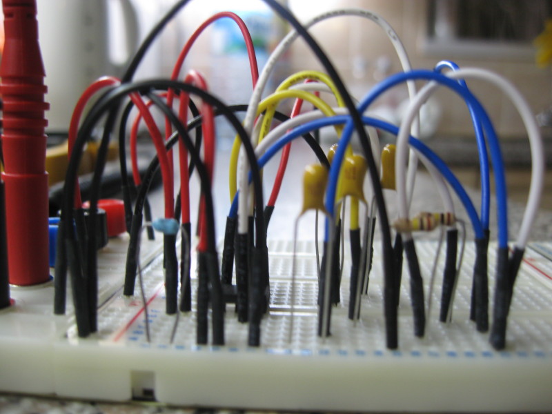

Anyway here are the pictures of what I have and this is without the amplifier.
I hope they are clear enough.
Well spotted.! For 7 read 6. Pin 7 is of course +5V.

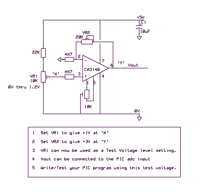

Looked at the pics.
Remember you are working with millivolt level ac signals.
You must keep the interconnecting wires as short as 'reasonable' else you will pick up mains em radiation which will give reading errors.
I would recommend that you build the CA3140 amplifier, this will increase the voltage that is output from the AD736.
You can use your dc meter to check the output.
Use a pot about 10k or 20K as a test input source for the amplifier.
I'll attach a sketch.

The connector wires are 7CM in length.
I do get quiet a bit of em radiation, and now that I have my (better) multimeter I can test the AC output at millivolts.
Once I am done with the proof of concept/prototype on the breadboard I want to see if I can get a PCB printed.
I did some background research and it seems simple enough to do with a laser printer (at least with the kits available from Maplin).
Only thing that I know I will struggle with is the actual drawing of the PCB.
I am at the moment waiting for the CA3140 to arrive.
