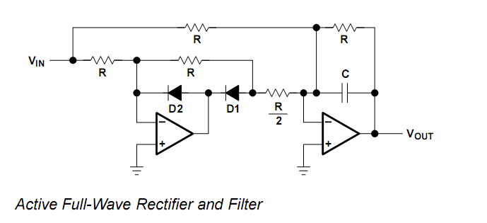

hi,:)
The current transformer will output 'ac', you need to use a precision rectifier to convert the 'ac' signal to 'dc', then smooth this dc before its sampled by the adc.
Do you follow OK.?
EDIT: like this.

Thanks for the quick response Eric.
From the readings I did notice it was fluctuating which meant it was AC.
So will need to convert to DC and then condition the signal.
In this case i will need to devices connected right?
In simple english :) what are they called and where can I buy them from and are there different models/capabilites etc...
Many thanks again

hi,:)
Do you follow OK.?
EDIT: like this.
Here is one link, it has values and notes
also these 2 pdf's should help.

Look at these, AD736 links.

The only difference between the two versions is one is surface mount and the other is DIP.
I would suggest a DIP version as you are experimenting, it will plug into your project board.
Read and understand the AD736 datasheet.:)
Get the ic working in the project board, examine the output from the AD736 then decide if extra conditioning is required.
