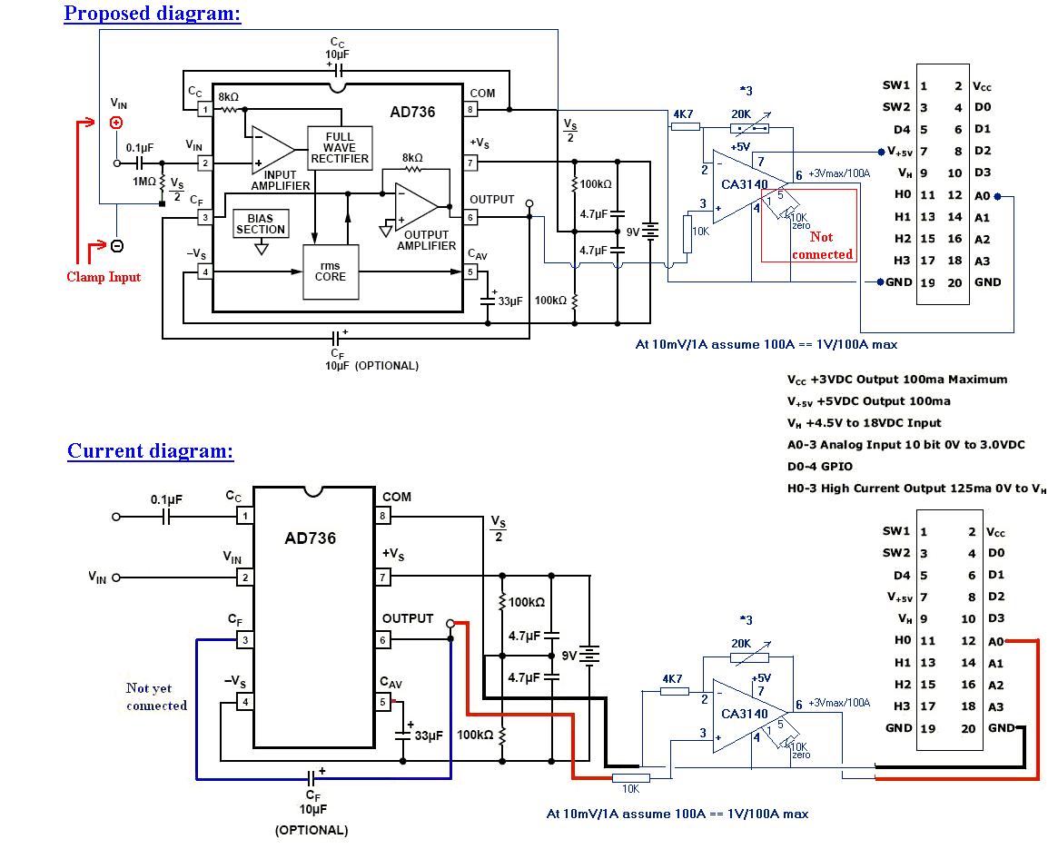

Post a circuit diagram of how you have the AD736 and CA3140 connected showing ALL the power supply lines.

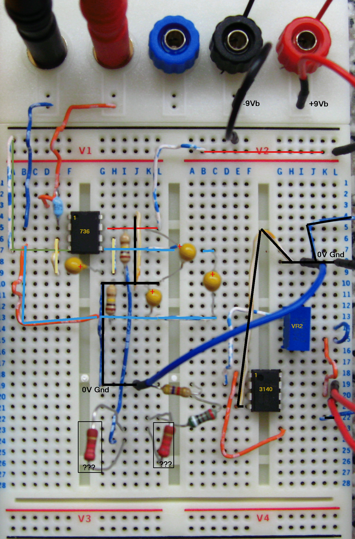

Here are a couple of high res pics.

Questions ref the HR pic.
Q1:
Are V1 and V2 board sockets connected or isolated from each other.?
IF they are isolated, then how does pin4 of the 736 get its 0v connection.?
Q2:
Fig28 of the data for the 736 shows pin1 has be connected to pin8 via a 10uF capacitor.
Its hard to be sure looking at the pic, but the cap maybe in pin1.?
BUT its going the clamp [red wire] output.
You are showing the other output from the clamp [blue wire] going to pin 2,
its supposed to goto the Vs/2 [junction of the two 100k's]
Q3:
Why are the resistors marked '????' in the circuit.?
If its because you dont have a 4K7, then the pin3 resistor value is not critical, just use one of those 3 resistors.
Q4: Looking at Fig28 of the 736 data, pin2 requires a 1M0 connected to pin8 [Vs/2]
also Vin [clamp red wire] to pin2 is via a 100nF cap.
I did ask for a circuit diagram not a picture, I have had to reverse 'engineer' the pic into a circuit.
Look at my marked up image, the lines are just my tracing guides.
BTW: I thought you had decided to use fig28 of the 736 datasheet for the circuit.

You cannot power the CA3140 from the 9Vbty thats powering the AD736
because you have a virtual 0V Gnd at the junction of the two 100K's
Q1:
The upper row is connected. The lower is not. The black line and red line indicate connection.
Q2:
The cap is in pin 1 connected to the clamp output. This does not match whats in Fig 28, it is more like figure 24. What intially i was going with Fig 24 however to get the battery power I used Fig 28, so I ended up with a combination, Fig 28 did not clealrly indicate where my other clamp output should go. Now it is clearer for me.
Q3:
The connection from from pin 6 (AD736 output) to CA3140 Pin 3 requiire a 10K Resistor, so the current ones total is 10k.
Check the attached new diagram. As opposed to the current one (same attached image).
My veroboard drawings and my previous diagrams macth my actual one. Only reason I chose to post the actual is just incase I made a mistake somewhere, and I think that paid off :D. Sorry for the hassle though. :eek:
Originally it was not the intention however when it came to battery power I had to go down the Fig28 route. All my drawing show my connections as is and since I got no comment I assumed they were ok :confused: .
The calculation for the 10 bit conversion is fairly simple.
Adc Value = [Vsig/Vref]/1023
Thanks. for the formula.
Its a split battery.
Ok thanks.

The proposed layout is the way that I would do it.:)
Lets know how it goes.
Will do this evening :)
